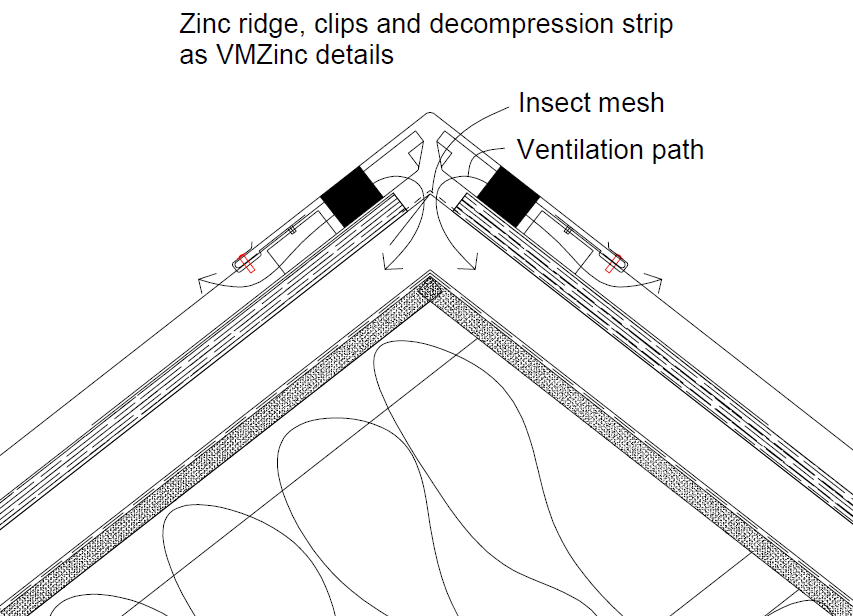

andy Posted May 12, 2021 Posted May 12, 2021 I have an anthracite zinc standing seam roof (so black, gets hot as hell) and the build up from outside is zinc, underlay stainless steel clout nailed to 18mm plywood, 50mm battens open to eaves and venting at apex, fibreboard nailed to i-beams with 350mm of warmcell followed by 12.5mm foil-backed plasterboard and then plastered (not sprayed). This includes vaulted spaces and whilst we had a slight crack on the ends going towards ridge beam, I chipped it out and easifilled it to repair and painted and there's zero movement to date and no cracks. As others have said, sounds to me like a lack of (required) ventilation void and glass fibre is no substitue for PIR alas... get it rebuilt to spec.

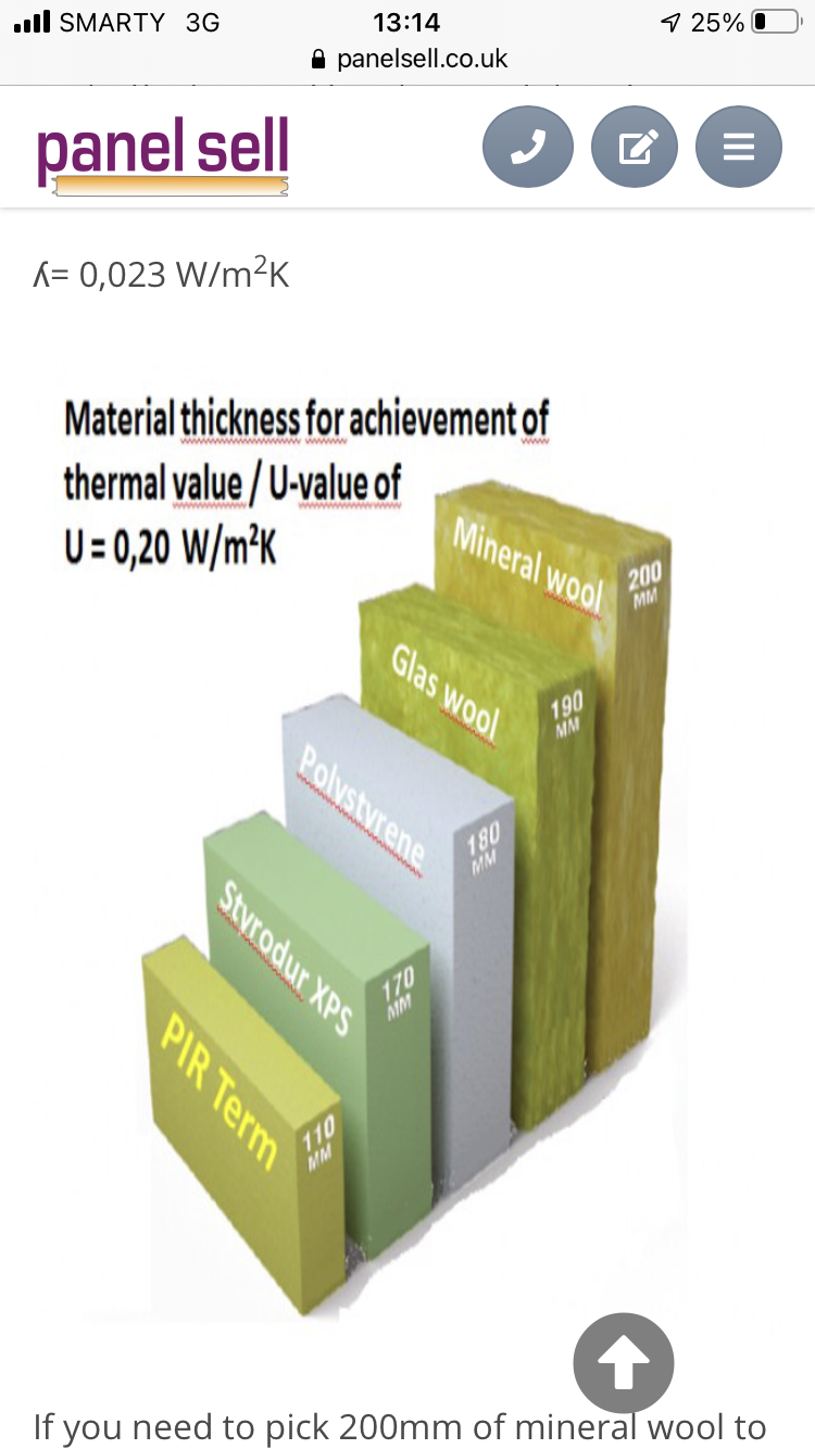

GaryM Posted May 13, 2021 Author Posted May 13, 2021 Just an update: I've spoken to Architect: he is not that concern about the use for glass wool, he says it should still leave a good 100mm get for ventilation. The Glass Wool used had a better insulation properties 0.044w/mk which is the same as the solid PIR I believe.
joe90 Posted May 13, 2021 Posted May 13, 2021 (edited) 23 hours ago, GaryM said: Posi beams with 250mm glass fibre insulation 18 hours ago, GaryM said: architects spec that I noticed he had specified 210mm PIR frankly that does not add up in my mind. PIR is roughly twice as good as glass insulation but glass insulation fitted is only 40mm more than PIR!!! 1 hour ago, GaryM said: The Glass Wool used had a better insulation properties 0.044w/mk which is the same as the solid PIR would be good to see some figures on that assumption? edit.... even if it was correct it does not work, excess heat is transferring to the plasterboard. That’s why you paid a professional, to get it right!!,! ?♂️ Edited May 13, 2021 by joe90
PeterW Posted May 13, 2021 Posted May 13, 2021 2 hours ago, GaryM said: The Glass Wool used had a better insulation properties 0.044w/mk which is the same as the solid PIR I believe. That isn’t correct PIR is 0.022-0.025w/mK, glass wool is 0.035-0.045w/mK If you remember that uValues are calculated using the inverse (i.e. 1/uValue) then glass wool is half as efficient as PIR. 19 hours ago, GaryM said: but he just fitted the membrane and metal, that was before all the fibre was fitted. So I expect that the builder has stuffed the insulation up under the OSB which will have removed any ventilation and you have condensation issues. The moisture from the drying plaster will have also gone upward and condensed on the OSB - do you know what membrane was used ..?
GaryM Posted May 13, 2021 Author Posted May 13, 2021 4 hours ago, PeterW said: That isn’t correct PIR is 0.022-0.025w/mK, glass wool is 0.035-0.045w/mK If you remember that uValues are calculated using the inverse (i.e. 1/uValue) then glass wool is half as efficient as PIR. So I expect that the builder has stuffed the insulation up under the OSB which will have removed any ventilation and you have condensation issues. The moisture from the drying plaster will have also gone upward and condensed on the OSB - do you know what membrane was used ..? Ok I will double check the insulation values, I'm sure the glass wool I looked at was the same as the solid, but I will check. I don't know the membrane of the top of my head. I am pretty confident the builder has not stuffed it up willy nillly, I saw them do a lot of it and they did take care and afterwards it was laying very even
GaryM Posted May 13, 2021 Author Posted May 13, 2021 5 hours ago, joe90 said: frankly that does not add up in my mind. PIR is roughly twice as good as glass insulation but glass insulation fitted is only 40mm more than PIR!!! would be good to see some figures on that assumption? edit.... even if it was correct it does not work, excess heat is transferring to the plasterboard. That’s why you paid a professional, to get it right!!,! ?♂️ Thanks for the reply. I'm rechecking the numbers and the architect is as well, we also have SAP calcs to refer to. Note: at the moment we are assuming it is drying out to quickly, it seems the most logical reason

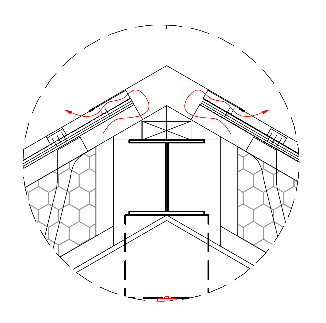

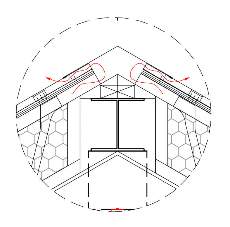

andy Posted May 13, 2021 Posted May 13, 2021 Do you have a cross sectional drawing of your build up like this? Where the arrows drop down is the cold roof 50mm ventilation space with battens running vertically to allow air flow.
GaryM Posted May 13, 2021 Author Posted May 13, 2021 7 hours ago, GaryM said: Just an update: I've spoken to Architect: he is not that concern about the use for glass wool, he says it should still leave a good 100mm get for ventilation. The Glass Wool used had a better insulation properties 0.044w/mk which is the same as the solid PIR I believe. I now realise the above is rubbish and we have half the specified insulation in there.
GaryM Posted May 13, 2021 Author Posted May 13, 2021 (edited) 9 minutes ago, andy said: Do you have a cross sectional drawing of your build up like this? Where the arrows drop down is the cold roof 50mm ventilation space with battens running vertically to allow air flow. Thanks for the reply Andy, Yes we do, i think the difference is yours looks like doubled boarded and battened, is that right Edited May 13, 2021 by GaryM correction of information
andy Posted May 13, 2021 Posted May 13, 2021 10 minutes ago, GaryM said: Thanks for the reply Andy, Yes we do, i think the difference is yours looks like doubled boarded and battened, is that right It has to be double boarded as far as I am aware. If you don't do that to allow the cold outside air to circulate between the board under you roof (18mm ply in my case) and the roof that containing your insulation (15mm DHF for me) it won't work. I could be wrong but am I seeing in your drawing that the airflow is moving in the same space as the insulation? If so, I cannot see that being correct.
