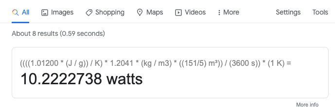

joth Posted May 11, 2021 Posted May 11, 2021 (edited) Recently moved into our renovated house, temperature is great everywhere, around 20ºC, except the master bedroom that sits at about 21-22ºC all day and shoots up to 23+ every night. I want to get ahead of this before the summer overheating risk really starts! Full build context below. Our goal would actually to be to keep it cooler than the rest of the house, e.g. 19ºC The bedroom + ensuite have a supply + extract duct so I was hoping these would make a balanced pair and not need much additional ventilation. Even if it's purge ventilated all day, as soon as we try and sleep. it rapidly overheats. Thanks to @SteamyTea I have the formula for the rate an MVHR can move energy: P = SHC x Mass Flow Rate x ∆T. SHC of air at 20ºC = 1.012 J/(g.K) Mass of air = 1.2041 (kg/m3) Flow rate of the entire house air supply = 151 m³/hour - Lets assume 1/5th of this can be sent to Master bedroom. (A bit optimistic as we have 7 supply vents, but, whatever). Plugging all this into a good old Google search box: So for every 1ºC of air temperature difference, the MVHR can remove 10 watts of heat generation per room. That seems far too low! Where have my calcs gone wrong? 2 adults sleeping will put out about 80W each (and a bit more after a couple glasses of wine). So the MVHR supply, at 30m³/h, needs to be 16ºC colder than target temperature to keep the temperature constant. That seems completely insane! Where have my calcs gone wrong?? Our poor Q350 still thinks we're in "winter heating season" so is recovering all the heat it can, pumping 20.5ºC air into the room. No wonder it overheats. Unless I can set a different supply temperature of flow rate for the bedroom vs every other room, it seems sure to overheat. OR I need to put the whole MVHR into bypass mode, and have every other room freeze overnight. OR I need to install a secondary ventilation system to circulate the air from this room to the rest of the house more actively. (Leaving the bedroom door open is not a preferred option, as we want to keep pets out, and also it opens to a hallway atrium with a too much glass that will let light into the room at 4am.) Does this reflect what other MVHR owners find? How do you manage this? Thanks for reading this far ? @Dan F may also be interested in this, as I know you are also planning an isolated supply/extract for bedroom+ensuite. Full build Context: 151m2 house, 2 occupants. Passive house enerphit standard (25kWh/m2/yr). Zehnder Q350 MVHR House is being maintained 20-21ºC via solar gains and (as needed) ASHP to ground floor UFH. Upstairs has no heating system. Master bedroom is on first floor, with rockwall beneath the floor boards. It has North-East aspect, so some morning light but little in the way of solar gains or other heat sources. not huge, about 30m³ volume but some of that taken with cupboards. The attached Ensuite has UFH mat, which just operates 1 hour each morning. Warm loft above it. Edited May 11, 2021 by joth Remove time from formula!
SteamyTea Posted May 11, 2021 Posted May 11, 2021 On 11/05/2021 at 11:12, joth said: P = SHC x Mass Flow Rate x Time x ∆T. Expand Think I typed E for energy, not P for power. Remove the time and you get power. (I think, out at moment so only half a brain on it)
joth Posted May 11, 2021 Author Posted May 11, 2021 On 11/05/2021 at 11:16, SteamyTea said: Think I typed E for energy, not P for power. Remove the time and you get power. (I think, out at moment so only half a brain on it) Expand Thanks! yes I removed the "multiply by time" from my own calcs (hence why the Google box resolved to W not J) but forgot to remove that term from the formula - fixed.

Bitpipe Posted May 12, 2021 Posted May 12, 2021 On 12/05/2021 at 08:48, joth said: My maths so far [which I still hope is wrong!] show that MVHR is only able to move energy at a fraction of the rate a human generates it, so is doomed to overheat without a designed in secondary pathway to carry energy away. Expand I don't think that's much of a surprise - the specific heat capacity of air is low so you need a lot of it moving from A to B to transfer meaningful heat (or cool). If you've ever been in an American home that uses central air heating, the ducts are huge and the flow rates considerable. MVHR is designed to ventilate, not heat or cool. It supplies/extracts air at a sufficient rate to keep rooms fresh and remove stale / damp air. It's normally barely noticeable unless in boost or purge mode. The heat recovery is transferring the majority of the heat in the extracted air to the incoming supply to avoid wastage. I would only expect MVHR to have a meaningful heating / cooling effect if the house had extremely high levels of insulation and airtightness - effectively acting as a trim function. I would focus on how the bedroom is heating up in the first place. What is its orientation? How big are the windows and are they shaded in the daytime? What's underneath it?
Temp Posted May 12, 2021 Posted May 12, 2021 On 11/05/2021 at 11:12, joth said: SHC of air at 20ºC = 1.012 J/(g.K) Mass of air = 1.2041 (kg/m3) Expand Perhaps I missed where you did the conversion but you need both in kg. Eg SHC of air is 1012 J/kg.k

joth Posted May 12, 2021 Author Posted May 12, 2021 On 12/05/2021 at 09:14, Temp said: Perhaps I missed where you did the conversion but you need both in kg. Eg SHC of air is 1012 J/kg.k Expand Thanks! The beauty of using the Google search box calculator is it automatically performs simple unit conversions like this (and verifies the resultant units are what you expect) Paste either these in a search box and you should see it work: 1.012 (J /g)/K * 1.2041 (kg/m3) * 151/5 m³/(3600s) * 1K 1012 (J /kg)/K * 1.2041 (kg/m3) * 151/5 m³/(3600s) * 1K

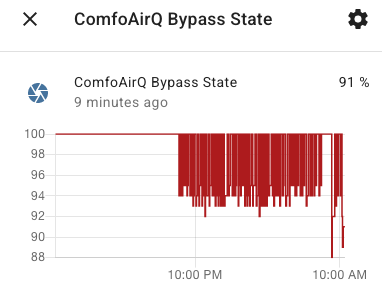

Dan F Posted May 12, 2021 Posted May 12, 2021 (edited) On 12/05/2021 at 16:12, joth said: Time for me to start designing secondary ventilation I think! We do have a fan coil in the loft, but issue is we need bedroom cooling even when the rest of the house is borderline needing heating on. It seems mad to enable active ASHP cooling during the heating season. (And, it's not that easy to do this dynamically with our heat pump). So need to figure another plan. Ideally I'd have a water to water heat pump that could cool upstairs while pumping the heat down into the the ground floor UFH Expand Can you do something to adjust the theshold at which the MVHR switches bypass mode on/off? The only downside of this is that in spring/summer when its still quite cool at night outside your ground floor rooms would cool down more than you'd like and might require heating in the morning that otherwise wouldn't be needed. Other option is to add some minimal MVHR cooling for first-floor only, which would mean you wouldn't need to turn on MHVR bypass when still cool/cold outside, but still be able to create enough temperature difference in MVHR supply air to get rid of the watts you emit overnight. It probably wouldn't need to run continuously but could come on occasionally based on room temperature. Edited May 12, 2021 by Dan F

joth Posted May 13, 2021 Author Posted May 13, 2021 On 12/05/2021 at 16:41, Dan F said: Can you do something to adjust the theshold at which the MVHR switches bypass mode on/off? The only downside of this is that in spring/summer when its still quite cool at night outside your ground floor rooms would cool down more than you'd like and might require heating in the morning that otherwise wouldn't be needed. Expand Yeah I've turned it from "Adaptive" to "Fixed" temperature profile, and *think* I've forced it into "summer" mode (it's rather ambiguous, as normally it won't start summer mode until mean outdoor temp hits 15ºC minimum, and we're still only at RMTO= 10ºC, but in the app there is a "start summer now" button I pressed, but it doesn't give much feedback it actually did anything when RMTO < 15) I then set the "Cool" temp profile to target 19ºC, and as it's always at about 21ºC indoors, this means it's pretty much always in 100% bypass mode, just adds in a little heat recovery overnight when the outside temp really drops Downside is we can regularly have >22ºC upstairs yet <20 downstairs, which together with the ground floor having a lot of porcelain flooring means there's still times the UFH might want to come on, but yet the MVHR is in bypass mode, which is obviously nuts for energy efficiency but we have to get the place comfortable before really starting to optimize this. But for all that, even with the supply temp now at 13ºC overnight and the bedroom supply vent opened right up, the room still rose from 21 to >23ºC last night, pretty much proving that it doesn't matter what we do with the MVHR temperature, it's the low flow rate that makes it insufficient for dealing with body heat. On 13/05/2021 at 07:54, tanneja said: Would installing a ceiling fan in the bedroom mean enough perceived cooling? Expand Yeah this is another avenue to look at, although it does feel a bit like failure to start down that path, I'll try that when other options are exhausted. On 13/05/2021 at 08:46, Bitpipe said: As heat rises with convection, I'd think that heating downstairs while cooling upstairs would be difficult to achieve. Expand Indeed. It was just aimless musing really, but the thought was an indoor to indoor heat pump that constantly collects the gathered heat from upstairs and relocates it back down into the ground floor slab.
