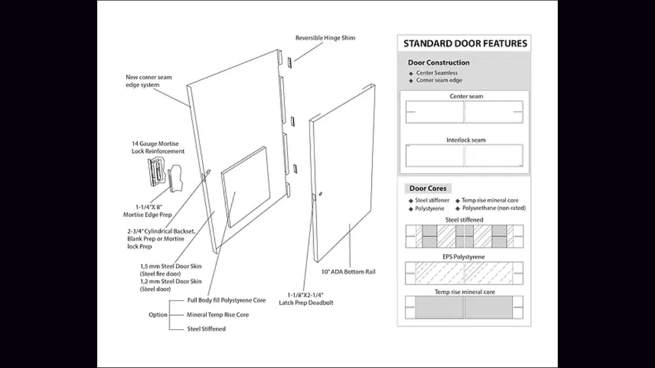

Onoff Posted May 11, 2021 Posted May 11, 2021 I can't help thinking...buy a commercial, metal door and repaint it! Meant to take photos at work of the edge/corner details but this might help. Ours are all interlock seamed:
