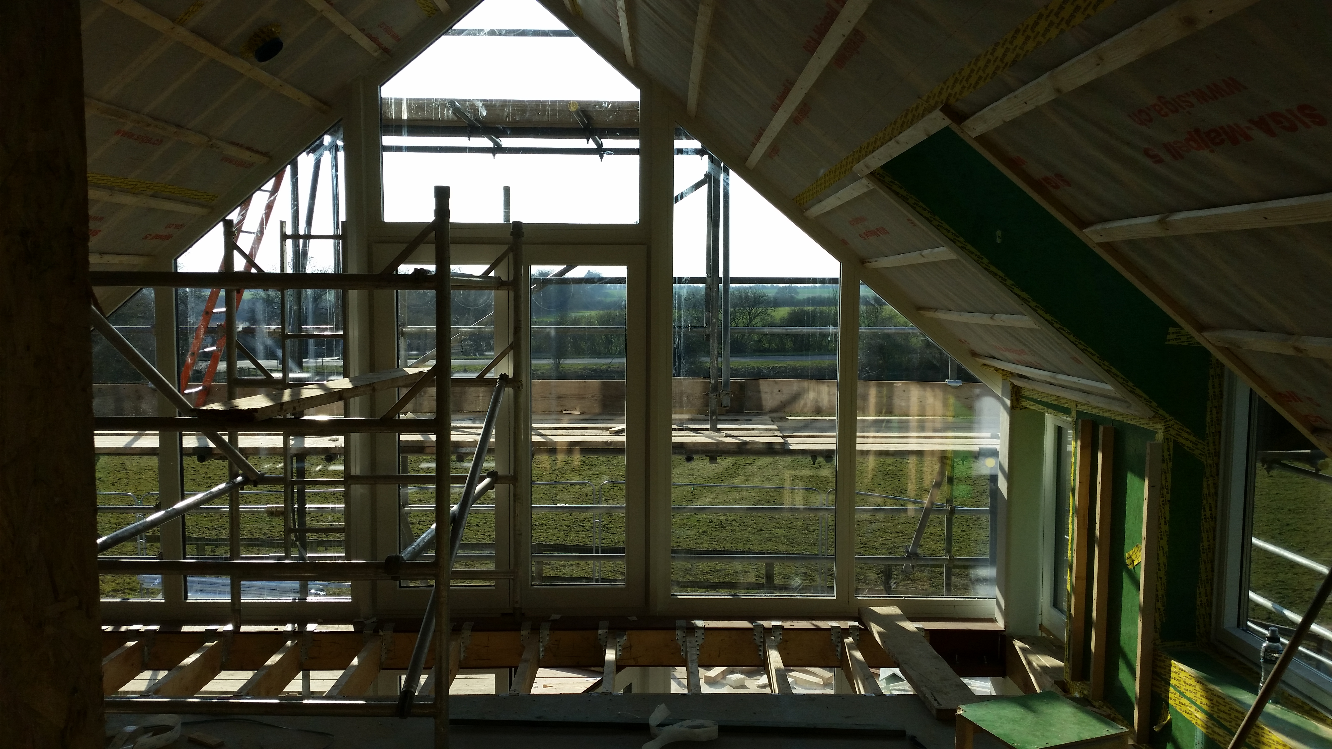

I'm struggling to get my head round MVHR duct routing where you've got a fully insulated vaulted ceiling, according to my drawings all I've got is a 22mm service void. I've got the same problem in two rooms which have flat roofs in a dormer.
How do I route the ducts? I really dont want some sort of ugly boxing. Or do I have to put them into the wall instead?

@Mikey_1980 put his in the inside the roof before mbc pumped the insulation. Ok you may loose a bit of the U value but with a vaulted space i will do the same
Edited by dogman
We have low walls in our vaulted rooms and so I just fitted the ducts and terminals in there, around 1.2m  above the floor.  In one bathroom I made a narrow ceiling so I could run the duct for it along there, and the duct for the adjacent bathroom, that comes out high on a dividing wall.
I planned this at the start and created a service void in the ceiling to take the ducts and down lights but you need about 100mm.  MBC had to do battens on top of battens as the cross batten idea only gives 50mm at the cross overs
If you are worried about loosing wall / roof U value then perhaps do as we have done in our design In our design. We are running in the wall and ceiling (also vaulted) in a couple of places and have designed to box in the duct with PU sheet, and fill around the ducts with the same frametherm fill as in the main void. This way we maintain the U value of the wall / ceiling as the PU is that much better than the frametherm. It will be fiddly on site but at least I can present the therm model to the passive house certifier if its a problem for them.
I've been pondering this further this afternoon. I think I might alter our design slightly so that we have a flat section of ceiling at the top. We've got ooodles of height anyway and it will serve as a location for the MHRV duct and lighting. We've not got glazing up to the apex so thats not an issue.
I'm not sure that the aesthetics of going all the way to the top are that important?

I solved the problem by routing the two ducts in a built in wardrobe -rather than the wall. Might that work for you too?

Just be careful with the flat ceiling design. I did this but when i got the plans through there were gluelam beams in the way. Don,t want to drill 100mm holes through them

Tell me about it. My drawings have steel and glue-lam beams galore. Some of them entirely cut off two of the downstairs rooms for cabling or ducting. I've spent most of the day trying to work out routes.

If your glulams are 'low' enough you could create a flat ceiling either side of the beam and put ducting/wiring/ etc in there.
