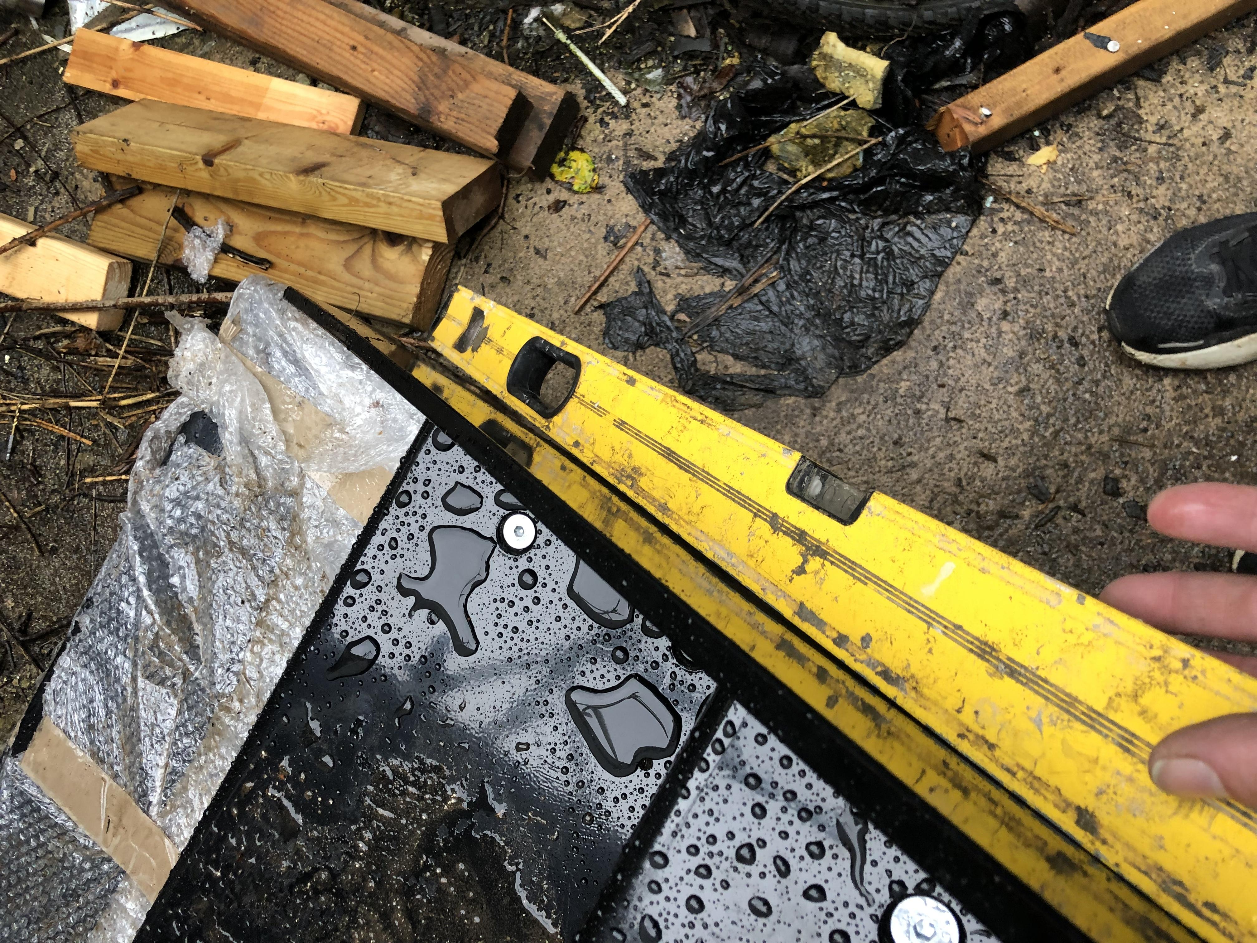

Pocster Posted October 19, 2021 Author Share Posted October 19, 2021 (edited) Bottom leg of stringer well bent . I won’t be able to hammer it out . Best way to straighten this ?? surprised how ‘bent’ the steel is - not through my efforts though !! Got to fix a balustrade arm there . Could pack it out with washers …. ? Edited October 19, 2021 by pocster Link to comment Share on other sites More sharing options...
TonyT Posted October 19, 2021 Share Posted October 19, 2021 Put a longer bolt in Link to comment Share on other sites More sharing options...
markc Posted October 19, 2021 Share Posted October 19, 2021 Is it actually bent or wasn’t straight when treads/plates were bolted in? Bolt holes are oversize to allow lining and levelling of steel prior to tightening up. loosen the bolts and then have a go at levering into alignment, then tighten up. Link to comment Share on other sites More sharing options...
Onoff Posted October 19, 2021 Share Posted October 19, 2021 The balustrade will bend to suit, don't sweat it. Other than that you'll need to jack between the bottom of the stringers. 1 Link to comment Share on other sites More sharing options...

Pocster Posted October 19, 2021 Author Share Posted October 19, 2021 1 hour ago, markc said: Is it actually bent or wasn’t straight when treads/plates were bolted in? Bolt holes are oversize to allow lining and levelling of steel prior to tightening up. loosen the bolts and then have a go at levering into alignment, then tighten up. Yeah it was ‘bent’ before I put the treads in. Might try and knock a piece of timber in there to push it out 1 Link to comment Share on other sites More sharing options...

Onoff Posted October 19, 2021 Share Posted October 19, 2021 1 hour ago, pocster said: Yeah it was ‘bent’ before I put the treads in. Might try and knock a piece of timber in there to push it out Use a couple of bits of sacrificial timber and wedge between that. One thing that might work is beg, steal or borrow the biggest adjustable spanner you can. Slip it over the top of the bent plate and gently "tweak". The longer the lever the easier. Again put something under the jaws to protect the paint. 1 Link to comment Share on other sites More sharing options...

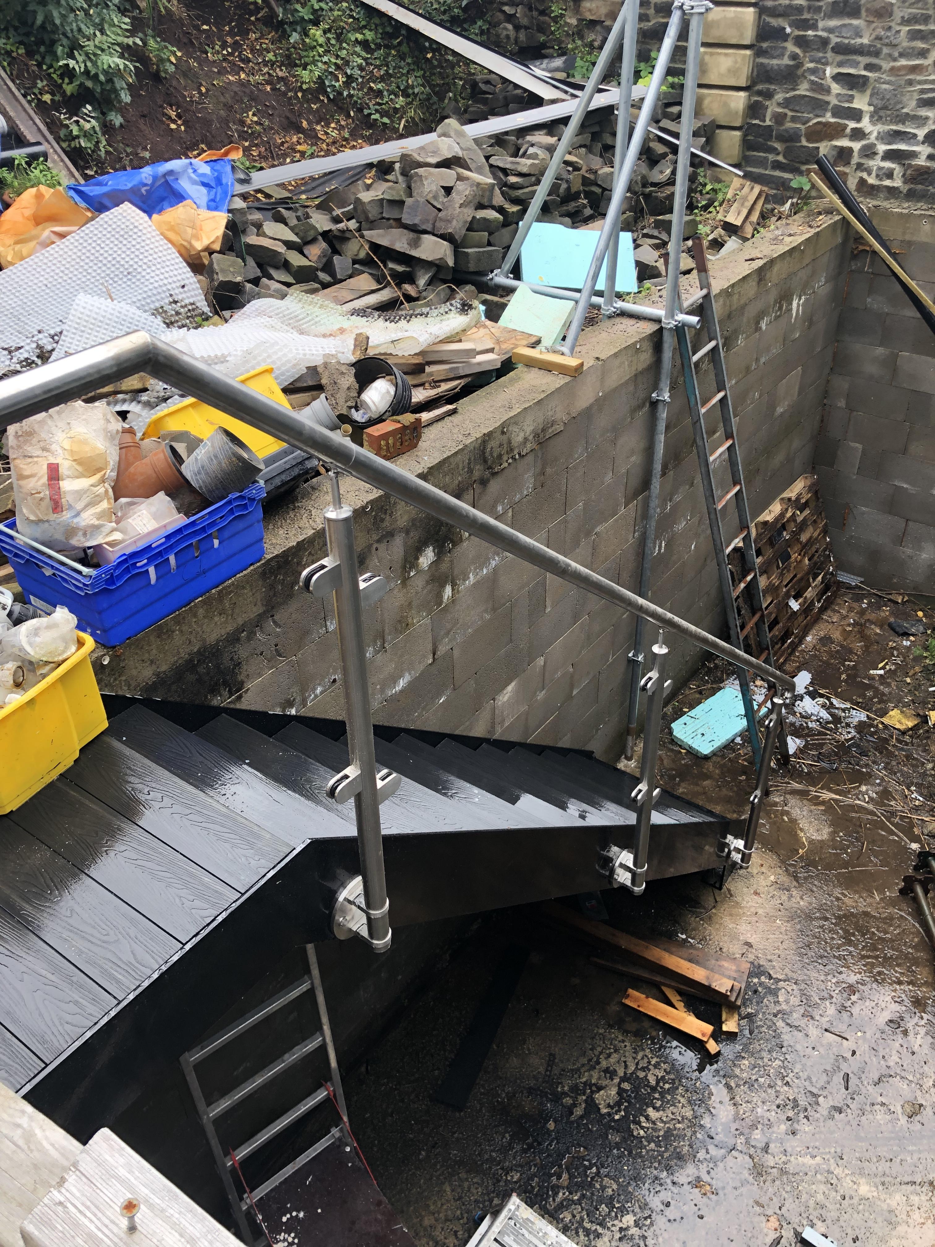

Pocster Posted October 26, 2021 Author Share Posted October 26, 2021 All done apart from the glass sides . Was a surprisingly large amount of work . Yes , all that stuff is crap destined for a skip tomorrow- I am tidying up !! ??? 3 Link to comment Share on other sites More sharing options...
