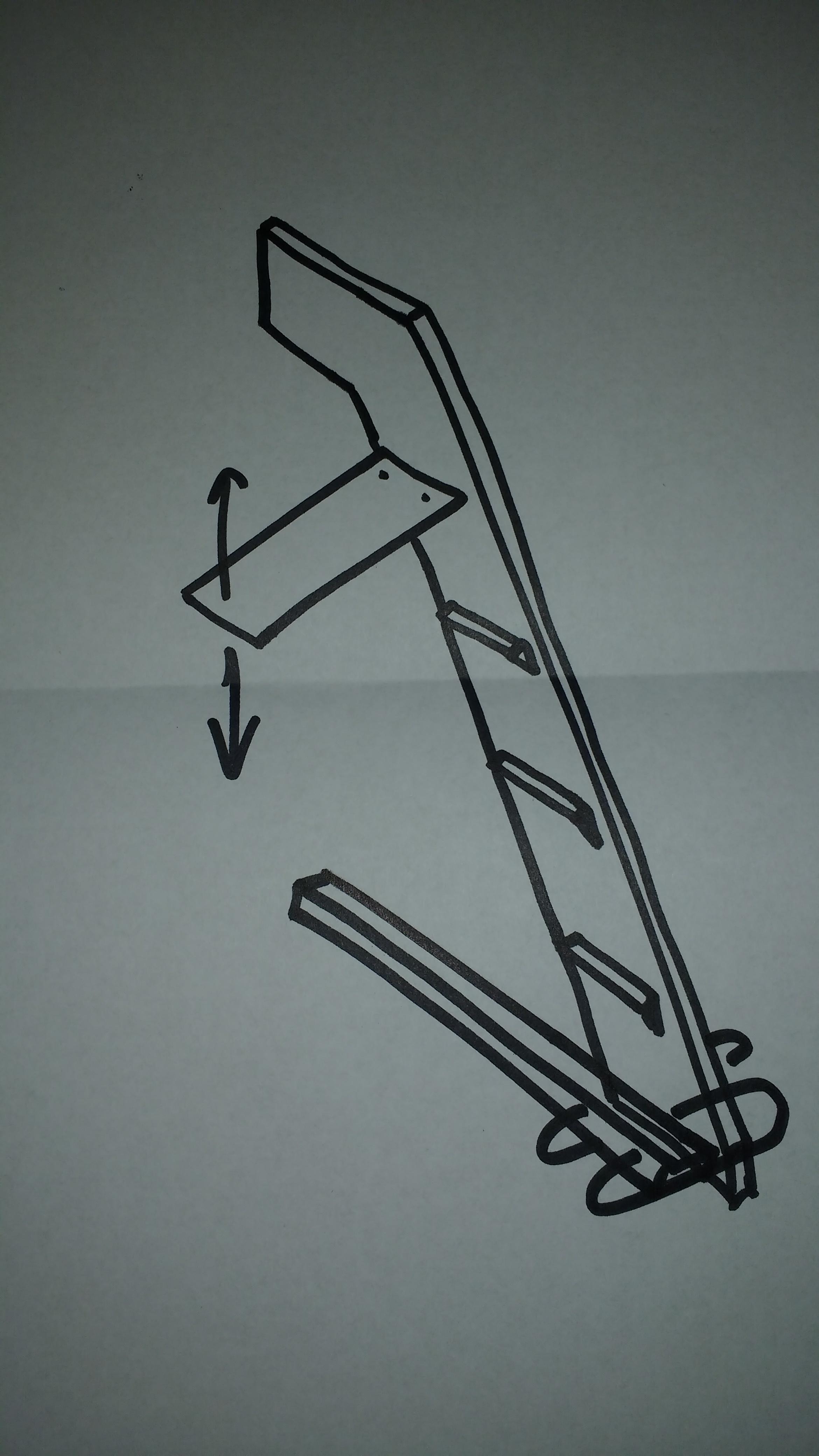

Pocster Posted October 8, 2021 Author Share Posted October 8, 2021 5 minutes ago, Onoff said: On those lines yes. Clamp a long timber etc. Get a helper would be best! What’s the timber at the base for ? Also - what’s a “ helper “ ? ? Link to comment Share on other sites More sharing options...
Onoff Posted October 8, 2021 Share Posted October 8, 2021 (edited) 49 minutes ago, pocster said: What’s the timber at the base for ? At the mo I guess your nice new steel is resting on that algae covered concrete? ? It'll scrape all the paint off the corner and rust. Also it might dig into the concrete as you're twisting it around or it might slip! Get an old rubber car mat under the bottom corner, carpet tile or rough bit of timber at a push. Rubber best as you know! Or did you mean the bit I've drawn, clamped on? To act as a lever. ? Edited October 8, 2021 by Onoff 2 Link to comment Share on other sites More sharing options...

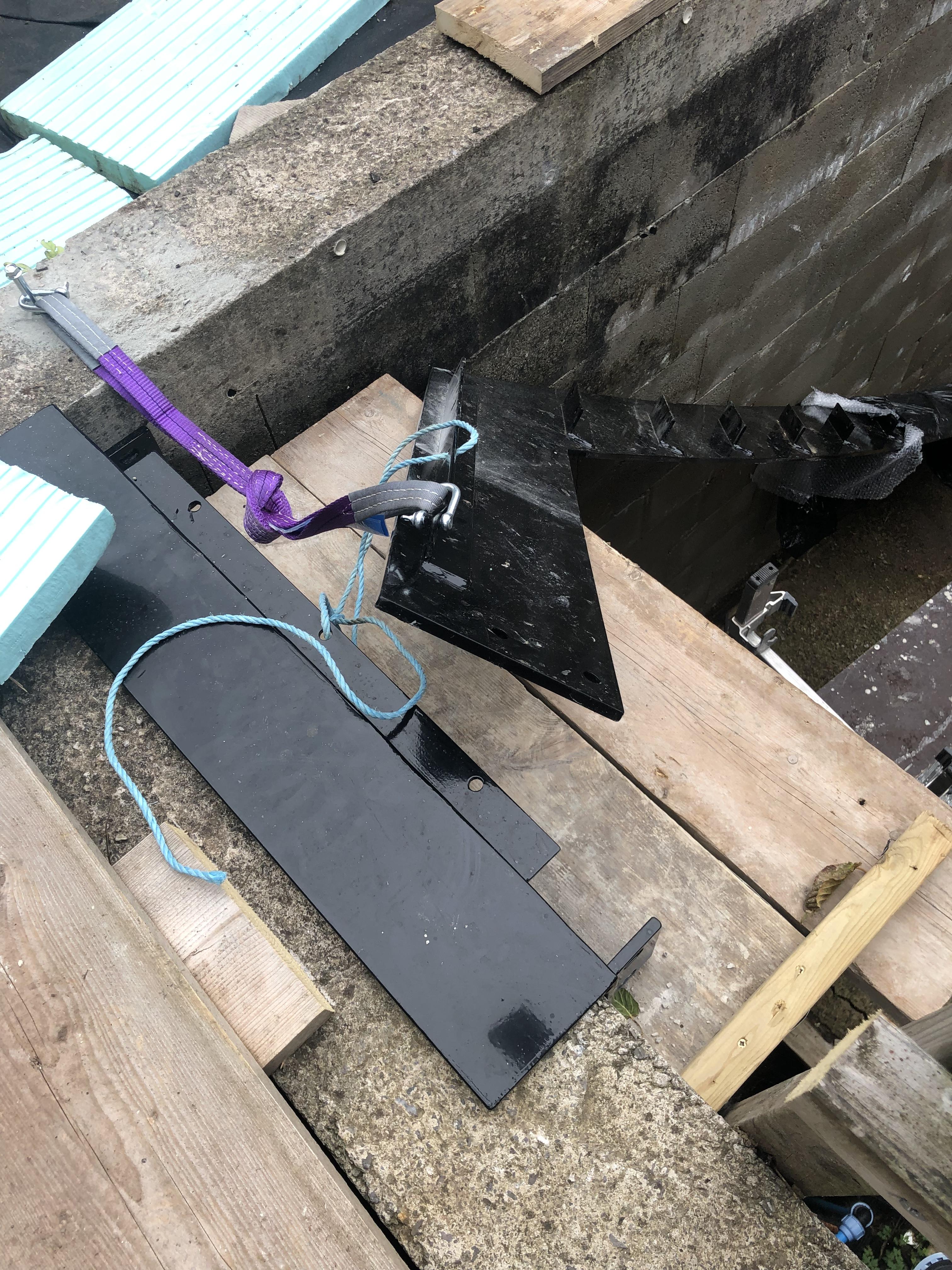

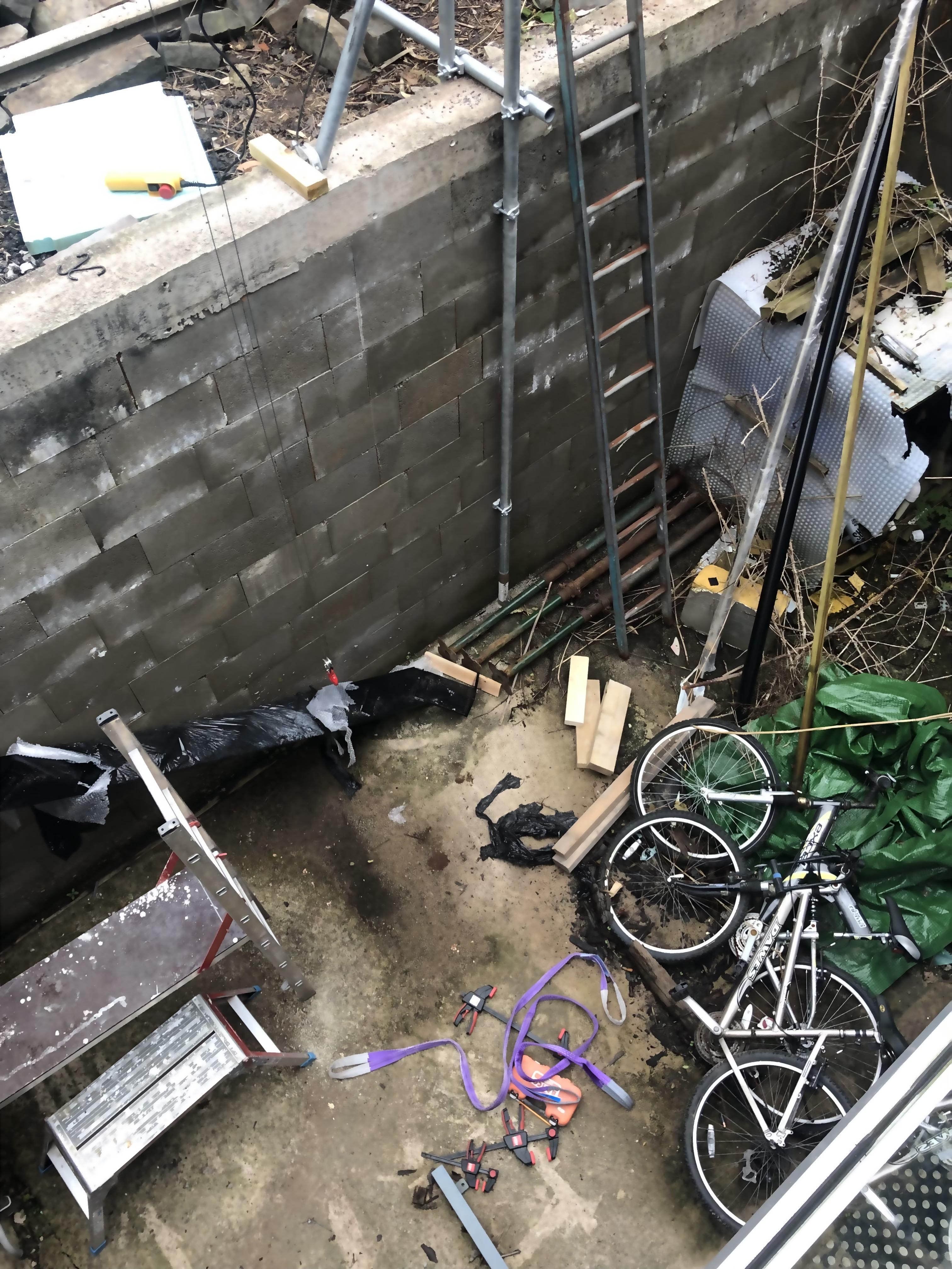

Pocster Posted October 8, 2021 Author Share Posted October 8, 2021 This just isn’t working Bolted timber to tread just bends . Did turn it by hand . Then tried to move into position and it just slipped back - couldn’t hold it . Chipped it ? So stuck like this for now . Problem with heavy physical stuff ; the more you try the more knackered and therefore weaker you get . So I need to stop for a re think Link to comment Share on other sites More sharing options...
Pocster Posted October 8, 2021 Author Share Posted October 8, 2021 Link to comment Share on other sites More sharing options...
Pocster Posted October 8, 2021 Author Share Posted October 8, 2021 2 minutes ago, Onoff said: At the mo I guess your nice new steel is resting on that algae covered concrete? ? It'll scrape all the paint off the corner and rust. Also it might dig into the concrete as you're twisting it around or it might slip! Get an old rubber car mat under the bottom corner, carpet tile or rough bit of timber at a push. Rubber best as you know! ? I know . Can’t lift bottom to put anything under it as worried it will slip ( though could use hoist ) Link to comment Share on other sites More sharing options...

Onoff Posted October 8, 2021 Share Posted October 8, 2021 If that were me...I'd stand on the scaffold, have a couple of bolts or a podger ready. Turn the stringer by hand and get a bolt in loose to that top bit. Link to comment Share on other sites More sharing options...
Pocster Posted October 8, 2021 Author Share Posted October 8, 2021 Might just spend the cash get a real crane in ! ? . Got the other stringer to do also …. Dead hard on your own ! Link to comment Share on other sites More sharing options...
Onoff Posted October 8, 2021 Share Posted October 8, 2021 Is that stringer now down in the pit? ? Stop before you hurt yourself perhaps? This lifting game doesn't appear to be your thing. That should not have happened! Thought you had tethered the top securely...I did say! Keep on like this and I'll have to come and "look after" Mrs @pocster when you're in traction or worse! ? 1 Link to comment Share on other sites More sharing options...
Onoff Posted October 8, 2021 Share Posted October 8, 2021 Serious suggestion... Lower all bits into the pit. Part build on the floor. Fit one step down the bottom Fit bracket at the top. Reposition that abortion of a "crane" and lift the end up onto the wall. SECURE THE TOP TO THE WALL! 1 Link to comment Share on other sites More sharing options...
