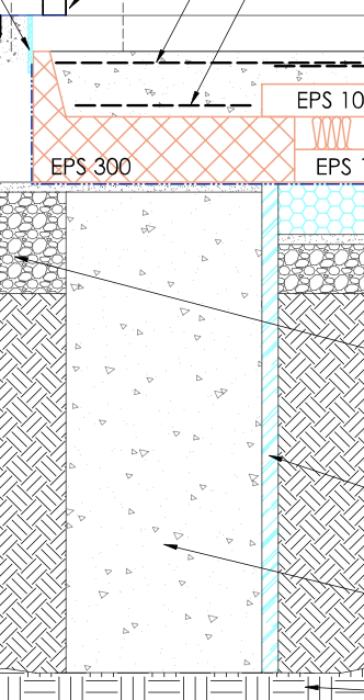

Thorfun Posted April 25, 2021 Posted April 25, 2021 20 minutes ago, DragsterDriver said: what sort of design do you have? That’s the sort of alley I may be heading down. I can easily get dug out and concreted ‘to dpc’- and lay EPS as a slab if designing and ordering a kit is problematic. by design I presume you mean foundations? if so, the basement and main house is sitting on an insulated slab (250mm thick) comprised of 200mm EPS300 underneath and 200mm EPS100 up the outside of the walls. The 'arm's of the house that are not above the basement are on 2m deep trenches down to the bedrock and then 300mm EPS300/100 laid with a 200mm slab on top. I used TSD for my structural design and they use Kore as their insulated slab of choice so it was all designed as a Kore solution. but it is just EPS so as long as I get what's required if the groundworks company don't want to use a pre-cut solution that's fine by me. They're aware of my requirements and the tolerances to work to for the timber frame and happy with it all. you can check out my blog for more details on some of this stuff. 1

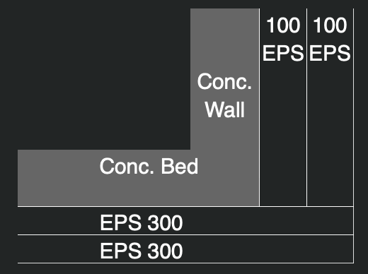

DragsterDriver Posted April 25, 2021 Author Posted April 25, 2021 27 minutes ago, Thorfun said: by design I presume you mean foundations? if so, the basement and main house is sitting on an insulated slab (250mm thick) comprised of 200mm EPS300 underneath and 200mm EPS100 up the outside of the walls. The 'arm's of the house that are not above the basement are on 2m deep trenches down to the bedrock and then 300mm EPS300/100 laid with a 200mm slab on top. I used TSD for my structural design and they use Kore as their insulated slab of choice so it was all designed as a Kore solution. but it is just EPS so as long as I get what's required if the groundworks company don't want to use a pre-cut solution that's fine by me. They're aware of my requirements and the tolerances to work to for the timber frame and happy with it all. you can check out my blog for more details on some of this stuff. Thanks I’ll keep an eye on the blog for the non basement area will you have courses of block lined with eps rather than the preformed eps formwork?
Thorfun Posted April 25, 2021 Posted April 25, 2021 2 minutes ago, DragsterDriver said: Thanks I’ll keep an eye on the blog for the non basement area will you have courses of block lined with eps rather than the preformed eps formwork? no (at least not if I understand the question!). it will be the same as the Kore system just not preformed and not using the 'L' shaped pieces of EPS at the edges. e.g. This is how TSD designed it using the Kore system for the above ground arms: you can see the insulation sitting on the trench fill with the slab poured within the insulation. but we won't be using the 'L' shaped pieces with the upstand at the edge. at least that's what I believe at the moment. we're definitely not using 'L' shaped pieces on the basement so I presume it's the same above ground although that could all change. 1
DragsterDriver Posted April 25, 2021 Author Posted April 25, 2021 6 minutes ago, Thorfun said: no (at least not if I understand the question!). it will be the same as the Kore system just not preformed and not using the 'L' shaped pieces of EPS at the edges. e.g. This is how TSD designed it using the Kore system for the above ground arms: you can see the insulation sitting on the trench fill with the slab poured within the insulation. but we won't be using the 'L' shaped pieces with the upstand at the edge. at least that's what I believe at the moment. we're definitely not using 'L' shaped pieces on the basement so I presume it's the same above ground although that could all change. Thanks! that’s what I’d like in an ideal world- not sure how I’d be able to resolve not having the premade eps formwork L shape?
Thorfun Posted April 25, 2021 Posted April 25, 2021 should say that all of this will/should be designed by your structural engineer. what works for one might not work for another and might be overkill for someone else.
Thorfun Posted April 25, 2021 Posted April 25, 2021 1 minute ago, DragsterDriver said: Thanks! that’s what I’d like in an ideal world- not sure how I’d be able to resolve not having the premade eps formwork L shape? take the base layer out beyond the slab and put up stands of EPS? if you're concerned then just get a company to design a pre-cut version. takes the risk away. it's been almost 5 months since Brexit so maybe the initial teething issues I hit have been resolved by now. you never know unless you ask. 1
