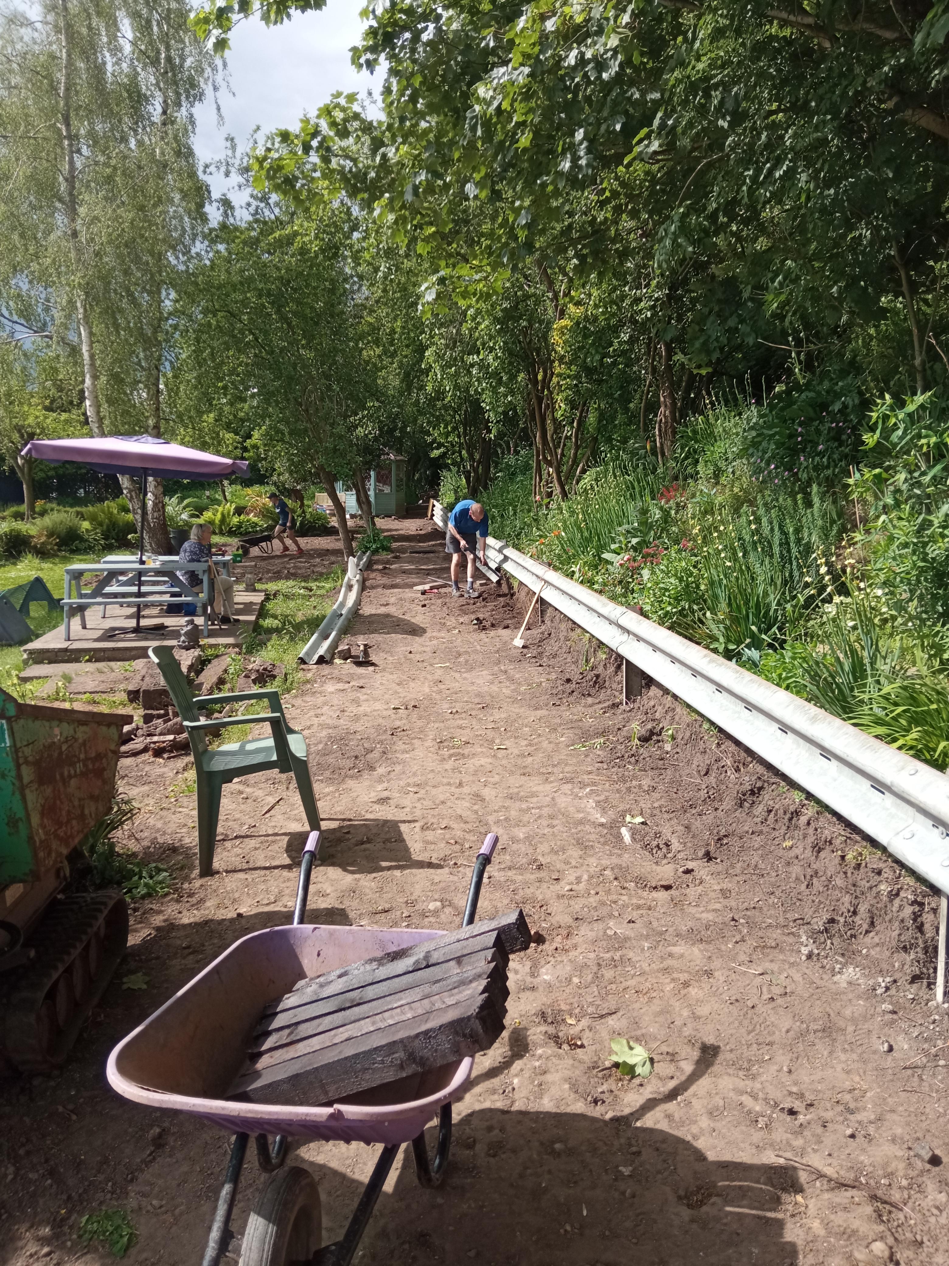

Cpd Posted May 31, 2021 Share Posted May 31, 2021 I liked the initial idea of using these as a retaining wall but after seeing what you have done I am not sure it’s justified using such heavy duty materials..... you could have purchase some standard creosote fence post that will last for 30+ years driven them in and attached a top and bottom rail and then attached your panels, would have been quicker, easier and cheaper (or maybe not as I have not done the sums ? ) if you had taken the whole fence line back a meter or two they would have been a great solution. If your happy with he result then that’s all that matters. I have some areas that need retaining and will keep my eye out for a job lot of these as I think they would be great at retaining a slope. 1 Link to comment Share on other sites More sharing options...

canalsiderenovation Posted May 31, 2021 Author Share Posted May 31, 2021 1 hour ago, Cpd said: I liked the initial idea of using these as a retaining wall but after seeing what you have done I am not sure it’s justified using such heavy duty materials..... you could have purchase some standard creosote fence post that will last for 30+ years driven them in and attached a top and bottom rail and then attached your panels, would have been quicker, easier and cheaper (or maybe not as I have not done the sums ? ) if you had taken the whole fence line back a meter or two they would have been a great solution. If your happy with he result then that’s all that matters. I have some areas that need retaining and will keep my eye out for a job lot of these as I think they would be great at retaining a slope. I think it's hard to show in the picture as we have planted lots but the embankment is very steep and sloping and we did want something more heavy duty. I'll definitely update with the finished product but as we only have dad on Saturdays it may be another 3-4 weekends. They are actually surprisingly easy to install if not just a bit heavy mainly the moving them from where they got dropped off to the other end of the garden but between me, my dad and wife we have managed so far. Concrete in posts every 158 inches and then just lifting and bolting them on. 1 hour ago, SteamyTea said: Or come and get the bent ones from the A30, it is holiday week, do many miles of it are now damaged. The guy we got them off threw in an extra 3 as some were a bit bent. We probably have some from the A30 ? Link to comment Share on other sites More sharing options...

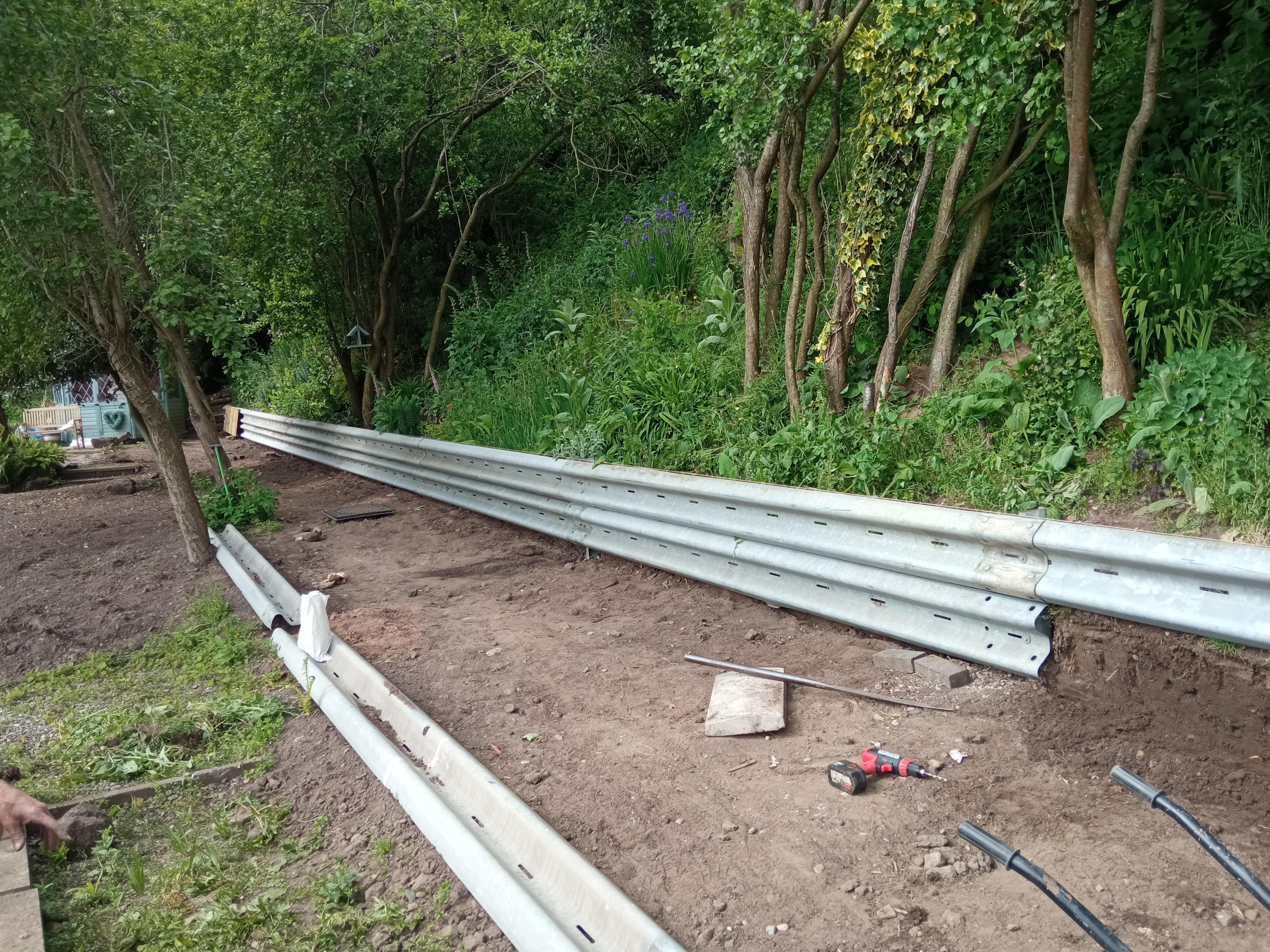

saveasteading Posted May 31, 2021 Share Posted May 31, 2021 I may be misunderstanding the intention, but if used as a retaining wall with earth behind, whether vertical or staggered, I would expect the steel will rust. It is galvanised to resist weather wetting, not sitting in wet earth. This is certainly the case with building cladding. Also check out the strength of the Z posts. There are light gauge ones that are designed to deflect in case of vehicle impact, (like the crumple zone on a car) and may not be strong enough for your wall. No opinion on the aesthetics. 1 Link to comment Share on other sites More sharing options...
SteamyTea Posted May 31, 2021 Share Posted May 31, 2021 15 minutes ago, saveasteading said: There are light gauge ones that are designed to deflect in case of vehicle impact, Static load as opposed to 1/2 mass X Velocity squared. 16 minutes ago, saveasteading said: would expect the steel will rust. Lots of proper marine stuff is galvanised, not sure what it is like if in sea for decades. 1 Link to comment Share on other sites More sharing options...
Onoff Posted May 31, 2021 Share Posted May 31, 2021 1 hour ago, saveasteading said: I would expect the steel will rust. It is galvanised to resist weather wetting, not sitting in wet earth. +1. As I said earlier in the thread I'd be putting a thick membrane between this and the earth. 1 Link to comment Share on other sites More sharing options...

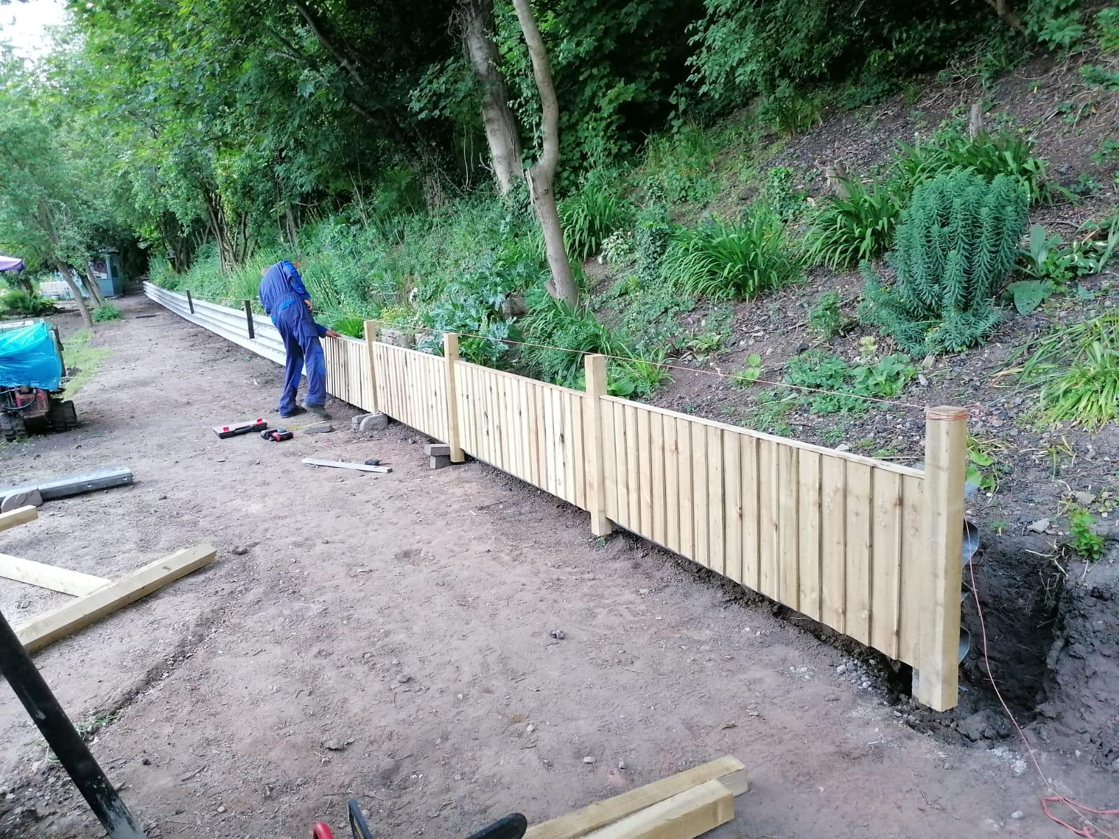

canalsiderenovation Posted June 5, 2021 Author Share Posted June 5, 2021 (edited) Ok so about half done and here's a glimpse of what we have done today and what they will look like with the fence panels bracketed on. The wooden posts are fixed onto the barriers/posts, not concreted in rather just for appearance. Really pleased with them and went for feather edge panels over waney lap. They will be sprayed with creosote or my dad said he does his with old engine oil so I'll opt for this easier job next weekend! Edited June 5, 2021 by canalsiderenovation 4 Link to comment Share on other sites More sharing options...

Ferdinand Posted June 6, 2021 Share Posted June 6, 2021 How have you protected your posts? Or are they galv-steel as well? Link to comment Share on other sites More sharing options...
canalsiderenovation Posted June 7, 2021 Author Share Posted June 7, 2021 (edited) On 06/06/2021 at 12:20, Ferdinand said: How have you protected your posts? Or are they galv-steel as well? Dad said these are galv steel too and concreted in. Edited June 7, 2021 by canalsiderenovation Link to comment Share on other sites More sharing options...
Ferdinand Posted June 7, 2021 Share Posted June 7, 2021 2 hours ago, canalsiderenovation said: Dad said these are galv steel too and concreted in. Galv steel would be fine. Wood concreted in would rot just above the concrete in a depressingly short time. Link to comment Share on other sites More sharing options...
canalsiderenovation Posted June 7, 2021 Author Share Posted June 7, 2021 5 minutes ago, Ferdinand said: Galv steel would be fine. Wood concreted in would rot just above the concrete in a depressingly short time. Yep the wood panels will be just fixed onto the barriers and with brackets so they can be lifted on and off for maintenance/replacement. All fence panels and posts should be on the weekend. And then we just have the other 20 metres to do but now we know what we are doing it shouldn't be too difficult. Link to comment Share on other sites More sharing options...
