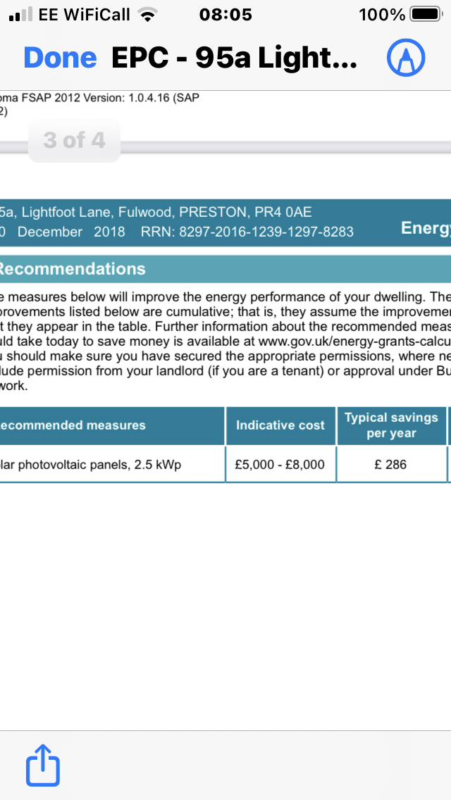

nod Posted April 18, 2021 Author Posted April 18, 2021 I’m just looking through the local planning Three have been passed on a local farm All on oil Sap rating of 94 Though they have included PV which we avoided on our first build Partly because we hate the look of them and partly because they would never pay for themselves picture is from the final sap on our first build We were surprised that spending all that on solar panels would only add two points to the sap rating
MikeSharp01 Posted April 18, 2021 Posted April 18, 2021 3 minutes ago, nod said: We were surprised that spending all that on solar panels would only add two points to the sap rating It must be the regs then allow people to NOT have have homes that impact the planet less. We almost had something like we needed in the 2016 regs that HMG deleted prior to them coming into force. On the plus (ish) side there is a new PART L coming and I found a good review of this and the associated new SAP scheme HERE which shows how much tougher it will be for the big house builders and the self builder.
