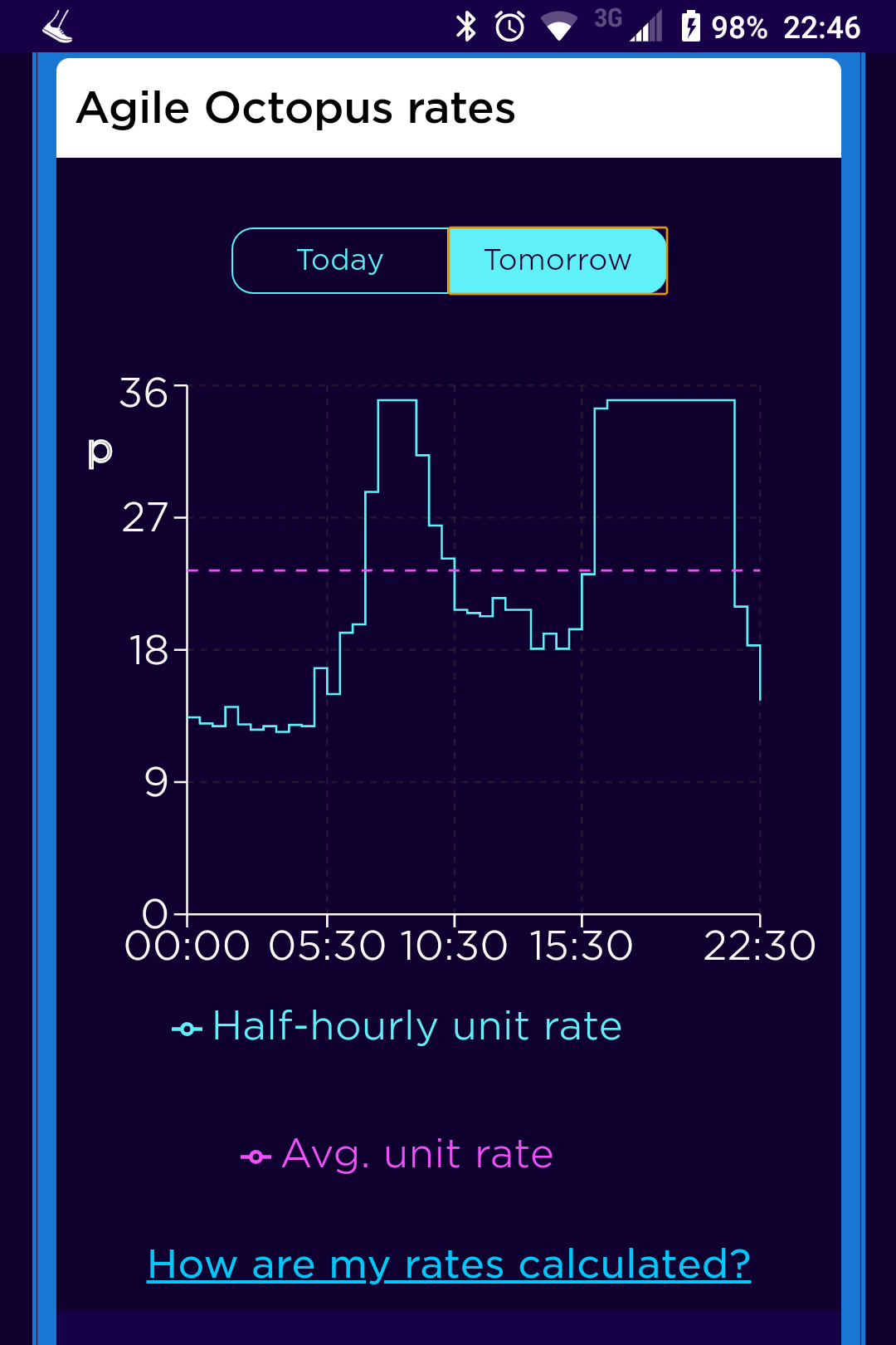

NSS Posted April 12, 2021 Share Posted April 12, 2021 Agile rates have been up with the recent cold snap but tomorrow's rates are off the scale!!! Link to comment Share on other sites More sharing options...

ProDave Posted April 13, 2021 Share Posted April 13, 2021 13 hours ago, NSS said: Agile rates have been up with the recent cold snap but tomorrow's rates are off the scale!!! Remind me of the advantage of this Vs paying 16/17p 24/7? Link to comment Share on other sites More sharing options...
canalsiderenovation Posted April 13, 2021 Author Share Posted April 13, 2021 28 minutes ago, ProDave said: Remind me of the advantage of this Vs paying 16/17p 24/7? I think there are days when it's very low but it wouldn't work for us. Our Tarrif is this one. Link to comment Share on other sites More sharing options...
