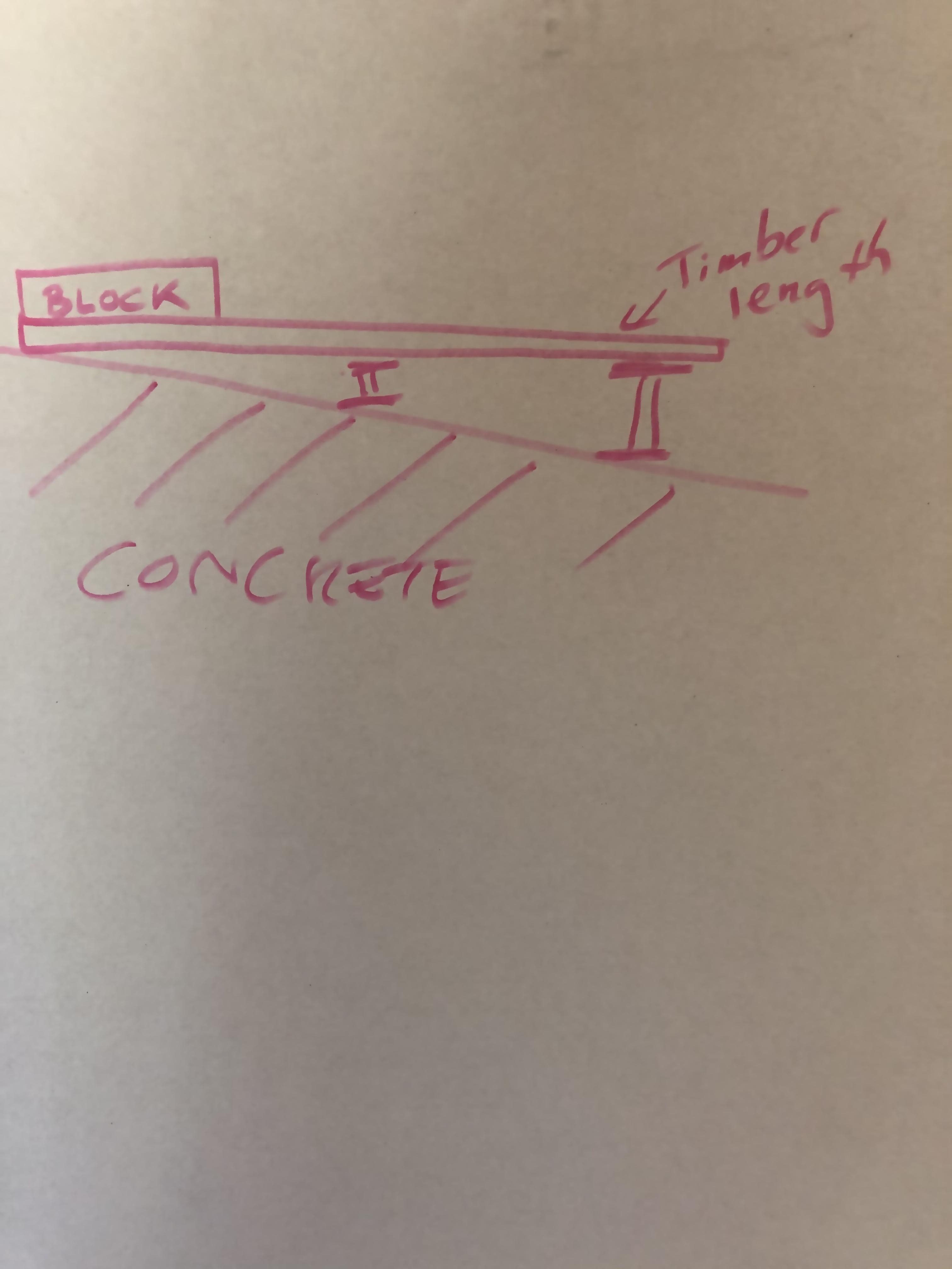

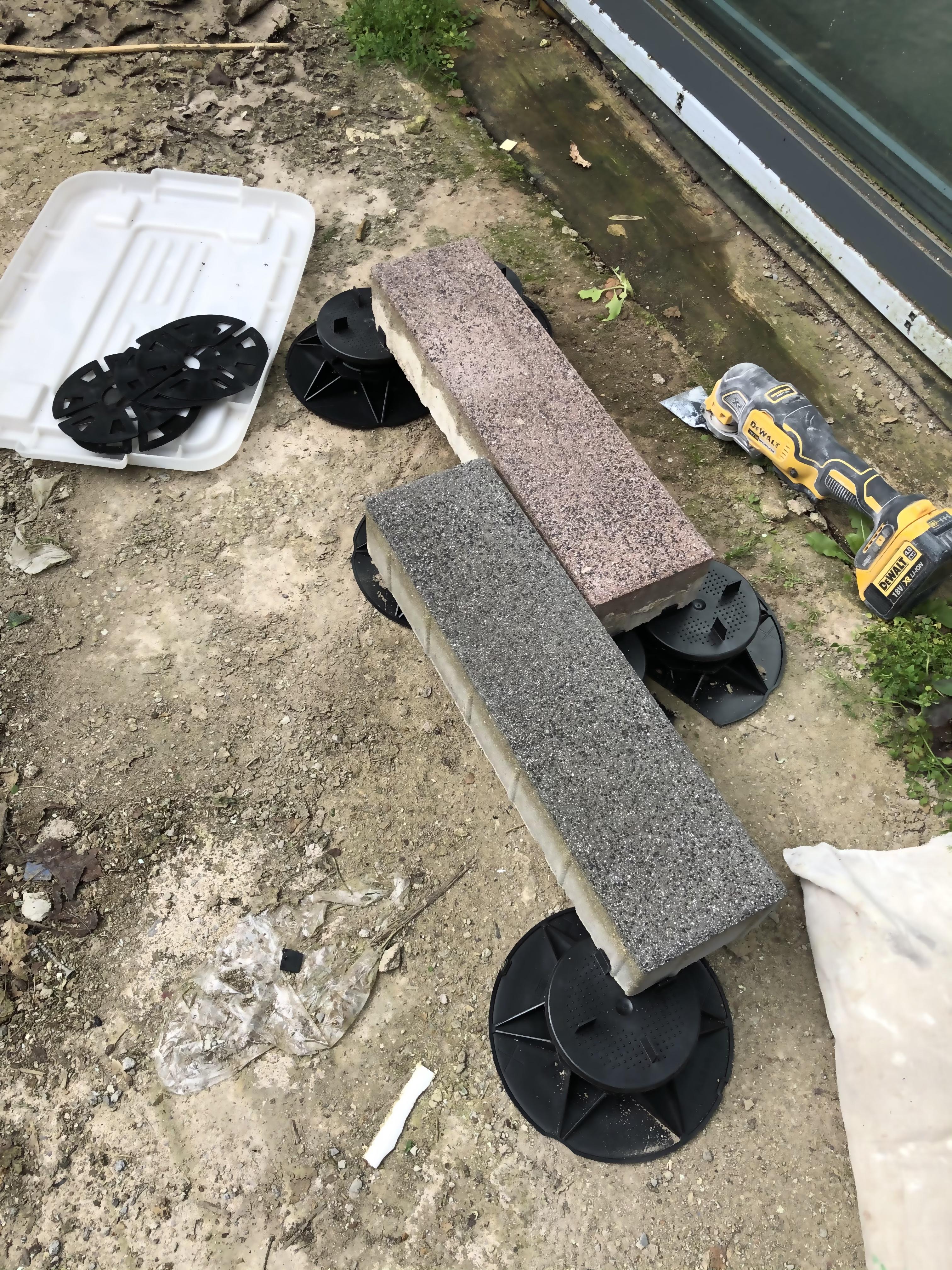

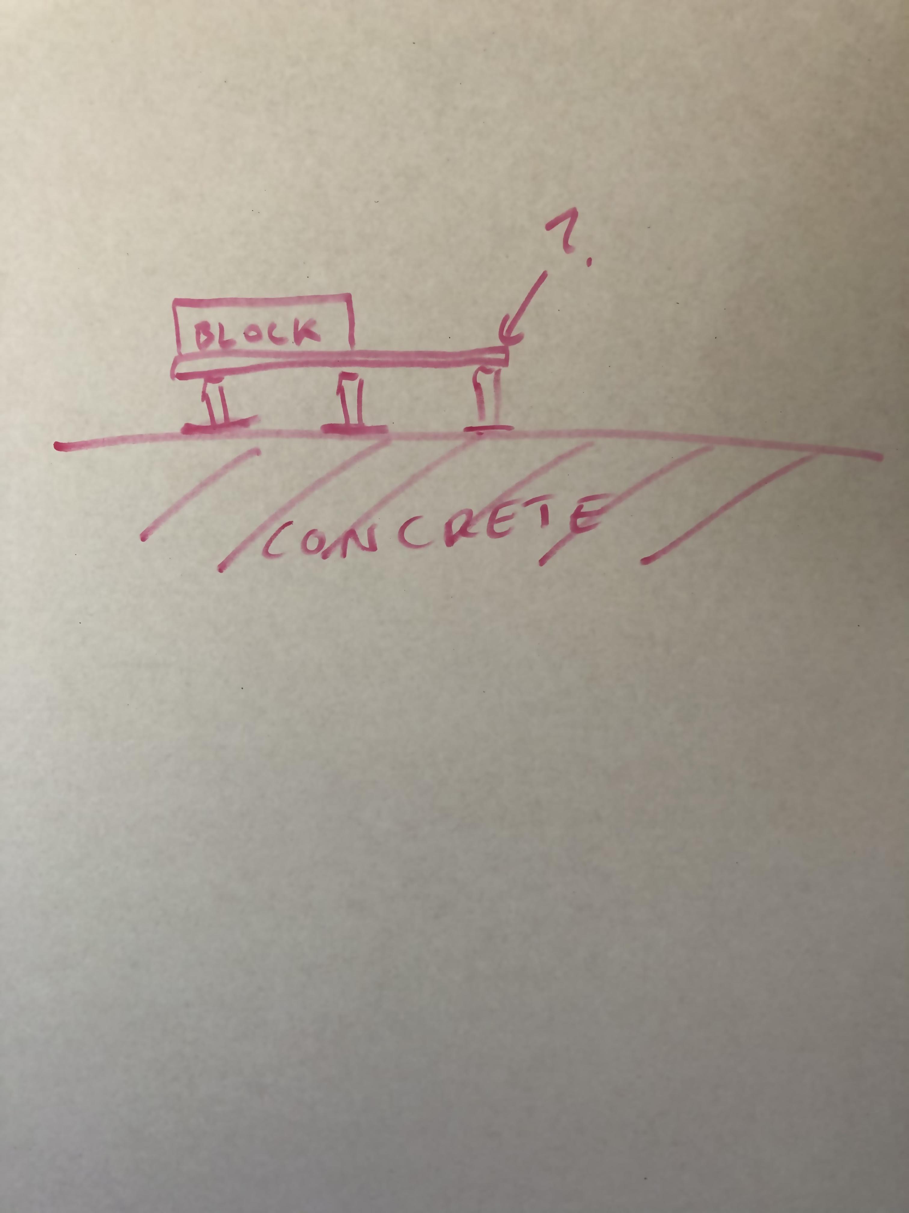

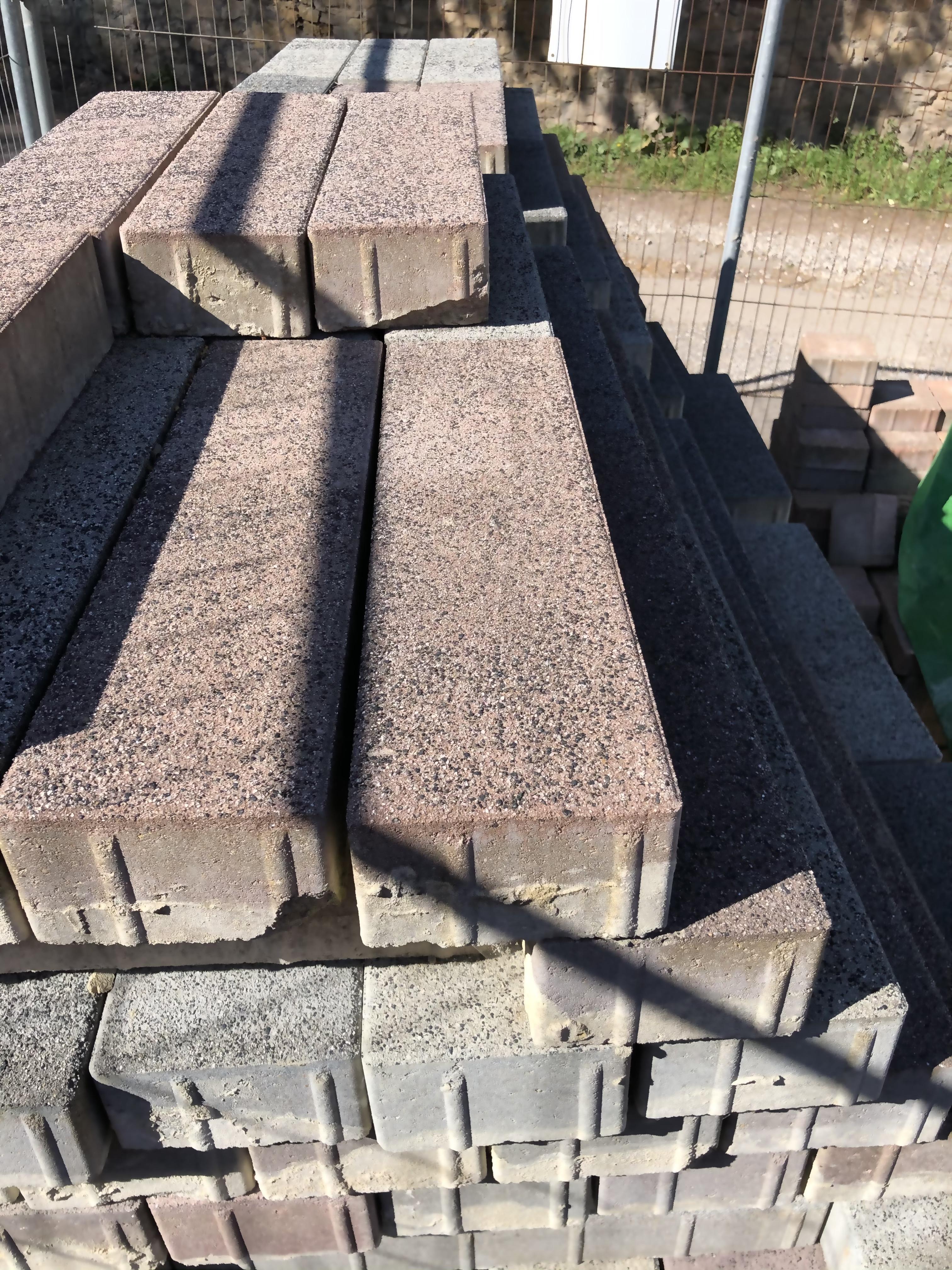

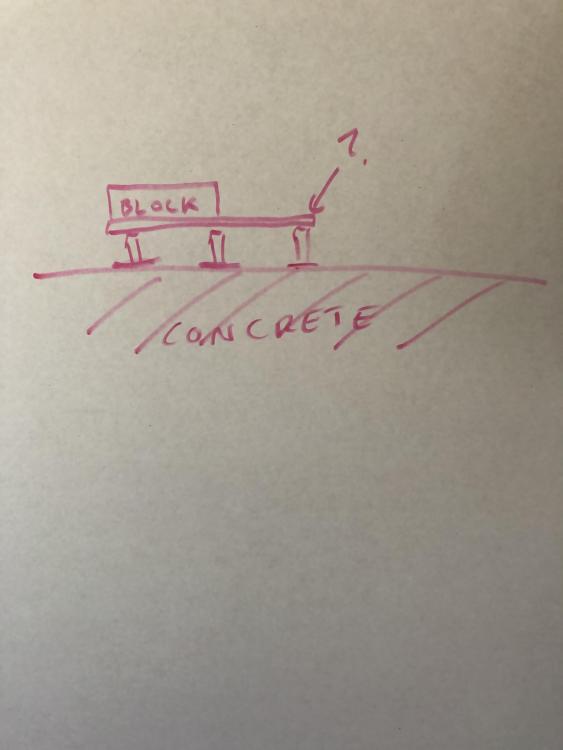

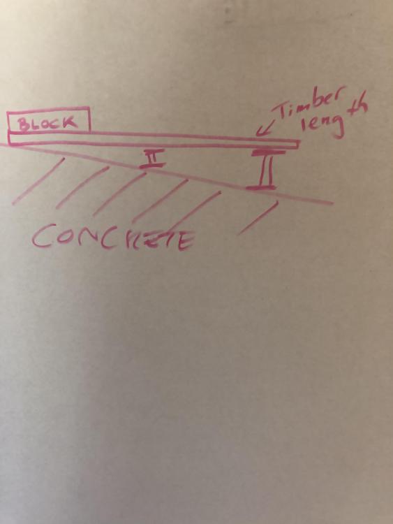

Pocster Posted April 2, 2021 Posted April 2, 2021 Bought these some time ago but can’t use them as intended . So ! New plan ! Going to use them in a different location just for walking on . Problem is the concrete they sit on isn’t level ( at the time was designed to have a fall ) . Really would want to use the plastic stilt legs - but they can’t be used on a narrow tile . My current plan was the stilts but with some kind of “ board” ontop . Then the long blocks are just sat on that ( no adhesive , no sand ) . Water can then drain through to my sump . But what board can I use outside ? . Really a nice 600 x 600 size would be good as it means I can position the stilts at each corner and centre ; also can adjust to suit the fall . First thought was simply concrete slabs but they are heavy and not as cheap as I hoped . Diagram to explain the plan !!
Pocster Posted April 2, 2021 Author Posted April 2, 2021 Thinking .... What about pressurised timber lengths ? How long would they last though ? . Bend / warp due to weather and the weight of the blocks ? Maybe some box steel lengths ???
Mr Punter Posted April 2, 2021 Posted April 2, 2021 Those blocks are designed to go on a solid bed like sand, mortar or concrete. If you want to use the stilts you can use decking or pavers. I have them with non-slip porcelain slabs on a roof terrace. Maybe just store the blocks somewhere next to the walk-on glass... 1 1

Declan52 Posted April 2, 2021 Posted April 2, 2021 How would you stop them moving about when you walk on them. Either bed them on sharp sand which will help drainage Or Put them on eBay or Facebook marketplace. Use the money to buy some composite decking.

PeterW Posted April 2, 2021 Posted April 2, 2021 2 hours ago, pocster said: But what board can I use outside A “For Sale” board ... sell them, buy the right thing and move on... I first thought they were Heras fence blocks, they will not do what you want so get rid and buy the right thing. You could even offer someone some free walk on glazing if they buy the lot ... 1 1

Russell griffiths Posted April 2, 2021 Posted April 2, 2021 You can certainly use them with a porous bedding under them but not on those plastic things. ??????✊✊??
Pocster Posted April 2, 2021 Author Posted April 2, 2021 22 minutes ago, Russell griffiths said: You can certainly use them with a porous bedding under them but not on those plastic things. ??????✊✊?? (expletive deleted) off ! My plan wasn’t on the plastic stilts - as they wont fit . So something else to support them . Miserable (expletive deleted) (expletive deleted) wits
joe90 Posted April 2, 2021 Posted April 2, 2021 Pocker, what height do you need at the highest end?, how wide the area? ?
Pocster Posted April 2, 2021 Author Posted April 2, 2021 (edited) 7 minutes ago, joe90 said: Pocker, what height do you need at the highest end?, how wide the area? ? Not on site so guessing ... Blocks are about 80mm . At ‘deapest’ end I would say around 180mm - so 100mm to play with . What are you thinking ?? Area is approx 7m x 2.5m Edited April 2, 2021 by pocster

joe90 Posted April 3, 2021 Posted April 3, 2021 12 hours ago, pocster said: What are you thinking ?? If only 100mm, you will need a slight fall so 75mm, cast a concrete “ring beam” to the level you want and fill with stone/dust to create a flat (ish) area ! 1
Pocster Posted April 3, 2021 Author Posted April 3, 2021 1 minute ago, joe90 said: If only 100mm, you will need a slight fall so 75mm, cast a concrete “ring beam” to the level you want and fill with stone/dust to create a flat (ish) area ! Yeah I did think about something like that . 3 sides are already ‘retained ‘ ( concrete wall ) . So it is possible. I liked the stilts approach because it allowed drainage and also “ seemed “ like less work . I have stilts and blocks on site - so cost would be zero ( ish ) . Going to site today will take another look ?
joe90 Posted April 3, 2021 Posted April 3, 2021 (edited) 11 minutes ago, pocster said: because it allowed drainage Fair comment but how do you drain “your pit”?? (Ah, presuming this is where you are talking about).? Edited April 3, 2021 by joe90
Pocster Posted April 3, 2021 Author Posted April 3, 2021 6 minutes ago, joe90 said: Fair comment but how do you drain “your pit”?? There’s 2 sumps lower than the concrete so everything runs into there . I want the paving to be level with the doorway . Could put a slot drain in . But it’s all more work ! ? 1

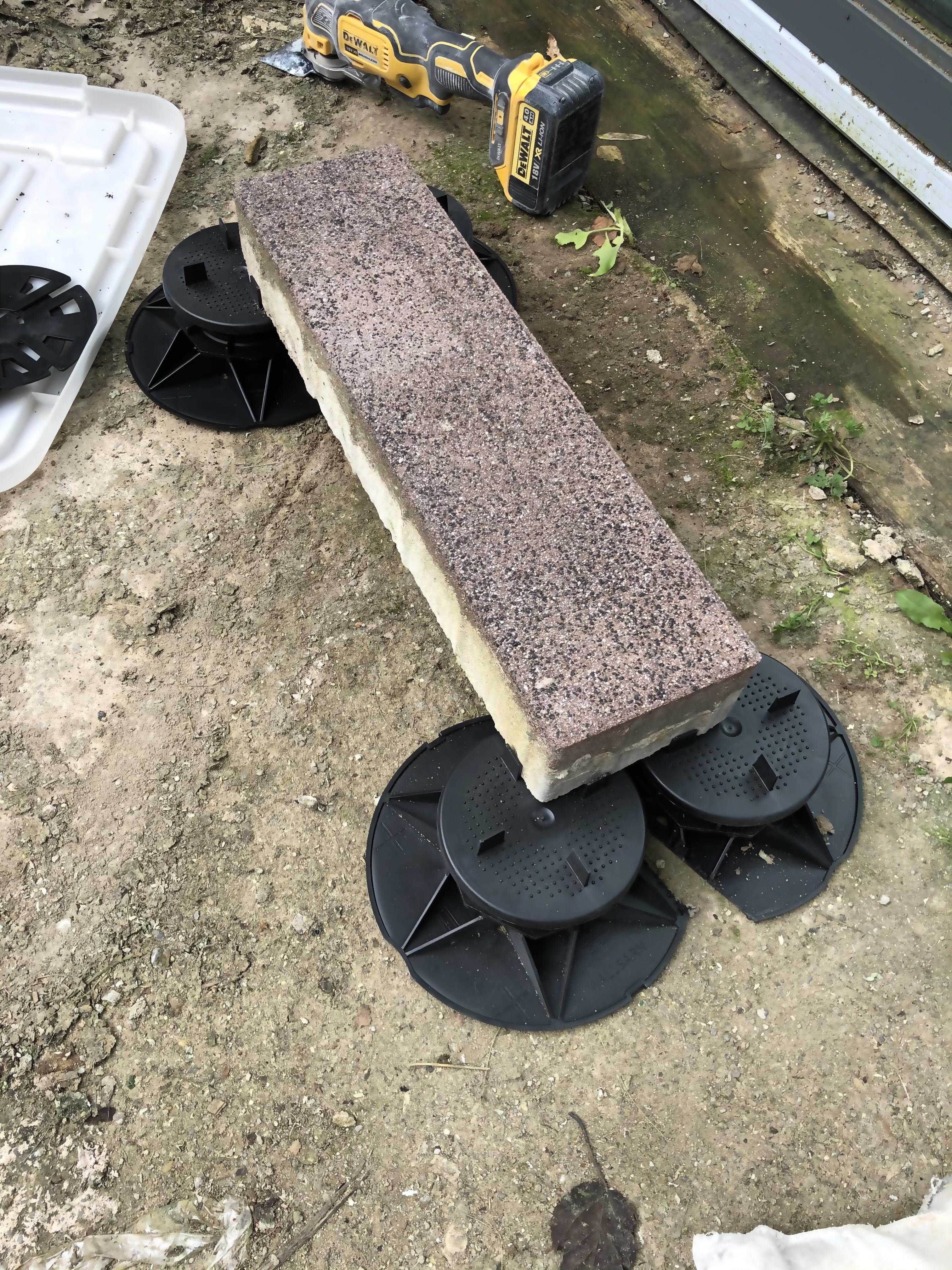

Pocster Posted April 3, 2021 Author Posted April 3, 2021 (edited) Proof of concept ? Edited April 3, 2021 by pocster
joe90 Posted April 3, 2021 Posted April 3, 2021 2 hours ago, pocster said: If you have the stuff then use it, why not do a trial area ? Do you have to fix the plastic feet so they don’t “walk”?
