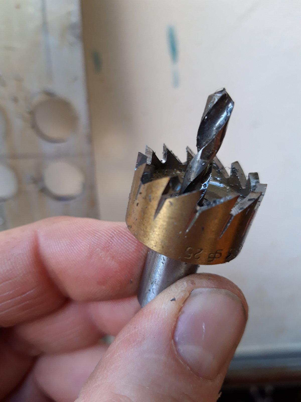

Onoff Posted April 1, 2021 Posted April 1, 2021 20mm Starter cutter and keep dipping it it Trefolex, Temaxol, Rocol RTD etc. A new 1/4" Starrett pilot drill will go straight through 11mm steel no messing. How many holes? I did 42 25mm holes in 5mm stainless: With ONE of these Chinesium bits and this was it at the end. In the pillar drill admittedly:

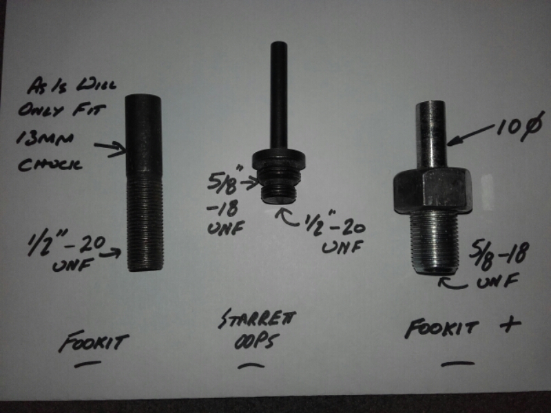

Onoff Posted April 2, 2021 Posted April 2, 2021 1 hour ago, dpmiller said: I'd go with Clive's hole saw option. Less material to remove... Less swarf too. You do of course have the diddy roundel that comes out when you're finished. Hopefully it'll pop out and fall to the floor rather than down the leg of your rigger boot! The best hole saws in my ever so humble opinion are Morse brand. Dark red in colour. Used to get them from Wholesale Fittings. They're are cobalt. Knock the Bosch ones into a cocked hat. A genuine Starrett pilot drill is a great thing to have as a general purpose drill bit for most metals including stainless and they are HsCo so cobalt. 1 hour ago, bassanclan said: I will add if you want to make life easy for yourself buy some dewalt extreme cobalt drill bits. I agree that they are good. The ones with the points on the end? I've been impressed. (I wouldn't use them in this case though). The most impressive (stupid?) thing I've ever seen is a 7' South African labourer drilling an I section column. I couldn't figure why so much smoke. He was drilling the beam with 10mm Dormer HSS drills in a 110V pistol drill. No pilot, no lube, just muscle...and plenty of drills! However do not skimp on the cutting compound. It does what it says on the tin and makes drilling easier and prolongs the tool life. It's that important imo. However do not skimp on the cutting compound. It does what it says on the tin and makes drilling easier and prolongs the tool life. It's that important imo. ?
Nickfromwales Posted April 2, 2021 Posted April 2, 2021 I just use bi metal holesaws and a 32mm hole takes just a couple of mins tbh. Needs a lubricant / cutting fluid via pump bottle or aerosol can or the bit will overheat. Remember if it’s for cables you’ll need to allow for a piece of conduit or a brass bush so size the hole accordingly because making it a bit bigger after is a royal pita.
Onoff Posted April 2, 2021 Posted April 2, 2021 6 minutes ago, Nickfromwales said: making it a bit bigger after is a royal pita. Not if you've made some adapters up! A Porta-Punch hydraulic hole punch is a cracking bit of kit. A lad I worked with had a 110V one. We were punching I beam flanges in a bank and set the basement vault vibration alarms off where it reverberated down through the steel. (We were I add, supposed to be in the bank).
