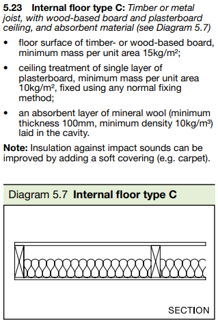

MortarThePoint Posted May 7, 2021 Author Share Posted May 7, 2021 In important consideration in all of this is Part E of building regulations: 18mm OSB3 and CaberFloor are below that 15kg/m2 requirement. I think 22mm OSB3 is also below 15kg/m2, but it is hard to find information on that. I spoke to a technical person at Norbord and they said it may have an issue there. [NOTE: normal 12.5mm wallboard plasterboard doesn't meet the 10kg/m2 requirement either]. Link to document 1 Link to comment Share on other sites More sharing options...
Moonshine Posted May 7, 2021 Share Posted May 7, 2021 8 minutes ago, MortarThePoint said: In important consideration in all of this is Part E of building regulations: 18mm OSB3 and CaberFloor are below that 15kg/m2 requirement. I think 22mm OSB3 is also below 15kg/m2, but it is hard to find information on that. I spoke to a technical person at Norbord and they said it may have an issue there. [NOTE: normal 12.5mm wallboard plasterboard doesn't meet the 10kg/m2 requirement either]. This construction is really a 'deemed to satisfy' construction, and what it satisfies is the requirement of ADE that the internal walls and floor meet min Rw 40 dB. You can meet Rw 40 dB with out the insulation and 18mm board, though with 15mm wall board ceiling. https://www.gyproc.ie/sites/default/files/C106029.pdf 1 Link to comment Share on other sites More sharing options...
MortarThePoint Posted May 7, 2021 Author Share Posted May 7, 2021 5 minutes ago, Moonshine said: This construction is really a 'deemed to satisfy' construction, and what it satisfies is the requirement of ADE that the internal walls and floor meet min Rw 40 dB. You can meet Rw 40 dB with out the insulation and 18mm board, though with 15mm wall board ceiling. https://www.gyproc.ie/sites/default/files/C106029.pdf So if I understand it that document is setting out a valid substitute to the Part E "Internal floor type C". Link to comment Share on other sites More sharing options...

MortarThePoint Posted May 7, 2021 Author Share Posted May 7, 2021 37 minutes ago, PeterW said: Why are you looking at Part E for floors as it’s not required for a single dwelling As I read it Part E does apply within a single dwelling. Table 0.1a and 0.1b set out values for 'separating' walls and floors which I presume means between dwelling units (e.g. flats) and the prevailing value for floors is around 45 dB for airborne sound. Table 0.1c sets out values within a dwelling and has a value of 40dB. Link to comment Share on other sites More sharing options...
Moonshine Posted May 7, 2021 Share Posted May 7, 2021 58 minutes ago, MortarThePoint said: So if I understand it that document is setting out a valid substitute to the Part E "Internal floor type C". No its not, those detailed in ADE are just examples of how you can meet the requirement of ADE for Rw 40 dB for internal partitions. You could have a partition floor made solely of cheese and as long as you had a lab test showing it met Rw 40 dB it would meet the requirements. Though meeting the fire regs for a cheese floor would be interesting, and a tasty fondue. 1 Link to comment Share on other sites More sharing options...
Moonshine Posted May 7, 2021 Share Posted May 7, 2021 42 minutes ago, ADLIan said: Part E applies to intermediate floors and certain partition walls within a dwelling. More onerous standards apply to party walls and separating floors between dwellings Just to build on this, the requirements for ADE for internal partitions (Rw 40 dB) is determined by a lab based measurement, you don't do testing on site for internal partitions. For separating walls and floor between dwellings (attached houses / flats) you have to do on site testing (unless using the Robust Details scheme), to demonstrate compliance of meeting the minimum requirements of ADE (new build Dn,Tw + Ctr >= 45 dB, Ln,Tw <=62 dB), testing requirement frequency is usually 10% of constructions on site. Link to comment Share on other sites More sharing options...
PeterW Posted May 7, 2021 Share Posted May 7, 2021 17 minutes ago, MortarThePoint said: As I read it Part E does apply within a single dwelling. Table 0.1a and 0.1b set out values for 'separating' walls and floors which I presume means between dwelling units (e.g. flats) and the prevailing value for floors is around 45 dB for airborne sound. Table 0.1c sets out values within a dwelling and has a value of 40dB. Only certain rooms (bathrooms for example) and habitable rooms. Egger Protect is 16.2kg/sqm for 22mm from memory. Link to comment Share on other sites More sharing options...

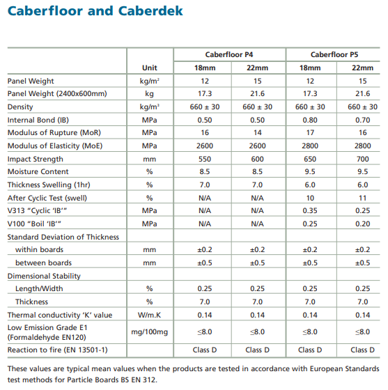

MortarThePoint Posted May 7, 2021 Author Share Posted May 7, 2021 12 minutes ago, PeterW said: Egger Protect is 16.2kg/sqm for 22mm from memory. I've found it very hard to find density information. This link suggests Egger Protect has a density of 620kg/m3 which would give an area density of 13.6kg/m2 for 22mm thickness. Link to comment Share on other sites More sharing options...

PeterW Posted May 8, 2021 Share Posted May 8, 2021 On 07/05/2021 at 11:12, MortarThePoint said: I've found it very hard to find density information. This link suggests Egger Protect has a density of 620kg/m3 which would give an area density of 13.6kg/m2 for 22mm thickness. So I’ve never had a BCO pull up on the board density and it’s the widest used board in new builds now so unless you’ve got the worlds worst BCO, I would put 22mm Egger Protect down and move on ..?? Link to comment Share on other sites More sharing options...
SimonD Posted May 8, 2021 Share Posted May 8, 2021 1 hour ago, PeterW said: So I’ve never had a BCO pull up on the board density and it’s the widest used board in new builds now so unless you’ve got the worlds worst BCO, I would put 22mm Egger Protect down and move on ..?? To put the board density question into perspective, I've just bought a load of Knauf Aquapanel Outdoor - the given density for this board is 16kg/m2. Is there actually a timber based board that doesn't contain cement that gets up to 15kg/m2 without a silly thickness? Link to comment Share on other sites More sharing options...
MortarThePoint Posted May 8, 2021 Author Share Posted May 8, 2021 22mm CaberFloor states it is 15kg/m2. 18mm OSB3 will be well under. As @PeterW states it's unlikely any BCO will care though. Link to comment Share on other sites More sharing options...
SimonD Posted May 9, 2021 Share Posted May 9, 2021 16 hours ago, MortarThePoint said: 18mm OSB3 will be well under. As @PeterW states it's unlikely any BCO will care though. I completely agree. I have 18mm OSB and density has never been a consideration by anyone. It's only the structural performance of the board that's ever been considered. It's worth keeping in mind that, as @Moonshine suggested, the building regulations aren't entirely prescriptive and you've got detailing options, often provided by materials manufacturers. Link to comment Share on other sites More sharing options...
