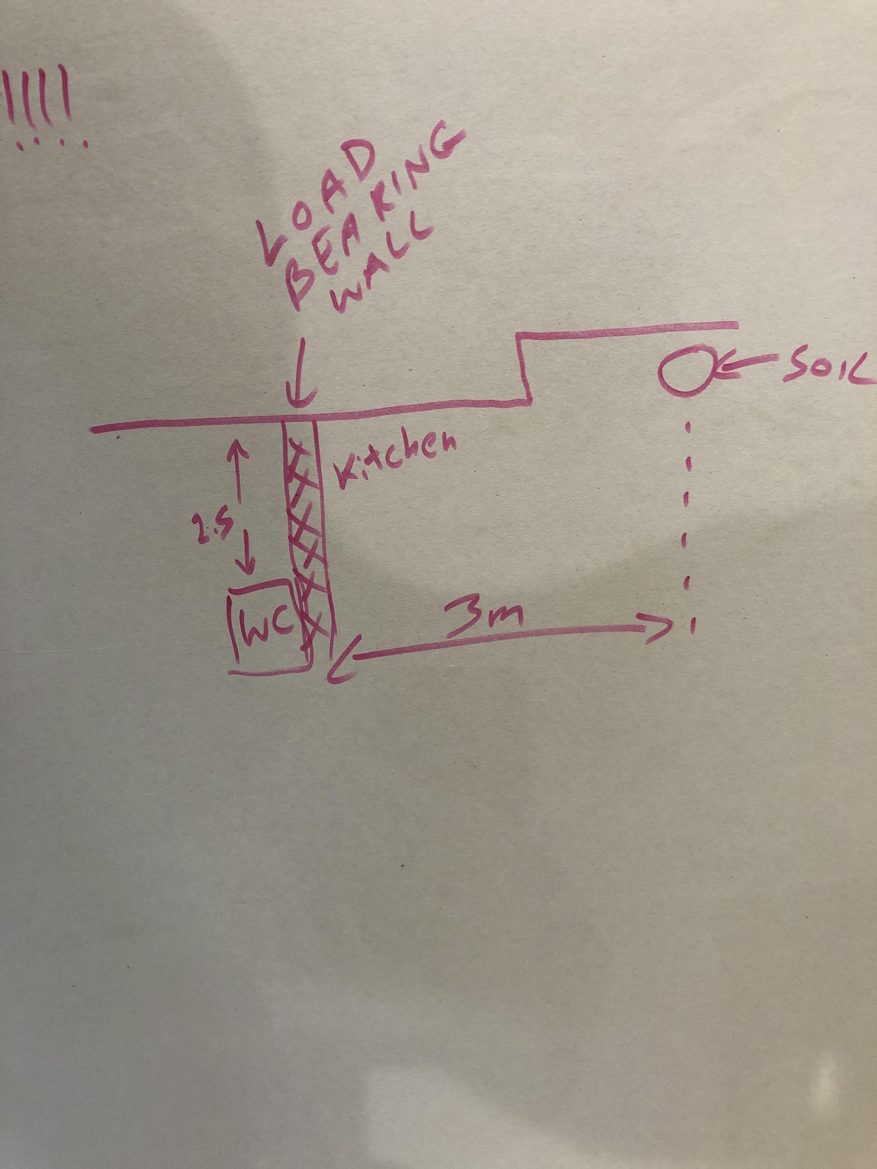

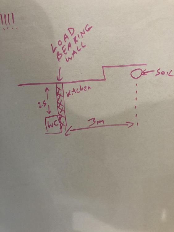

Pocster Posted March 23, 2021 Author Share Posted March 23, 2021 20 minutes ago, ProDave said: I am still failing to understand why you cannot do the 3M up straight from the macerator and then the 3m horizontal laid to a fall into the stack? you seem to have hit a block because ou want to do the horizontal bit first? Got my architect to knock up a professional drawing showing the issue Link to comment Share on other sites More sharing options...
ProDave Posted March 23, 2021 Share Posted March 23, 2021 4 minutes ago, pocster said: I can go straight up 2.5m . But I have to then run horizontally 3m . At that point I am *below* my soil pipe by around 60cm Not sure what @Nickfromwales is suggesting with his link . As the consensus is macerator output has to be near wc . Yet at that point I’m still not high enough to get to soil pipe ... What is the constraint? Under a stairwell or something? re locate the WC to a place you can do all the UP from? EDIT: just seen the drawing. Move the WC to the right so it is under the full headroom bit? Link to comment Share on other sites More sharing options...

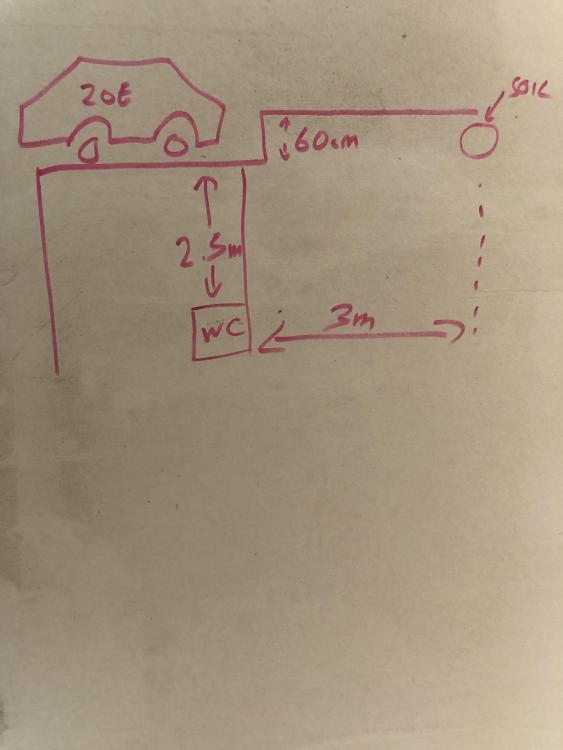

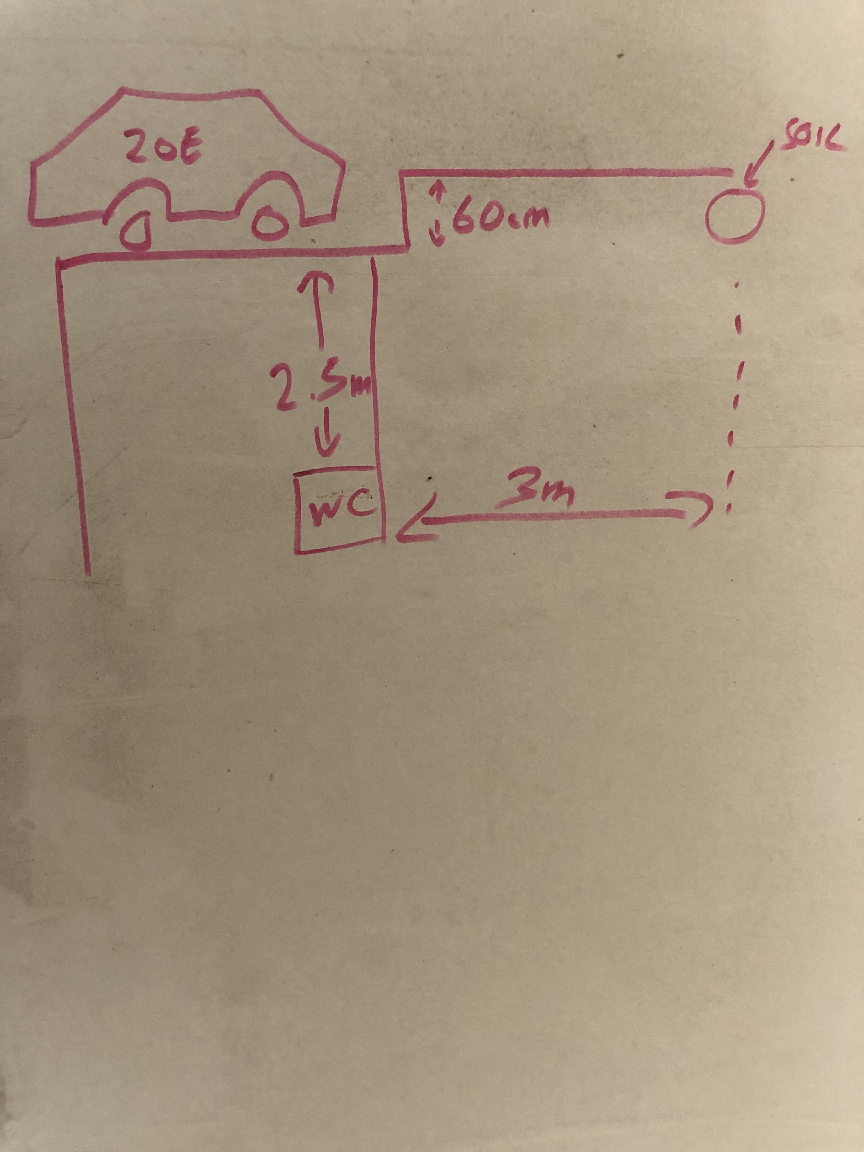

Pocster Posted March 23, 2021 Author Share Posted March 23, 2021 10 minutes ago, ProDave said: What is the constraint? Under a stairwell or something? re locate the WC to a place you can do all the UP from? EDIT: just seen the drawing. Move the WC to the right so it is under the full headroom bit? Sorry new diagram - more accurate !! Link to comment Share on other sites More sharing options...
Pocster Posted March 23, 2021 Author Share Posted March 23, 2021 To get wc so waste straight up ( I.e be above soil ) would place it in the lounge ? Link to comment Share on other sites More sharing options...

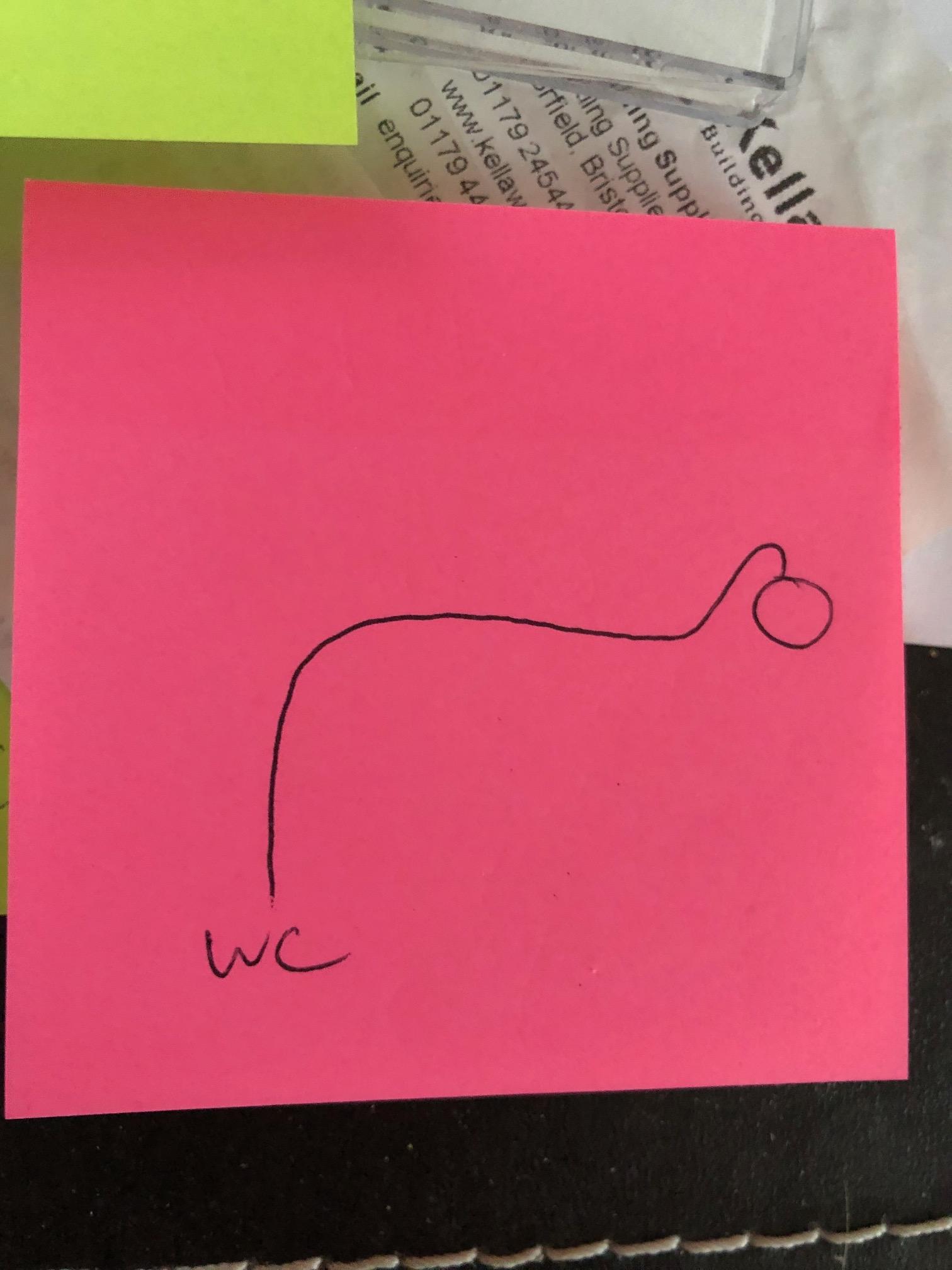

ProDave Posted March 23, 2021 Share Posted March 23, 2021 2 minutes ago, pocster said: You asking me @ProDave ( I assume not ? )? No anyone, but fancy drawing what I am trying to describe with your expert CAD skills? 1 Link to comment Share on other sites More sharing options...
Pocster Posted March 23, 2021 Author Share Posted March 23, 2021 2 minutes ago, ProDave said: No anyone, but fancy drawing what I am trying to describe with your expert CAD skills? My architect has finished for the day. His next of kin drew this.... Link to comment Share on other sites More sharing options...
