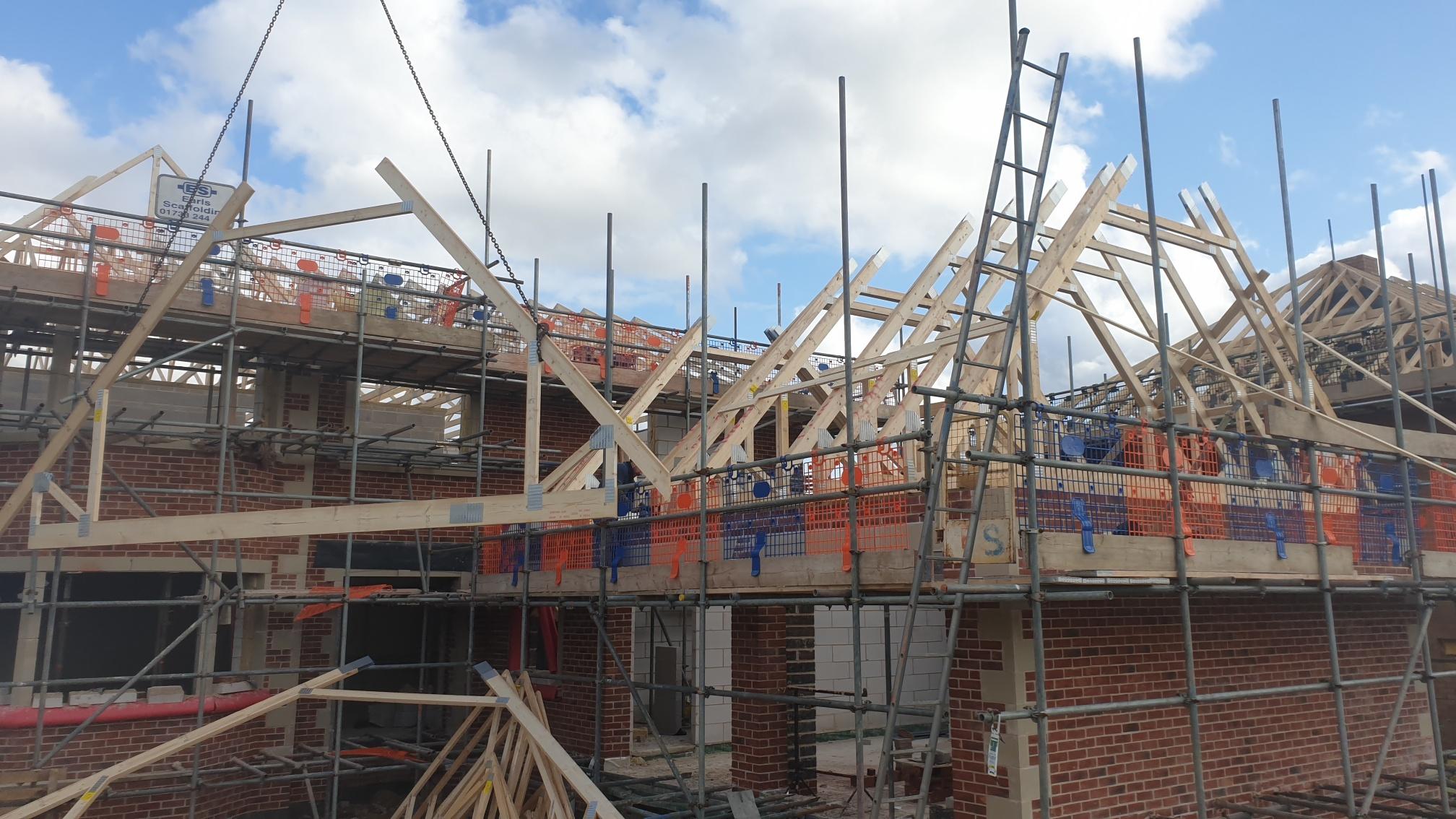

They still do it the Old School way up here (long since banished in London) - the crane drops down the T - Bar that sits in the head of the truss and off you go.  Safe and a piece of p*ss to do.
If you are stressing on your truss lift then get down here on Thursday for the circus!

If you want to see a major truss lift come down on the 25th - we are doing my Plot then - standard and attic trusses, dormers the whole show.  Booked the crane for the day but he will be off by early pm I suspect.  I will give you the crane chaps details - he is good and cheapish (bargain basement to my London eyes!).

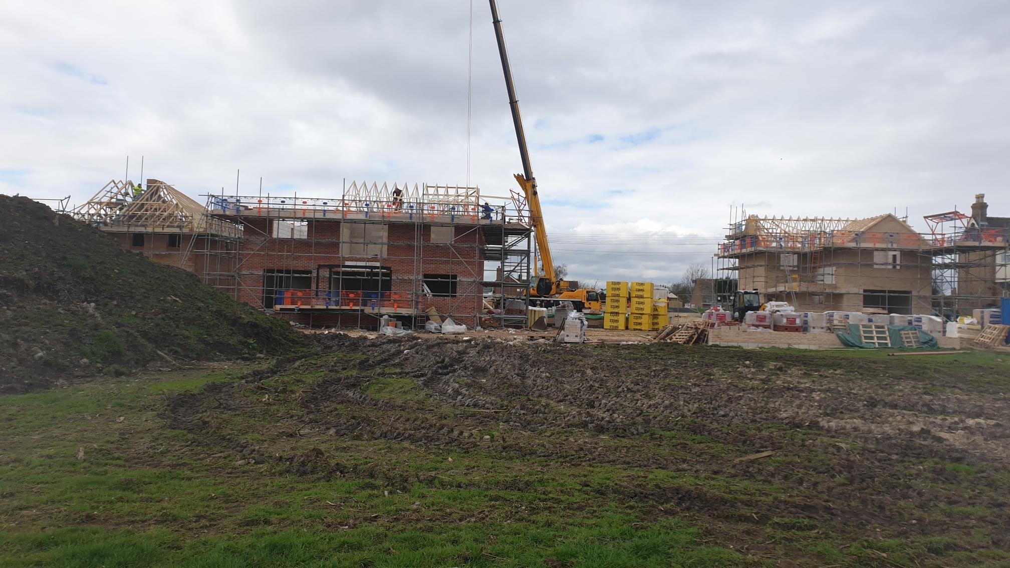

You should be fine for 1 day - I did the trusses on Plot 1 last week - the crane was gone in 2 hours.  Half day hire and job done for £400.
The issue you may have is relying on the crane to offload the delivery which could be delayed 20210318_073835_resized.thumb.jpg.830ae03abe521726dc7d6650dd592722.jpg- far better if you offload prior to the day with the forks.

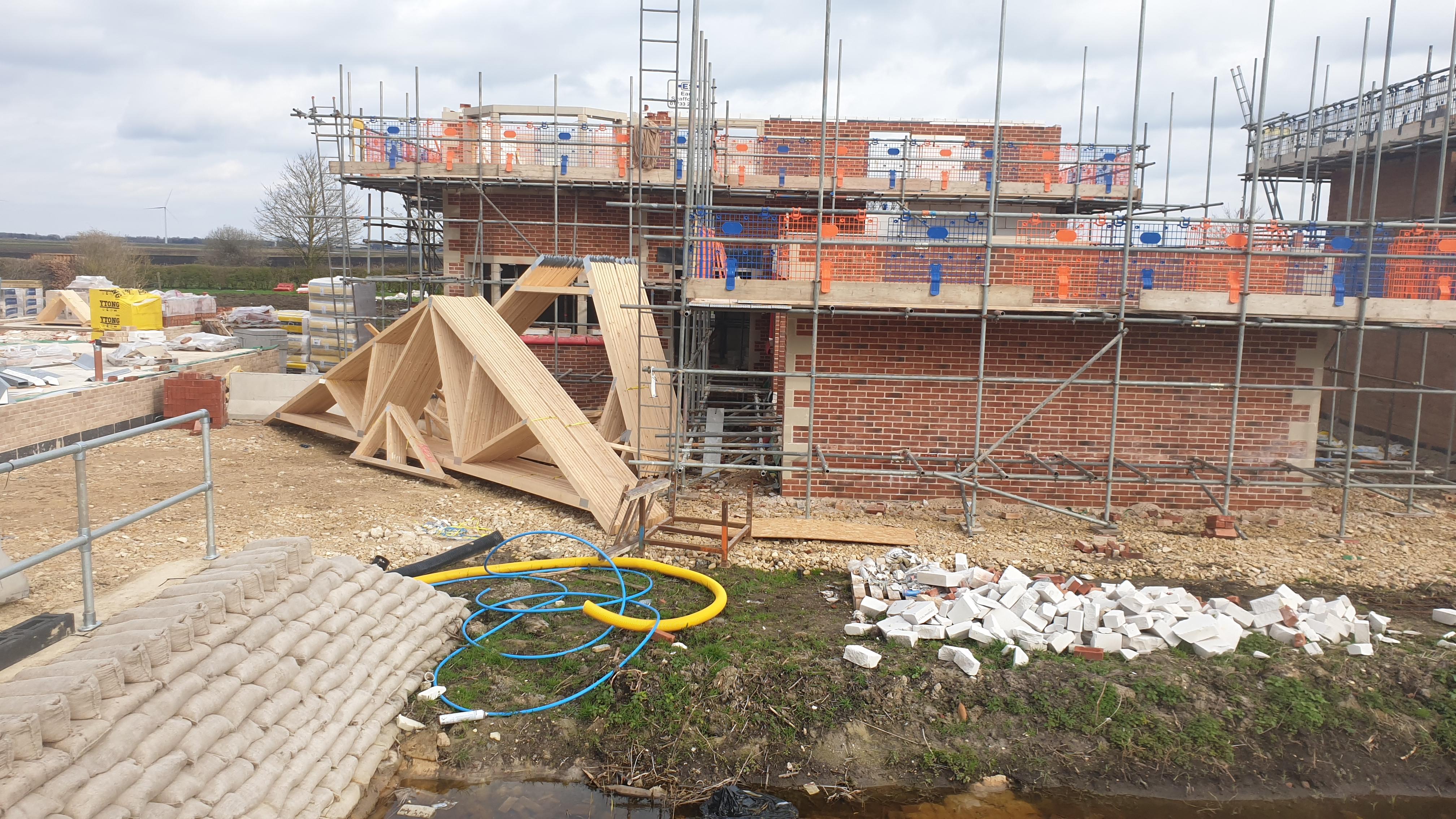

If you get the truss delivered at least a day before, wise move in my opinion, then remember to store them upright. Don't lie them flat on the ground as they will get twisted or damaged.  A pile of blocks or trees or scaffolding will be ideal.

Trusses actually are not that heavy in the scheme of things.  I took them off for my plot (3,000 sq. ft) in 2 batches - I have a JCB 535-140.
They are just awkward - had to stand down all of my heras fencing in preparation.

The one in the post earlier is 1165kg... your 140 has a max lift of 1000kg at full reach, so would be maxed on this at 7.5m as these are 15m trusses at nearly 4.5m high. The lifting points are also around 3.5m up and 2m apart so you would have to sling higher than 5m and use a spreader on the forks -  dangling a 15m long truss off the forks and moving it safely is not something I would recommend is a safe handling scenario ..!
@Buzz I would also check how these are being delivered and loaded, as some companies turn the larger trusses upside down onto the trailers so the peak fits into the well between the tractor and the wheels. You will have the issue of having to both unload and rotate the truss without damage as it will need to be stored on its bottom chord.

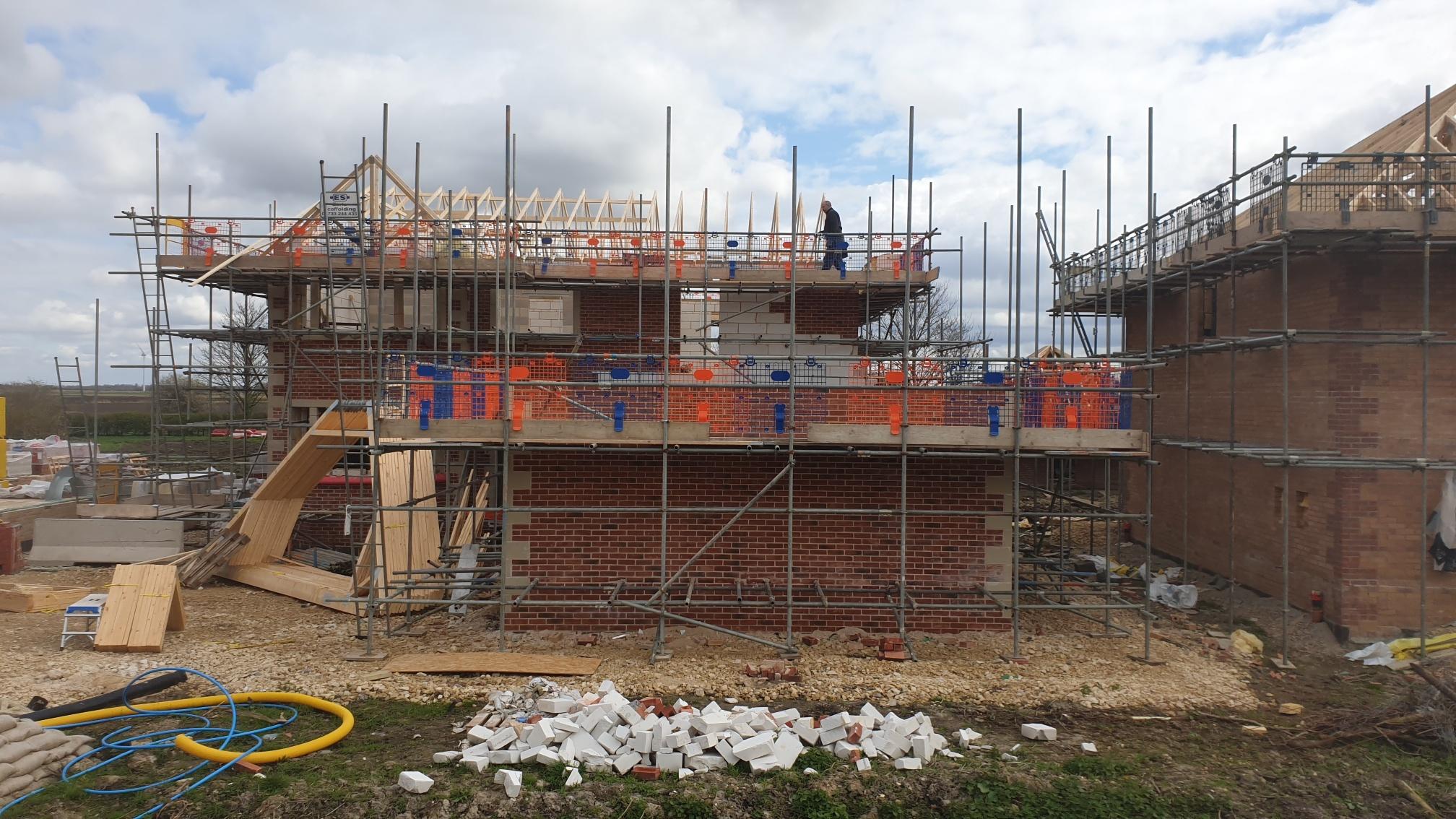

1 hour ago, Faz said:
Been on site this morning (after having the jab) and snapped a pic of my trusses. These came off in 2 hits - no need to extend much of the boom to get them off.
The ashlar quoins and window surrounds look very posh.  I look forward to seeing these completed.

In 2 minds about the quoins...
The surrounds are nice - the door head (that you can't see here) and the window ones in particular - the bay is a bit plain tbh.
The whole lot was £6k which for wet cast stone is pretty good!
