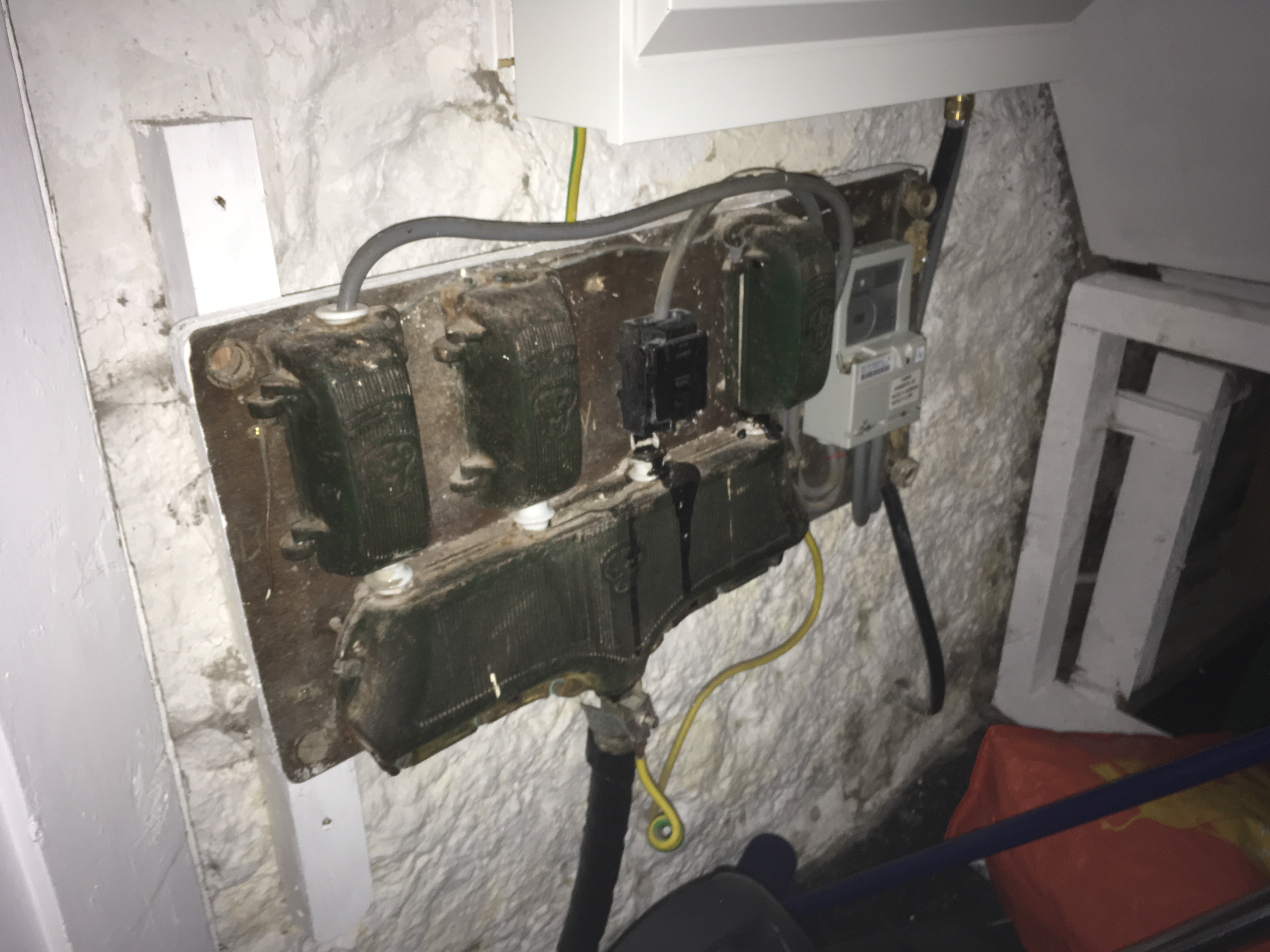

PeterW Posted February 16, 2017 Posted February 16, 2017 12 hours ago, ProDave said: .... stood off from the wall on porcelain insulators so a leak, and water running down the wall would not get into the meter and supply head. Oh how standards have slipped. You mean like this beast in the cottage we've got this week..??!

ProDave Posted February 17, 2017 Posted February 17, 2017 On 16 February 2017 at 08:24, PeterW said: You mean like this beast in the cottage we've got this week..??! Let's turn this into a "spot the fault" I'll start with pitch leaking from the head. 951 clamp on the earth (that can crush the cable resulting in a very big bang) and a SWA cable exiting the bottom of the CU with the armour not clamped at all. EICR fail for me.
