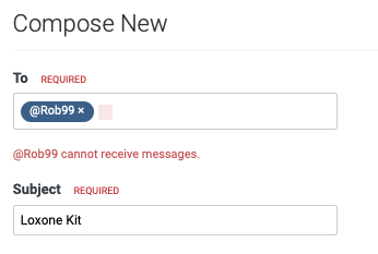

Hilldes Posted March 17, 2021 Posted March 17, 2021 Looking to buy some more Loxone kit for my build (I bought the first batch of kit for a proof of concept about 12 months back from Loxone when they still sold to non-partners). There have been a couple of pointers on here: @Rob99 allegedly can't receive IMs? Spider electrical - struggle to load the web page and when I do the email address given gets bounced. Any alternatives?

MikeSharp01 Posted March 17, 2021 Posted March 17, 2021 You don't use the @ in creating PM address just type rob99, or whatever name, and all will be well I think. 1
Hilldes Posted March 17, 2021 Author Posted March 17, 2021 3 minutes ago, MikeSharp01 said: You don't use the @ in creating PM address just type rob99, or whatever name, and all will be well I think. Thanks @MikeSharp01 message now sent successfully.

Rob99 Posted March 17, 2021 Posted March 17, 2021 58 minutes ago, Hilldes said: Thanks @MikeSharp01 message now sent successfully. Message recieved and responded to......?
