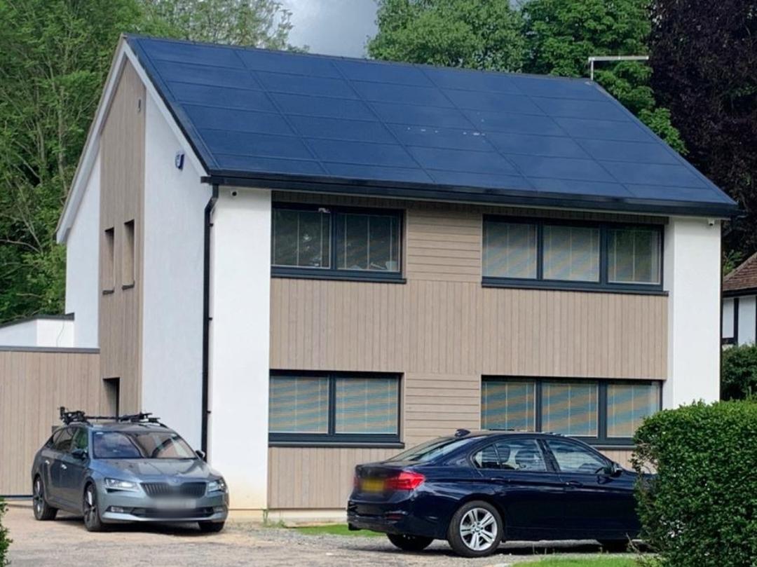

joth Posted June 13, 2021 Posted June 13, 2021 (edited) On 11/03/2021 at 12:03, ProDave said: I believe it is only financially viable if you can buy the kit cheap and install it yourself. So when is relandscaping a garden or installing a swimming pool financially viable? Things are financially viable when the purchaser has the finances available to purchase it. End of. I think you mean economically justifiable, which is not always the reason to decide to make a modification to a home. Especially those with zero payback like putting in a hot tub or enlarging the patio. To give another view - we put a whole roof of solar on our house (GB sol RIS, picture attached) cost about 16k£ but the whole enerphit+ renovation has added double the value onto our house that it cost to do, undeniably in part due to the current crazy market, but in part because interest in sustainable designed houses are suddenly on the up* in our area and nothing signals this more clearly than a whole roof of solar (in a conservation area where this was not permitted a couple years ago). This is not going to be the common case I know, but done well I do see even the economic value being more than just the reduced electric bill. * I was very surprised - the estate agents we spoke to this week knew very well what a passive House is; turns out in large part because customers are taking about ours as a reference point for the area. Edited June 13, 2021 by joth 3

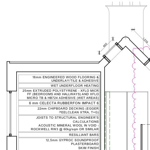

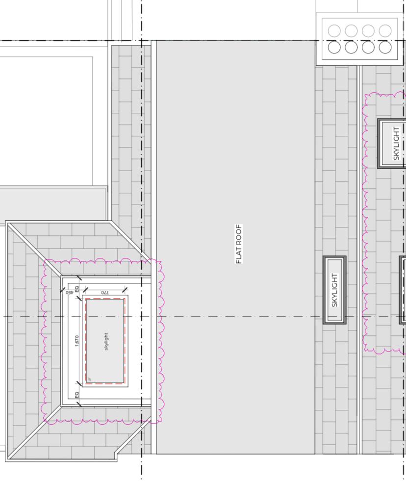

Adsibob Posted July 3, 2021 Posted July 3, 2021 (edited) 4 hours ago, SteamyTea said: You could consider putting a fall on the roof, say 15⁰, this is to let rain flow away and take the buildup of dirt with it. But you still have to be wary of shadows caused by the roof ridge, and nearby buildings. This may be a case where individual module inverters work well. A sketch would help. Thanks @SteamyTea, here are some drawings. The first drawing shows part of the roof plan. The dimensions are about 8.2m by 3.15m; I'd forgotten we had to make the dormer slightly smaller - for reasons I won't go into to). The ridge line is centred with the chimney stack (shown as a rectangle with 8 circles in it). The second drawing shows a cross section. You can see the pitch of the small piece of pitched roof between the flat roof and the ridge line is 45 degrees. But the diagonal length of that bit of roof (i.e. the hypotenuse on the cross section) is only about a metre, so I'm hoping there won't be much shading from that. Obviously the chimney stack will cause a bit of shade, but there isn't much we can do about that as we use it and it is also jointly owned by our semi detached neighbours. Edited July 3, 2021 by Adsibob
SteamyTea Posted July 3, 2021 Posted July 3, 2021 I think you would have a highly compromised PV system. You may be better off, and this may sound odd, with a ST because when the sun does hit it, they can deliver a lot of power. So may well contribute to water heating more. An ST system can be fixed at an optimal angle and will be smaller overall. Though a simple ASHP dedicated to DHW may be more cost effective overall.
