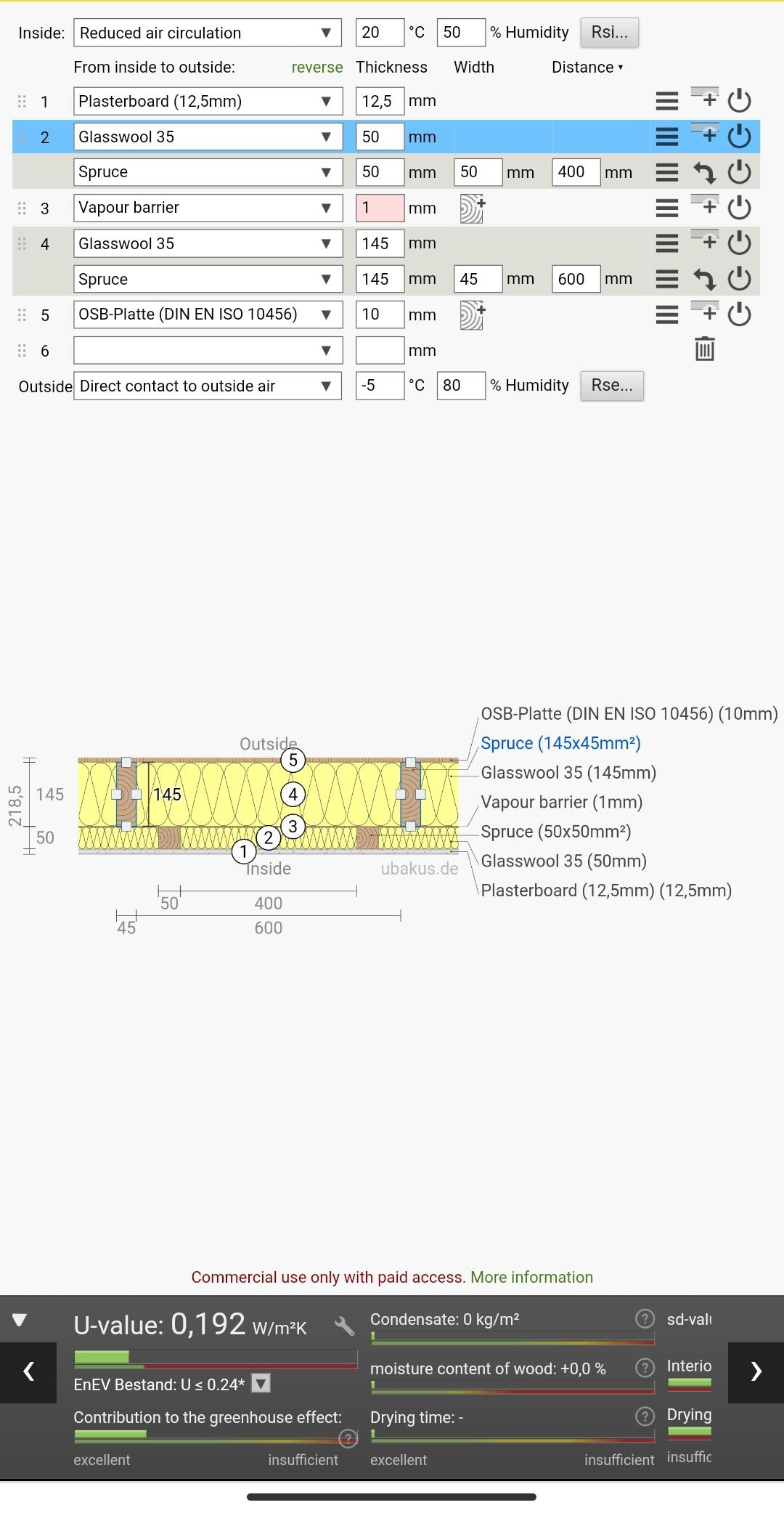

Iceverge Posted March 10, 2021 Share Posted March 10, 2021 Have a price up of the below buildup. If you're DIYing it I can't see a cheaper way. Remember increasing your insulation much beyond building regs isn't worth much unless you're taking care of thermal bridging and airtightness. Link to comment Share on other sites More sharing options...

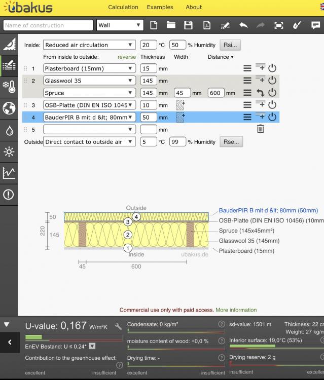

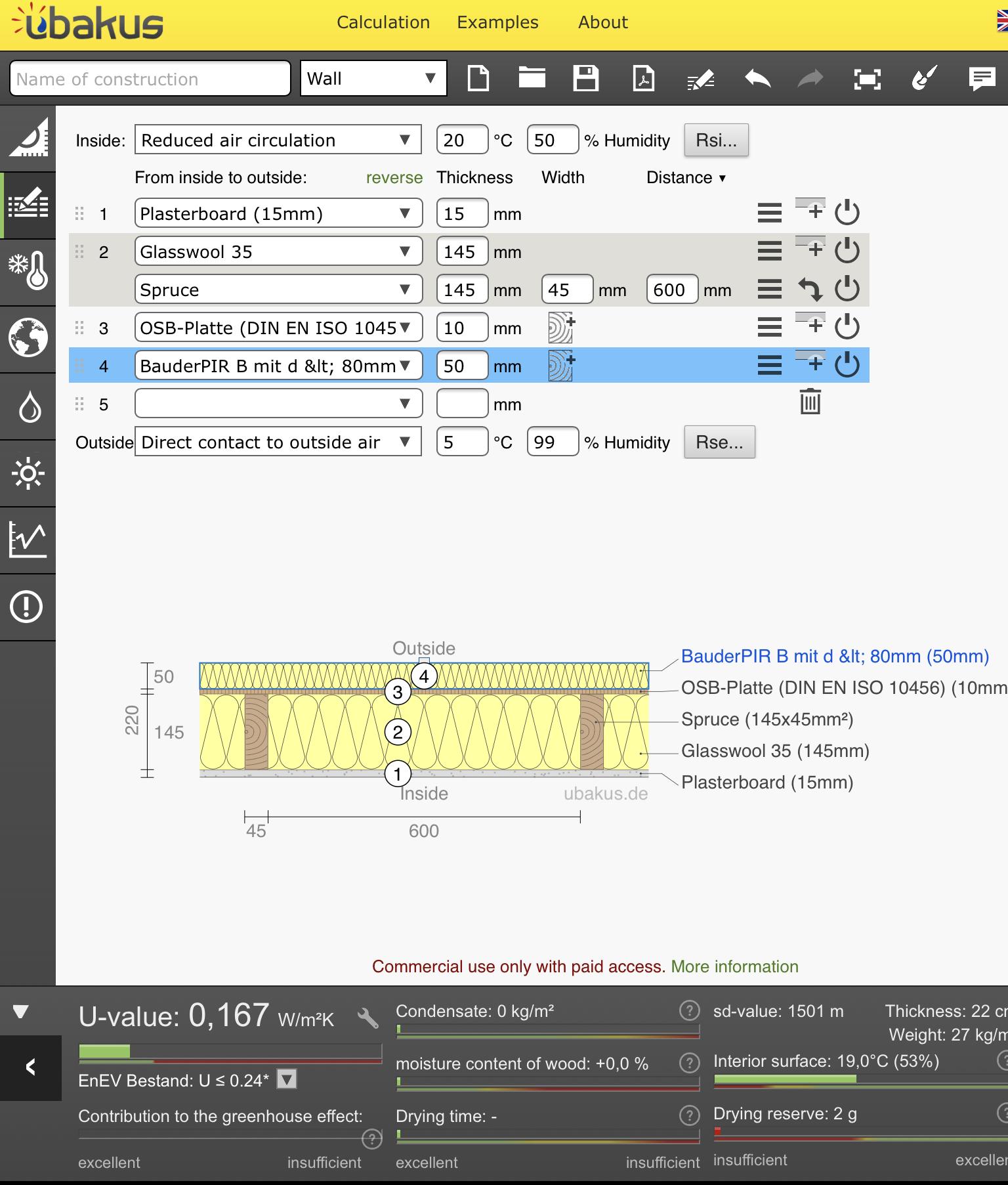

Iceverge Posted March 10, 2021 Share Posted March 10, 2021 alternatively put your continuous layer of PIR on the outside like the americans do. it leaves you a nice large stud to run wires and pipes and cuts thermal bridging at all the openings and studs. Link to comment Share on other sites More sharing options...
the_r_sole Posted March 10, 2021 Share Posted March 10, 2021 is Glasswool 35 the same as frametherm 35? I had real difficulty getting uvalues worse than about 0.17/0.18 on the walls through a sap calc recently so it really comes down to what else the op has to pass that Link to comment Share on other sites More sharing options...
the_r_sole Posted March 10, 2021 Share Posted March 10, 2021 1 minute ago, Iceverge said: alternatively put your continuous layer of PIR on the outside like the americans do. it leaves you a nice large stud to run wires and pipes and cuts thermal bridging at all the openings and studs. If you go this route, make sure you've done a detailed condensation risk analysis - there's something I always worry about by insulating between and then outside studs, you've got the structure surrounded in insulation and not giving moisture anywhere to go, it's just the same as a hybrid roof construction where you risk condensation forming on the critical bits of structure... Link to comment Share on other sites More sharing options...
Iceverge Posted March 10, 2021 Share Posted March 10, 2021 7 minutes ago, the_r_sole said: is Glasswool 35 the same as frametherm 35? I had real difficulty getting uvalues worse than about 0.17/0.18 on the walls through a sap calc recently so it really comes down to what else the op has to pass that Yup, I just picked something in that list that had a thermal conductivity of 0.035W/mK. For me SAP is a useful guide but unfortunately can mean little to the comfort of a house once built. I’d work on getting good enough U values and excellent detailing. Link to comment Share on other sites More sharing options...
the_r_sole Posted March 10, 2021 Share Posted March 10, 2021 1 minute ago, Iceverge said: Yup, I just picked something in that list that had a thermal conductivity of 0.035W/mK. For me SAP is a useful guide but unfortunately can mean little to the comfort of a house once built. I’d work on getting good enough U values and excellent detailing. SAP is a pretty blunt tool but you need to pass it before you can start building in Scotland, so it becomes a critical part of the process Link to comment Share on other sites More sharing options...
Iceverge Posted March 10, 2021 Share Posted March 10, 2021 2 minutes ago, the_r_sole said: If you go this route, make sure you've done a detailed condensation risk analysis - there's something I always worry about by insulating between and then outside studs, you've got the structure surrounded in insulation and not giving moisture anywhere to go, it's just the same as a hybrid roof construction where you risk condensation forming on the critical bits of structure... I’ve pondered this over and over and wondered why we don’t do it at this side of the atlantic. I can’t imagine that the physics change at 30deg west, although they would claim everything is bigger there! As long as you’re not trapping moisture in the wall and you’re controlling bulk water outside and humidity inside i doubt there’d ever be a problem. Link to comment Share on other sites More sharing options...

SimonD Posted March 10, 2021 Share Posted March 10, 2021 6 hours ago, Iceverge said: alternatively put your continuous layer of PIR on the outside like the americans do. it leaves you a nice large stud to run wires and pipes and cuts thermal bridging at all the openings and studs. Would you not want a vcl to the inside of those studs for this buildup? 6 hours ago, the_r_sole said: there's something I always worry about by insulating between and then outside studs, you've got the structure surrounded in insulation and not giving moisture anywhere to go That's one area breathable wall systems have the advantage although certainly not the budget option. Link to comment Share on other sites More sharing options...
