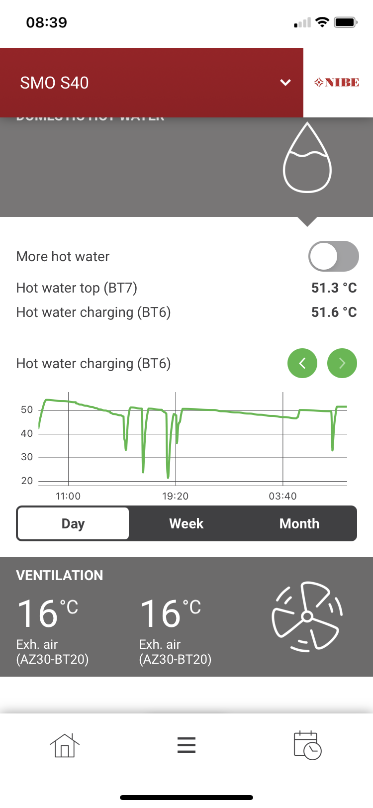

gc100 Posted March 1, 2021 Share Posted March 1, 2021 (edited) Just looked at my ASHP and the how long it takes to heat up the hot water tank (300litres) but looking that this is seems about the same as when I had a gas boiler unless I’m looking at this wrong Edited March 1, 2021 by gc100 Link to comment Share on other sites More sharing options...
