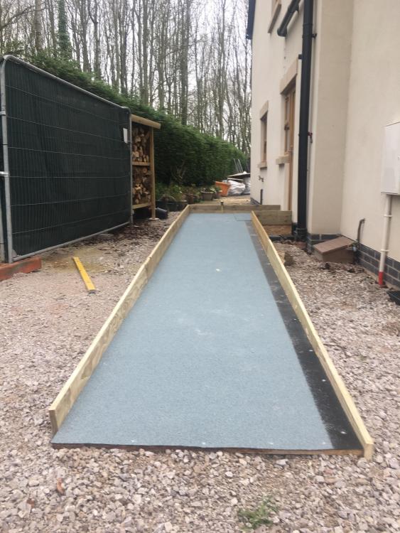

gc100 Posted February 21, 2021 Posted February 21, 2021 Hi, So building control have been around to give me a list of all the things I need to do before completion. One of the items is a ramp up to the front door for wheelchair /general access as the door is currently about 2.5 feet above the original land . Now I have a LOT of landscaping to do but it will take a long time and things need to be done in a certain order. The whole area in front of the frontdoor and garage (which is next to it within the building) needs to be built up and landscaped but I cannot do that until I sort out the rear of the house other wise I cannot get good access with heavy machinery. I really want to get the house signed off within the next 3 months incase HMRC try and reject my VAT reclaim because we are living there. Talking to BC the entrance ramp/access needs to be permanent and the finished article. But logistically I cannot do that for at least 6 months if not more. I asked if I could built up a hardcore bank/slope but he seemed to think that was not acceptable so I need to surface it as well. (He wasn't bothered about access to garage or any other landscaping.) Whatever I do, I will need to pull up and redo the whole area as part of landscaping and then put down the final surface in one go (including access to garage and drive). Does anyone have any suggestions that would be quick and cheap to implement?

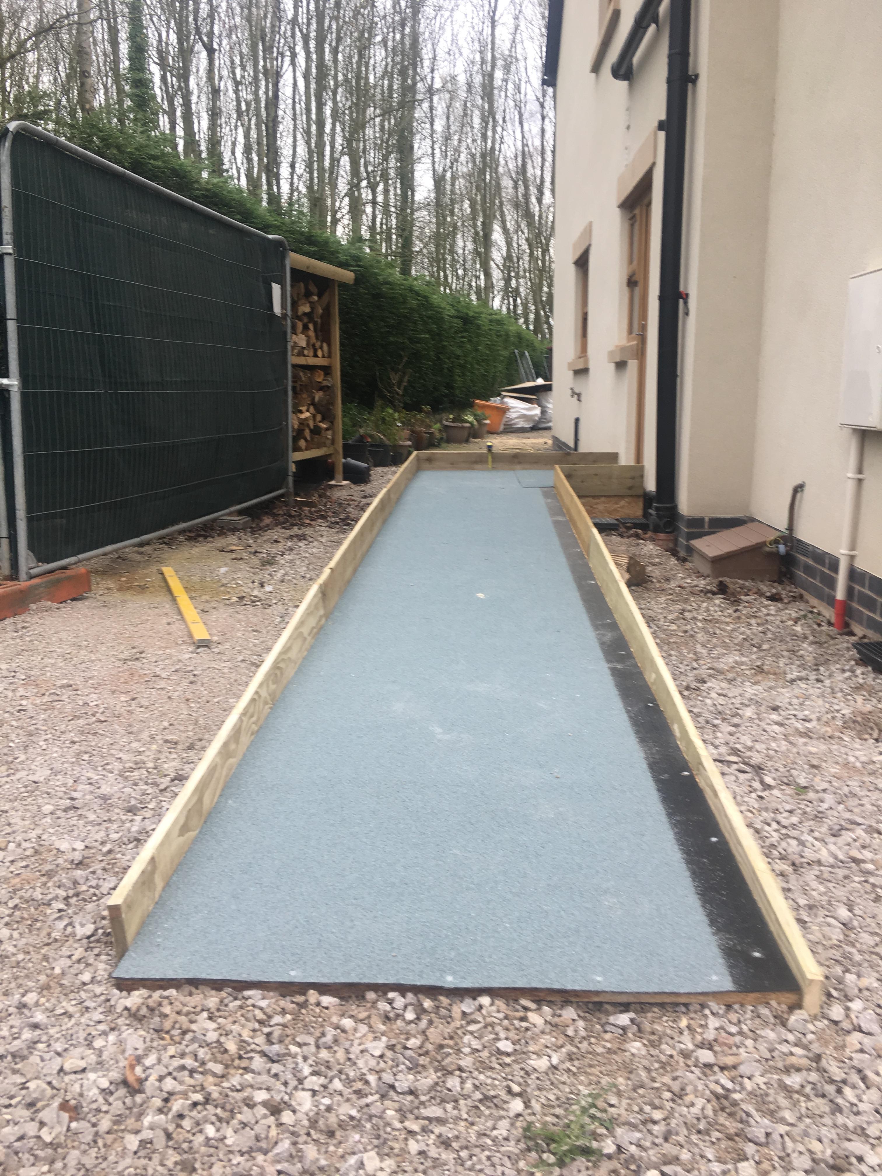

gc100 Posted February 21, 2021 Author Posted February 21, 2021 Just now, nod said: Quite a lot of us have been in the same situation While the house is bang on the drive and landscaping is nowhere near This what I made Exact dimensions and fall with a 1200 LEVEL platform LA Were quite happy to sign off with a foot note saying Adequate TEMPORARY disabled access ramp I asked about a wooden ramp and he said no way as it can be removed. Obviously your BC are more flexible than mine!

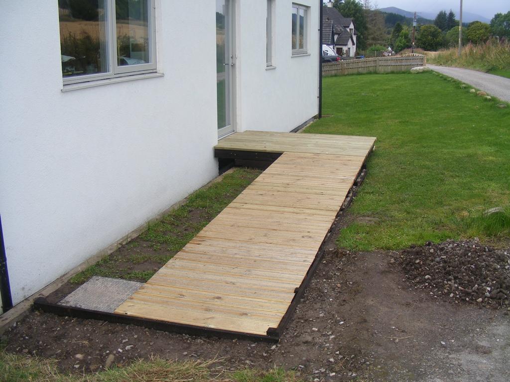

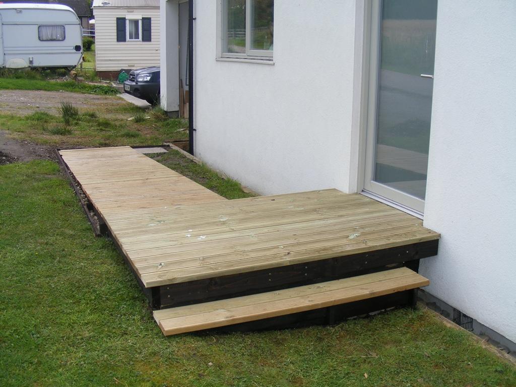

ProDave Posted February 21, 2021 Posted February 21, 2021 I have a permanent wooden ramp created with concreted in posts, treated timber joists and wooden decking. The decking planks used on the sloping part are the non slip ones with a non slip material embeded in 2 of the grooves of each plank. BC seem to have accepted this.
nod Posted February 21, 2021 Posted February 21, 2021 10 minutes ago, gc100 said: I asked about a wooden ramp and he said no way as it can be removed. Obviously your BC are more flexible than mine! I quoted the regs to him and he brought his boss down From memory it says something like Preferably or ideally concrete or Asphalt Both conceded that as long as it wasn’t removable (Both tried) and the gradient was correct Also nonslip It would be fine His boss suggested bumpers on the level platform We used LA so won’t be swayed like many private companies I do hate it when BC state there preference rather than sticking to there own rules
nod Posted February 21, 2021 Posted February 21, 2021 6 minutes ago, ProDave said: I have a permanent wooden ramp created with concreted in posts, treated timber joists and wooden decking. The decking planks used on the sloping part are the non slip ones with a non slip material embeded in 2 of the grooves of each plank. BC seem to have accepted this. Love it No bumpers ? I think the bumper thing was a way of telling me that I was only half right
gc100 Posted February 21, 2021 Author Posted February 21, 2021 2 minutes ago, nod said: I quoted the regs to him and he brought his boss down From memory it says something like Preferably or ideally concrete or Asphalt Both conceded that as long as it wasn’t removable (Both tried) and the gradient was correct Also nonslip It would be fine His boss suggested bumpers on the level platform We used LA so won’t be swayed like many private companies I do hate it when BC state there preference rather than sticking to there own rules Thanks nod. Interesting - however if it states 'not removable' surely a wooden ramps remove-able so why did they allow it?
ProDave Posted February 21, 2021 Posted February 21, 2021 Nobody mentioned bumpers to me. I did wonder if they would want a handrail up the left hand side, closest to the house where the drop off is higher, but that only seems to be a requirement if the drop is greater than 600mm. The only comment they made if for completion they expect the detail at the bottom of the ramp to be correct, That part f the driveway is not finished yet and at the moment there is a bit of a step at the end of the rap, that has to be a level transition. Easy to fix.

nod Posted February 21, 2021 Posted February 21, 2021 1 minute ago, gc100 said: Thanks nod. Interesting - however if it states 'not removable' surely a wooden ramps remove-able so why did they allow it? I don’t think it even says that I think it was his way of putting me in my place In any case it was far to Harvey to move and I had anticipated this and knocked two stakes in and screwed the Bearers to them before boarding
gc100 Posted February 21, 2021 Author Posted February 21, 2021 1 minute ago, nod said: I don’t think it even says that I think it was his way of putting me in my place In any case it was far to Harvey to move and I had anticipated this and knocked two stakes in and screwed the Bearers to them before boarding Thanks. I'm going to find the guidance on this and see what it says exactly. I could concrete the posts in as well with postcrete which would be super quick and definitely make it more permanent/hard to remove on the face of it.

Barryscotland Posted February 25, 2021 Posted February 25, 2021 On 21/02/2021 at 09:11, ProDave said: I have a permanent wooden ramp created with concreted in posts, treated timber joists and wooden decking. The decking planks used on the sloping part are the non slip ones with a non slip material embeded in 2 of the grooves of each plank. BC seem to have accepted this. Your lucky if you got away with that. We had shown Access ramp down to gravel driveway with gravel grids forming a path to a parking space and a path to the main footpath out side the drive using a different type of gravel on the gravel panels to show the solid footpaths but building control wouldn't accept it so now have a maze of paving slabs footpaths to put in. Maybe Scotlands regs are different in the disabled access area
ProDave Posted February 25, 2021 Posted February 25, 2021 1 hour ago, Barryscotland said: Your lucky if you got away with that. We had shown Access ramp down to gravel driveway with gravel grids forming a path to a parking space and a path to the main footpath out side the drive using a different type of gravel on the gravel panels to show the solid footpaths but building control wouldn't accept it so now have a maze of paving slabs footpaths to put in. Maybe Scotlands regs are different in the disabled access area They have accepted the ramp but not the detail where it ends (to be fair there is a big step there at the moment) Eventually that will be tarmac, when we get around to it and can afford it. It is likely I will try for completion with iy just being gravel and levelled out. Plenty of houses here have concrete ramps ending at gravel and are passed.
Barryscotland Posted February 25, 2021 Posted February 25, 2021 2 hours ago, ProDave said: Plenty of houses here have concrete ramps ending at gravel and are passed. Is there a set of guidelines UK wide or is it different rules Council to Council as its one point I would argue if there was a chance of winning it. The way PKC want it I am going to be driving over two paved paths to get to my parking area which wont survive long if I take a truck home. Tar mono block etc are not an option due to cost.
