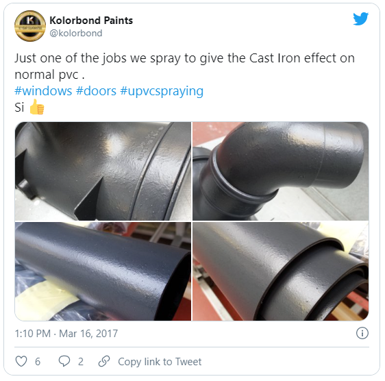

MortarThePoint Posted February 20, 2021 Share Posted February 20, 2021 I've costed up the guttering etc in three different types. I had a full quote for it in Aluminium which was just over £4k, of which 54% was gutters and downpipes so I am scaling the other options on that basis. [NB: 84m guttering and 51m downpipe] Aluminium: inc. 125mm gutters, 76mm downpipes - £4,080 Brett Martin Cast Iron Effect: inc. 112mm gutters and 68mm downpipes - £1,936 FloPlast Cast Iron Effect: inc. 112mm gutters and 68mm downpipes - £1,319 Standard FloPlast: inc. 112mm gutters and 68mm downpipes - £341 It's amazing to see a factor of >10 in the price. On ScrewFix someone wrote in a review of the FloPlast cast iron effect: "This is standard plastic gutter that has been painted with a matt black textured paint to make it look like cast iron." I am tempted to have a go with some textured spray paint and see if I can make something that looks decent. Paint isn't ideal, but if that's what the FloPlast is then same compromise. I'm happy with black but my wife is set against it so painting may be the only option anyway. Is the Brett Martin cast iron effect moulded texture or painted as well? The big cost difference from FloPlast with Brett Martin is the cost of the downpipes as they look to have a connector moulded on. 1 Link to comment Share on other sites More sharing options...

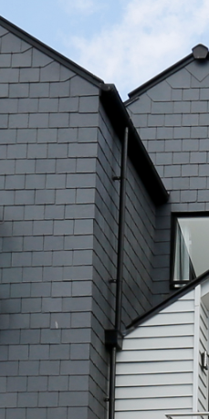

MortarThePoint Posted February 20, 2021 Author Share Posted February 20, 2021 30 minutes ago, Oz07 said: The ally does look good but it's impossible to justify the price if you've got an eye on selling in future unless it's a super premium home. Think @Russell griffiths used something posh? I do think it looks good with light coloured timber cladding, but personally I prefer something darker with brickwork. Link to comment Share on other sites More sharing options...
MortarThePoint Posted February 20, 2021 Author Share Posted February 20, 2021 (edited) I saw this which looks pretty good: Edited February 20, 2021 by MortarThePoint Link to comment Share on other sites More sharing options...
Oz07 Posted February 20, 2021 Share Posted February 20, 2021 Looks foreign to me Link to comment Share on other sites More sharing options...
MortarThePoint Posted February 20, 2021 Author Share Posted February 20, 2021 Made in the UK apparently. Here's a video of samples: https://www.facebook.com/PVCPAINTING/videos/757936784356603/ Link to comment Share on other sites More sharing options...

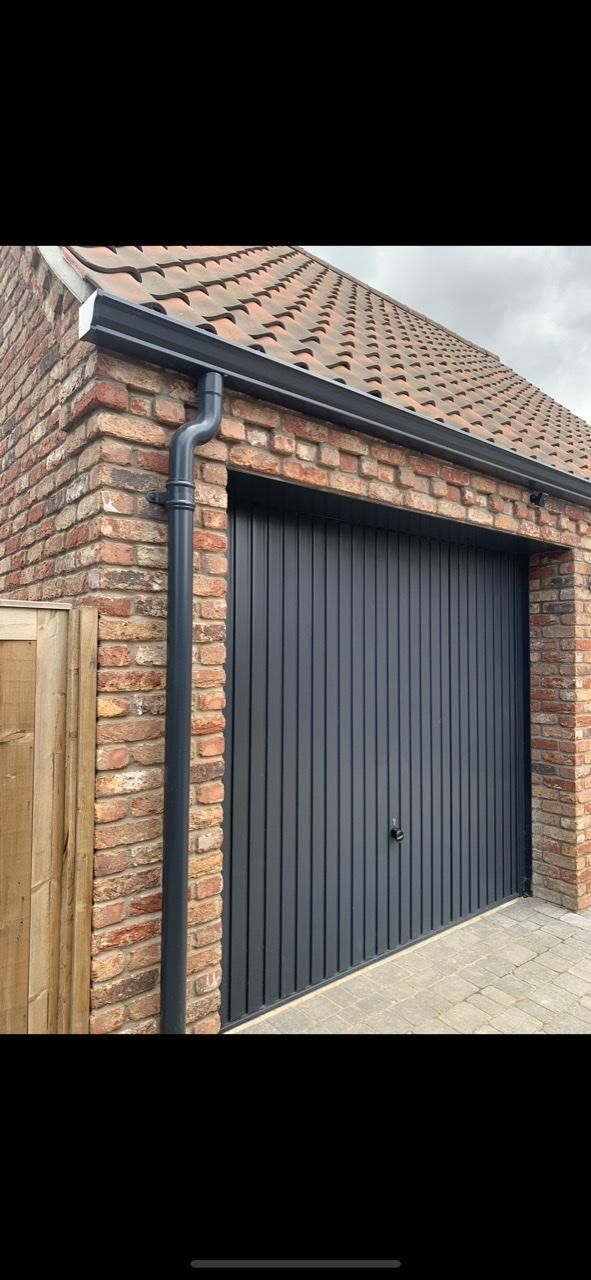

Mr Punter Posted February 20, 2021 Share Posted February 20, 2021 3 hours ago, MortarThePoint said: Is the Brett Martin cast iron effect moulded texture or painted as well? The big cost difference from FloPlast with Brett Martin is the cost of the downpipes as they look to have a connector moulded on. I used the Brett Martin placcy cast iron on a project but not sure it was worth the extra: I quite like the Guttercrest ali stuff we did below: Next project will be grey plastic. 1 Link to comment Share on other sites More sharing options...

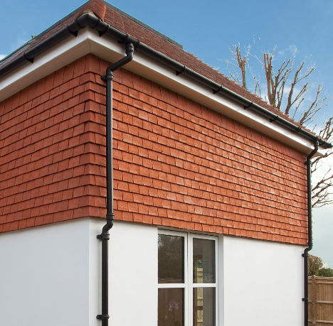

GaryM Posted February 20, 2021 Share Posted February 20, 2021 I'm putting up galvanised roofart gutters, just be careful how you pronounce it. 1 Link to comment Share on other sites More sharing options...

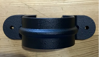

MortarThePoint Posted February 20, 2021 Author Share Posted February 20, 2021 2 hours ago, Mr Punter said: I used the Brett Martin placcy cast iron on a project but not sure it was worth the extra: That does look very smart. It's mainly the brackets on the down pipes that look so good. I found these which look good, but not quite as good as where the BM downpipe sections meet: Link to comment Share on other sites More sharing options...
Dave Jones Posted February 22, 2021 Share Posted February 22, 2021 Lindab make some stunning galv guttering, available in any RAL colour. http://www.lindab.com/global/pro/categories/pages/rainwater-systems.aspx 1 Link to comment Share on other sites More sharing options...
