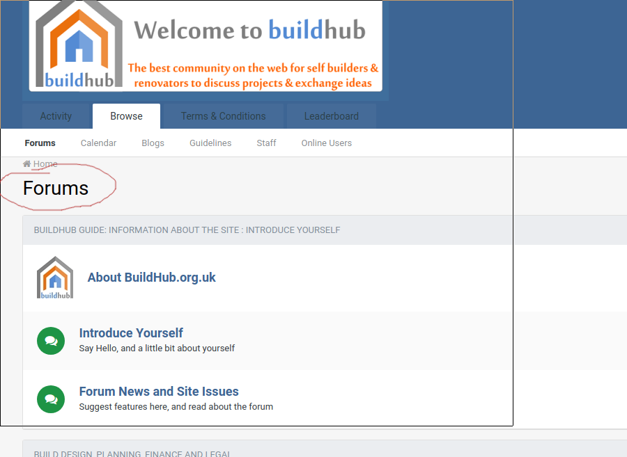

ProDave Posted February 20, 2021 Share Posted February 20, 2021 46 minutes ago, Greenbot said: Indeed... I'm sure that's a rhetorical statement the forum we're on is for renewables, but obviously the answer is for the sake of sustainability and air pollution ? Not really, this is primarily a self build forum where we discuss all aspects of buildings and renovations. Nobody is going to demonise you for using a gas boiler because that is what works best. i have a particular concern that there are companies out there "selling" ASHP systems on the back of grants, and then sometimes installing something that is not up to the job, may not heat the house properly, or simply costs too much to run. All very well being "green" and accepting that doing so may cost you more money. Link to comment Share on other sites More sharing options...
joth Posted February 20, 2021 Share Posted February 20, 2021 1 hour ago, ProDave said: 2 hours ago, Greenbot said: Indeed... I'm sure that's a rhetorical statement the forum we're on is for renewables, but obviously the answer is for the sake of sustainability and air pollution ? Not really, this is primarily a self build forum where we discuss all aspects of buildings and renovations. Nobody is going to demonise you for using a gas boiler because that is what works best. I think it was a reference to the sub-forum this is posted in, i.e: "Environmental, Alternative & Green Building Methods >> Renewable Home Energy Generation >> Air Source Heat Pumps (ASHP)" (Yes, each of the categories are called "Forums" . all inside "the" forum, confusing) Link to comment Share on other sites More sharing options...
