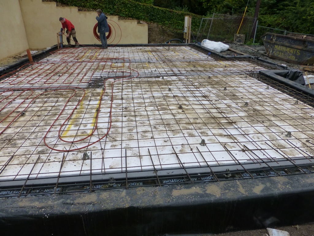

Pocster Posted February 9, 2017 Author Share Posted February 9, 2017 Ah I was going to say stud walls. So I would need to somehow mark out these areas and run the UFH around them. Once the screed is poured though; how can I be sure (whilst drilling into the floor!!!) I'm not going to hit a UFH pipe? Link to comment Share on other sites More sharing options...

Russell griffiths Posted February 9, 2017 Share Posted February 9, 2017 44 minutes ago, pocster said: Ah I was going to say stud walls. So I would need to somehow mark out these areas and run the UFH around them. Once the screed is poured though; how can I be sure (whilst drilling into the floor!!!) I'm not going to hit a UFH pipe? Have a chat with the ufh guy, I have the same problem spinning in my head. My thoughts are that if a pipe was 150 mm from the face of an internal wall on both sides you would have a gap of 300mm plus width of wall between pipes. If your setting out is ok I would think that's loads of room to get the wall in the middle Link to comment Share on other sites More sharing options...

Jeremy Harris Posted February 9, 2017 Share Posted February 9, 2017 52 minutes ago, pocster said: Ah I was going to say stud walls. So I would need to somehow mark out these areas and run the UFH around them. Once the screed is poured though; how can I be sure (whilst drilling into the floor!!!) I'm not going to hit a UFH pipe? Here's a photo showing the yellow lines marked out before the slab was poured, showing where all the walls, kitchen units etc were going to go. This is from the Kitchen end, and the square is the kitchen island: And this is from the other end, showing where a a stud wall is going to go, with the pipes laid either side of it: Link to comment Share on other sites More sharing options...

Pocster Posted February 10, 2017 Author Share Posted February 10, 2017 So does no one fix (somehow) markers at the corners of each non UFH floor section that protrude up through the screed?? I definitely want to do this; so no guessing when fixing to the floor Link to comment Share on other sites More sharing options...
Jeremy Harris Posted February 10, 2017 Share Posted February 10, 2017 1 hour ago, pocster said: So does no one fix (somehow) markers at the corners of each non UFH floor section that protrude up through the screed?? I definitely want to do this; so no guessing when fixing to the floor If you have plans and choose a good reference that isn't going to move, then you can just use measurements to find the safe zones. That's all I did. The guys laying the UFH had the same plans that I had, so it was easy to just chalk on the floor where the pipes were. Having loads of photos helped a lot too. Link to comment Share on other sites More sharing options...
Pocster Posted February 10, 2017 Author Share Posted February 10, 2017 Sure. I just "worry" that it takes just the 1 mistake (cm either way) and it's a problem. Link to comment Share on other sites More sharing options...
Jeremy Harris Posted February 10, 2017 Share Posted February 10, 2017 If the pipes are at least, say, 100mm clear of anything, then it's not that likely that you'd make an error big enough to go through one. I think we allowed around 400mm clear zones where the stud walls were going, for example, so there was a fair bit of leeway for small errors. Link to comment Share on other sites More sharing options...

Pocster Posted February 10, 2017 Author Share Posted February 10, 2017 I'm sorry to hear that IanR ; but that's exactly my point! You'll measure from a wall and keep a note of it. Then when you need to drill down; you have the measurement but the wall may of been boarded or skimmed anything ; then it's guess time!!! No; I'm going to find something I can stick in the floor insulation next to the UFH pipework to denote a UFH free area!. Once I'm floor tiling I'll then measure from finished wall to point; so there's some accuracy . Also will take a photo ; and make a note of which tile the edge of the UFH was at. Perhaps spray permanent paint on tiles that have no UFH beneath them!; just to be safe Link to comment Share on other sites More sharing options...
NSS Posted February 10, 2017 Share Posted February 10, 2017 Why not tie a tie wrap to the extremities of the pipes runs and leave the end poking up through the screed. If you used them then to mark the free areas after the floor has been laid you can then cut them off. Link to comment Share on other sites More sharing options...
