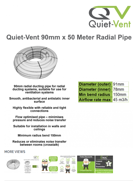

Iceverge Posted February 21, 2021 Share Posted February 21, 2021 Another self design here. We only doubled the pipe to the kitchen extract. Recommended maximum air flow velocity is 2.5m/s. In theory we’re above this in our bedroom but unless it’s on boost you can’t hear it. If you have plenty space it might be easier to use 90mm ducting than doubling up. Link to comment Share on other sites More sharing options...
Dreadnaught Posted February 21, 2021 Author Share Posted February 21, 2021 17 minutes ago, Iceverge said: If you have plenty space it might be easier to use 90mm ducting than doubling up. Thanks @Iceverge. When you say 90mm is that the external dimension? And internal would be 75mm? Is that right? 2.5 m/s noted, thanks. I am thinking of using Ubbink Air Excellent System, which 90/75 duct and even higher capacity one that is semi-rectangular in various sizes. Ubbink has good data on their website for each component showing volumes, flow rates and pressures, which are very hopeful. I have calculated my room sizes on-the-back-of-an-envelope, which has been helpful in deciding on duct numbers and sizes. For example, I have quite a large living room and was thinking of putting two supply outlets, each with two 90mm ducts attached. Four ducts in total. Running the numbers showed that a single 90mm duct to each of the two outlets would be fine but, conversely, one single outlet with two ducts attached would have been border-line noisy. 1 Link to comment Share on other sites More sharing options...

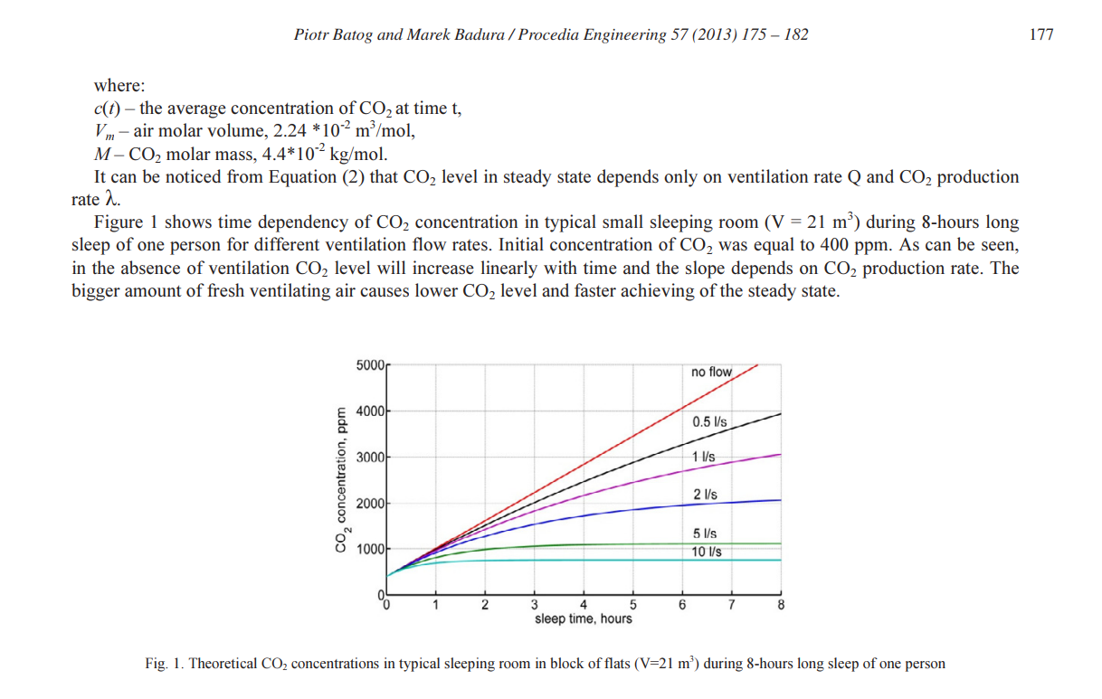

Iceverge Posted February 21, 2021 Share Posted February 21, 2021 3 hours ago, Dreadnaught said: Thanks @Iceverge. When you say 90mm is that the external dimension? And internal would be 75mm? Is that right? Start your design at your bedrooms. Bedrooms are the most limiting rooms for ventilation for 2 reasons. 1.They are the most noise sensitive 2. When occupied the doors are closed and air mixing with other rooms is limited. CO2 levels need to be controlled to ensure good health. As per the above graph 5l/s per person will keep CO2 levels acceptable. I worked on the principle that maximum bedroom occupancy would be 2 individuals or 10l/s. Every meter of 75/63mm ducting contains 3.12 litres of air so at 10l/s in our master bedroom our design velocity is 3.2m/s. It is above the recommended 2.5m/s but I followed Jeremy Harris's notes about noise where he suggested that it was almost exclusively caused by the MVHR unit itself and the room terminals. From my experience I would agree. Even at boost (4.5m/s) there is little duct noise. As long as you take care to have straight duct runs in the vicinity of bedrooms 2.5m/s is very conservative. More important is to consider your choice of MVHR unit. The passivhaus component database is the only independent comparison of noise I could find. https://database.passivehouse.com/en/components/list/ventilation_small Important also is how the unit is mounted. If it is in the attic it needs to be physically isolated from lightweight structures like ceiling joists. Either by hanging form the rafters or using acoustic mounts. Alternatively mount it on an external wall or on the floor of a plant room. Another thing to consider is the location of external vents. Don't put them near bedroom windows. I used flexible acoustic silencers from BPC ventilation on both the extract and supply sides of the unit. They were cheap and cheerful and I don't know how well they perform. @joe90 diy foam lined distribution boxes may well outperform them. I only doubled up on the 75/63mm ducting for the kitchen extract. Through experimentation i found that the maximum a 63mm duct could transfer without restricting any other outlets was about 5.1m/s or 16l/s. Again just using this trial case the noise was primarily from the terminal and the MVHR unit. TLDR. I used 75/63mm everywhere. Only doubling up for the kitchen. We have no issued with duct noise or air volume restrictions but were careful to have straight short duct runs and shallow bends only. If I was to reduce noise further I would probably install a larger volume acoustic silencer first. Then possible upgrade the MVHR unit to a quieter model. P.S on positioning rooms terminals. Aim to have them: 1.Across the room from the door. ( not vital if you can't manage it ) 2. Where high furniture won't obstruct them ( over a window works well) 3. Not over a bed or other occupied area where drafts might be noticed. 2 1 Link to comment Share on other sites More sharing options...
Russell griffiths Posted February 21, 2021 Share Posted February 21, 2021 @Dreadnaught check prices carefully, the funny rectangular duct is painfully expensive compared to round. Also read the adverts carefully some prices look similar but the rectangular comes in 25m rolls and the round in 50m i bet a few people have been caught out with that one. 1 Link to comment Share on other sites More sharing options...

Dreadnaught Posted February 21, 2021 Author Share Posted February 21, 2021 37 minutes ago, Iceverge said: As per the above graph 5l/s per person will keep CO2 levels acceptable. I worked on the principle that maximum bedroom occupancy would be 2 individuals or 10l/s. I read your reply with care. Really interesting and highly relevant. Thank you very much. Regarding doubling ducts, what about pressure as well as noise from turbulence from within the pipes. For all longer runs, wouldn't doubling ducts also reduce pressure, which in turn would reduce how hard the fans need to work, which I turn could would reduce noise from the appliance itself. Any merit in such reasoning too? And given that ducting is not a big cost in the overall costs, suggest doubling long runs as a matter of course? 2 minutes ago, PeterW said: Domestic Ventilation Guide Oh yes, I forgot about that document. Thanks for the reminder. Link to comment Share on other sites More sharing options...
