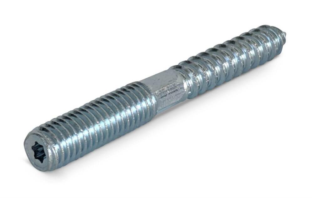

Onoff Posted February 15, 2021 Posted February 15, 2021 3 hours ago, PeterStarck said: If it's threaded with a point on the end it's a screw, without a point it's a bolt. Machine screws! (Haven't got a point).
