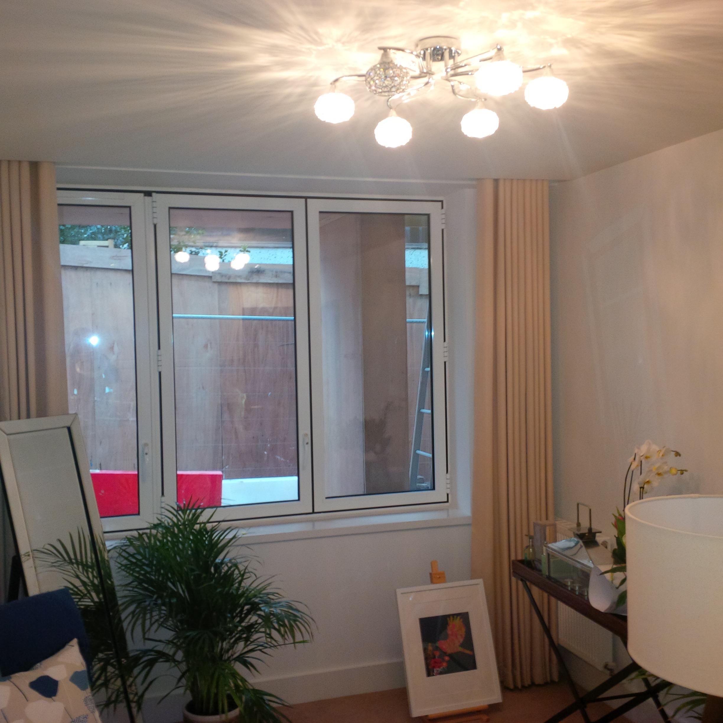

Water Posted February 13, 2021 Posted February 13, 2021 Hi all, It's never a smooth ride with this self build stuff is it, I've been to site today and there has been a bit of a cock up somewhere and now one window goes all most all the way to the ceiling. I'm trying to work out what went wrong as it was suppose to have 15cm between the window and the ceiling. However it is what it is and does anyone have any ideas on how I can make this look good? Hanging a curtain pole will be impossible, I wasn't specing blinds throughout either. ARGH! https://photos.app.goo.gl/iaqhVXfhmu6JDPiW8 It isn't possible to move the window head lower, it needs to be the level it is. Lifting the ceiling up I think will be very expensive, the first fix has been done and there is a room in the loft. Thanks all
nod Posted February 13, 2021 Posted February 13, 2021 Quite a few of the show homes are fixing the curtain rail to the ceilings Look good
nod Posted February 13, 2021 Posted February 13, 2021 1 minute ago, Temp said: Fix curtain pole to the ceiling. Plus one ?

PeterW Posted February 13, 2021 Posted February 13, 2021 Just install SilentGliss track before you plaster the ceiling - it is fitted flush so you don’t see it. https://www.tracks-direct.com/silent-gliss-6243 1
Big Jimbo Posted February 13, 2021 Posted February 13, 2021 1 hour ago, PeterW said: Just install SilentGliss track before you plaster the ceiling - it is fitted flush so you don’t see it. https://www.tracks-direct.com/silent-gliss-6243 Just had a look at that Peter. I can imagine that would look good sitting flush with the ceiling.
PeterW Posted February 13, 2021 Posted February 13, 2021 Looks really nice - not cheap but when has anything like that been cheap..??! ? Gets used in a lot of commercial builds for blinds. Search wave blinds or wave curtains

Faz Posted February 14, 2021 Posted February 14, 2021 Or you can create a recess for the curtain track in the ceiling. 1
