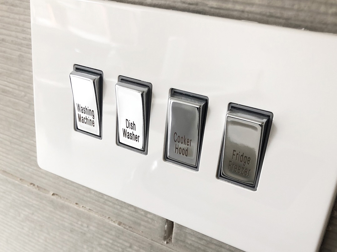

AliG Posted February 13, 2021 Share Posted February 13, 2021 3 minutes ago, puntloos said: Anyway like I said if most/all of a room is on the same circuit anyway surely it's not that hard to create a central "off" switch? All the sockets in a room would probably be on the same circuit and all the lights on a different circuit. In the kitchen, ovens and his will be on their own circuit with their own RCD. You could install a multi grid socket that allows you to turn things off in the kitchen as below. Things like the dishwasher and washing machines which are plugged in behind them need to have accessible switches according to the regs. We just have all of ours inside ne kitchen cupboard to keep it tidy. 1 Link to comment Share on other sites More sharing options...
puntloos Posted February 13, 2021 Author Share Posted February 13, 2021 9 minutes ago, AliG said: All the sockets in a room would probably be on the same circuit and all the lights on a different circuit. In the kitchen, ovens and his will be on their own circuit with their own RCD. You could install a multi grid socket that allows you to turn things off in the kitchen as below. Things like the dishwasher and washing machines which are plugged in behind them need to have accessible switches according to the regs. We just have all of ours inside ne kitchen cupboard to keep it tidy. Excellent, this is a pretty good alternative. Perhaps just create a row of these buttons that you can all flip.. Link to comment Share on other sites More sharing options...
