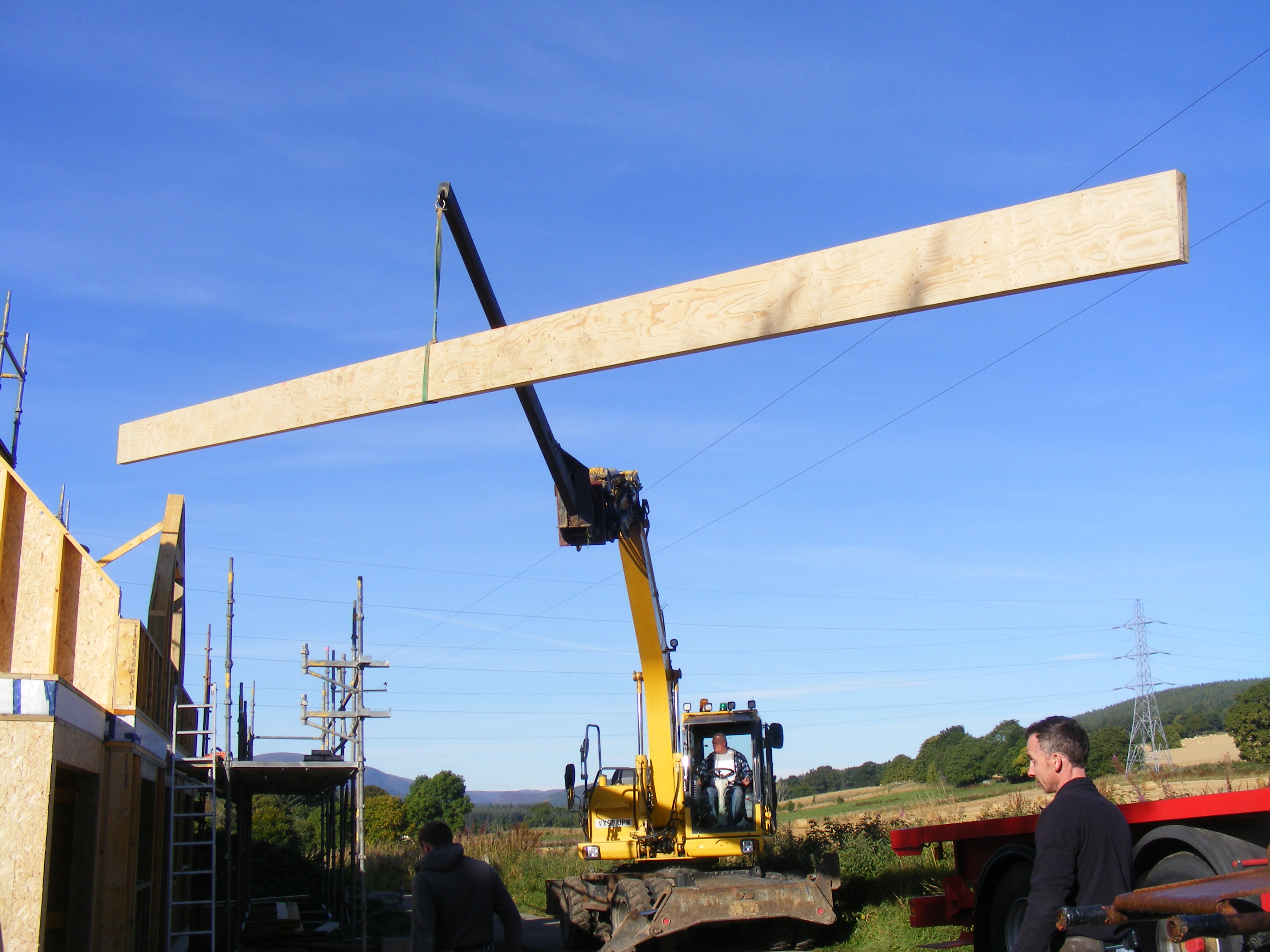

jamiehamy Posted February 8, 2017 Share Posted February 8, 2017 I made sure everything came on either a HIAB(windows, timber, blocks, beans) , or had a tail lift(rubber, heat recovery equipment etc), or was able to be hand balled(icf, insulation cladding etc). Actually the hiab was a deal breaker for Windows - our site would have meant a forklift wouldn't have been suitable. In hindsight, glad I stuck to my guns. We got roof beams off loaded with a tractor with forks but never again - would just hand ball them - 27kgs each. Concrete all went in with a pump. One reason I gave Jewsons so much business was that delivery is always free and always with HIAB. Link to comment Share on other sites More sharing options...
Russell griffiths Posted February 8, 2017 Share Posted February 8, 2017 37 minutes ago, Vijay said: Well the company who quoted me the £95 was for the 411 L bars i need in the foundations. I've emailed them to find out if they are on pallets (which I assume they would be) 411 L bars. Climb on back of truck cut strapping throw on floor. Send truck on its way. Pick them up put in barrow. How big is your digger. I would be very careful picking anything up with a small digger as the lifting capacity is very low. Link to comment Share on other sites More sharing options...

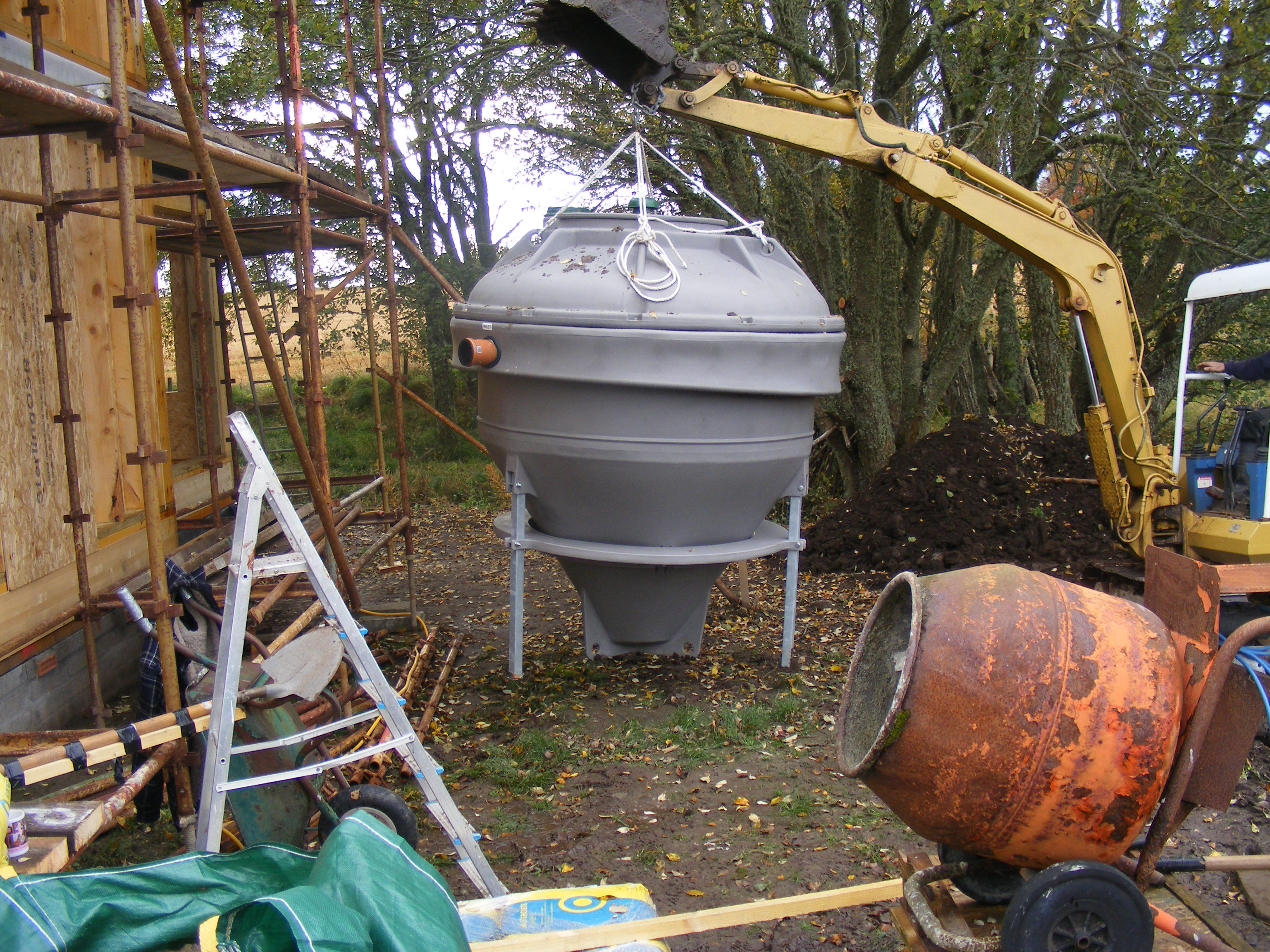

Declan52 Posted February 9, 2017 Share Posted February 9, 2017 (edited) Get them to split it into 2 pallets and your digger with lift them no bother. Use 2 bars through the pallet base and a sling from one end to the other via a shackle. Hanging a sling on the teeth of a bucket isn't a very safe option. Keep the weight as low to the ground as you can. If you are confident you can rest the pallet on the blade so it won't swing about as much when moving. Edited February 9, 2017 by Declan52 Link to comment Share on other sites More sharing options...

Jeremy Harris Posted February 9, 2017 Share Posted February 9, 2017 (edited) We had to do a lot of hand lifting of stuff, as a fair bit came on pallets, via a standard truck with a tail lift and that couldn't get up our drive, so had to drop the pallets at the bottom. It keeps you fit shifting things like pallet loads of travertine flooring, or sandstone slabs, up our drive! All told I think I shifted around 8 to 10 tonnes of stuff by hand from the bottom of the drive. The worst was having 6 pallet loads of sandstone delivered, as it all arrived at around 4pm and I couldn't get my car out to drive home until after I'd unwrapped each pallet and lifted all the stone to the top of the drive and stacked it. The 900 x 600 slabs (of which there were three pallet loads) were particularly memorable.................. Edited February 9, 2017 by JSHarris Link to comment Share on other sites More sharing options...
