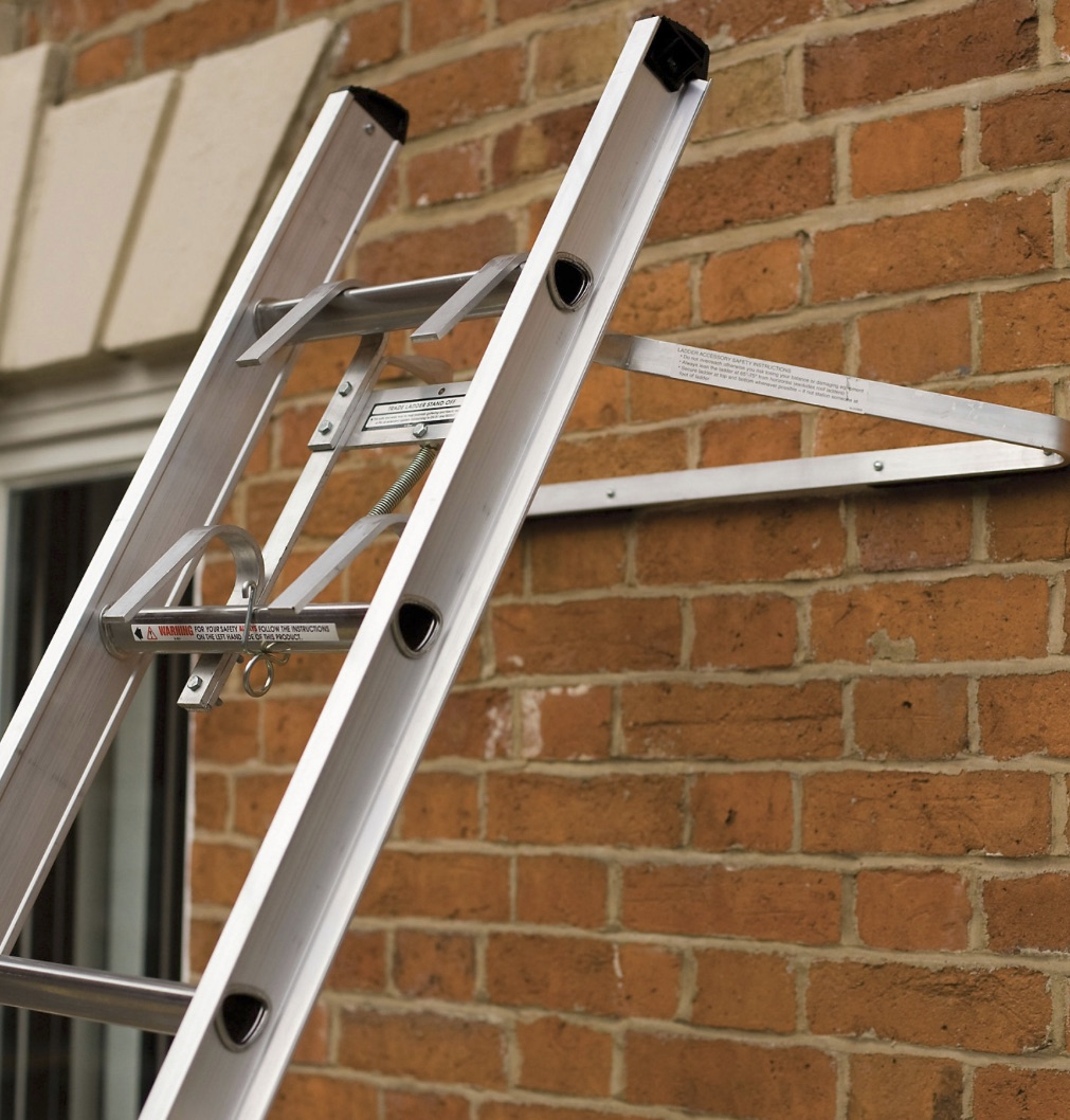

dnb Posted February 12, 2021 Share Posted February 12, 2021 The OP's pic could very well end up in the how not to do it section of my next working at heights refresher course at work... Link to comment Share on other sites More sharing options...
Dave_Watts Posted February 12, 2021 Author Share Posted February 12, 2021 2 minutes ago, Temp said: That blue painters masking tape isn't very strong ? it isn't tape, its a tie down strap Link to comment Share on other sites More sharing options...
Dave_Watts Posted February 12, 2021 Author Share Posted February 12, 2021 5 minutes ago, Onoff said: does it come free with every ladder? Link to comment Share on other sites More sharing options...
Onoff Posted February 12, 2021 Share Posted February 12, 2021 1 minute ago, Dave_Watts said: does it come free with every ladder? Yes but you never get to hold it when being fed by a tube and having your ar5£ wiped for you! ? Link to comment Share on other sites More sharing options...
Dave_Watts Posted February 12, 2021 Author Share Posted February 12, 2021 3 minutes ago, dnb said: The OP's pic could very well end up in the how not to do it section of my next working at heights refresher course at work... Make sure you include these stand off's as well. It's basically the same thing. Link to comment Share on other sites More sharing options...
ash_scotland88 Posted February 12, 2021 Share Posted February 12, 2021 7 minutes ago, dnb said: The OP's pic could very well end up in the how not to do it section of my next working at heights refresher course at work... By wrapping it around like that you've reduced its SWL, or so i was always told. Link to comment Share on other sites More sharing options...
Ferdinand Posted February 12, 2021 Share Posted February 12, 2021 53 minutes ago, Mr Punter said: I had an aluminium folding scaffold tower that I could assemble myself although easier with 2. @Ferdinand has it now. I still pine for it sometimes... Yes. And very good it is. I thought you had two, @Mr Punter. What happened to the other one? Aside: He's a ruthless negotiator. "Can I have another £20 off?" "No." (He was right.) This one (gloats: all *mine*) is a Zarges Reachmaster. It can be put up in half an hour or so on your own, and fits in a normal estate car. Mine is tall enough that it has been used to re-render gables on a cottage. To op: Spend about £750-1000 on a decent scaffold tower; you will use it multiple times a year. It is not much more expensive than the wheelchair you might need to buy when you fall off your mackled up ladder, which would start from about £300. I can recommend models, as I bought one for my invalided mum 3 and a bit years ago. Forgive my directness; this is not a place to skimp, and I think you are being willfully stupid. Nobody on this forum will tell you different. Of if you must have something cheaper, there are decent quality work platforms available for a couple of hundred that may do it. I have one like one of these Youngman ones which I bought as a Wickes own brand. Well under £200. Had it for 8 years now. Built a conservatory using it. https://www.youngmanaccess.com/combination-ladders/Pro-DeckSeries/5101518) F 1 Link to comment Share on other sites More sharing options...
Dave_Watts Posted February 12, 2021 Author Share Posted February 12, 2021 10 minutes ago, ash_scotland88 said: By wrapping it around like that you've reduced its SWL, or so i was always told. The PVC waste pipes is rated to support a 10,000 lbs load, probably less with a couple of notches cut out of it, but it must be strong enough to support 220lbs of me (& ladder) leading at a 25 degree angle (~220lbs). The strap only holds it in position, there is no additional force other than hand tight. Link to comment Share on other sites More sharing options...

ToughButterCup Posted February 12, 2021 Share Posted February 12, 2021 4 hours ago, Dave_Watts said: It seems strong enough, but would you trust it? For a few moments, yes. Longer, no. Look at the treads: they are rounded square in section. Half an hour on those and your feet will hurt. You need treads that are angled so they are level when the ladder is set at 4:1. Hire a scaffold or a tower.... please. 1 Link to comment Share on other sites More sharing options...
Ferdinand Posted February 12, 2021 Share Posted February 12, 2021 1 hour ago, Dave_Watts said: OK, I'll go with the tower route. It is more sensible. That's a good decision. 1 Link to comment Share on other sites More sharing options...
Dave_Watts Posted February 12, 2021 Author Share Posted February 12, 2021 23 minutes ago, joe90 said: I concur with a tower, would not do it any other way. However is stapling a membrane going to be good enough?. If it were me I would strip the tiles and battens, felt the roof properly and insert insulation!. What insulation are you using?, if rockwall it might be easier to insert it from the outside after lining the bottom of the rafters then felt and battens. I'm also concerned about the stapling being good enough, maybe I will nail in a batten to stop water getting past the sides. It is a huge roof, and the tiles are in good condition. It would be a massive job to re-roof it and there are more important jobs that demand the budget. Link to comment Share on other sites More sharing options...
Dave_Watts Posted February 12, 2021 Author Share Posted February 12, 2021 16 minutes ago, ToughButterCup said: For a few moments, yes. Longer, no. Look at the treads: they are rounded square in section. Half an hour on those and your feet will hurt. You need treads that are angled so they are level when the ladder is set at 4:1. Hire a scaffold or a tower.... please. Yes, I will hire a tower, my head for heights is not good enough anyway. Link to comment Share on other sites More sharing options...
