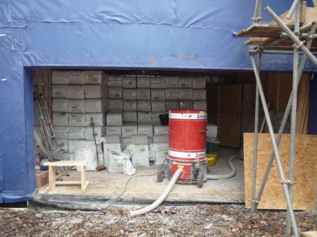

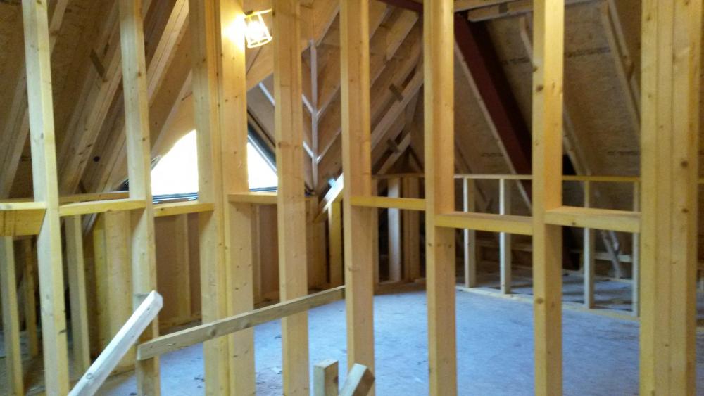

HerbJ Posted February 10, 2021 Posted February 10, 2021 (edited) Yes, blown cellulose which was installed on 30 November/1 December 2015 (when this photo was taken). First delivery of imberframe started on 24 September 2015 but we had problems with cranes and erection did not start until 3 or 4 days later. The roof installation was at the beginning of end of October and PV panels installed on 3 November 2015, to allows completion ot tiling. The windows were delivered on 9 November 2015 and installation started same day Edited February 10, 2021 by HerbJ
Thorfun Posted February 10, 2021 Posted February 10, 2021 3 minutes ago, HerbJ said: Yes, blown cellulose which was installed on 31 November/1 December 2015 (when this photo was taken). First delivery of imberframe started on 24 September 2015 but we had problems with cranes and erection did not start until 3 or 4 days later. The roof installation was at the beginning of end of October and PV panels installed on 3 November 2015, to allows completion ot tiling. The windows were delivered on 9 November 2015 and installation started same day ahh....ok, that would account for the OSB finish internally. I guess that's different to me installing frametherm between the studs and PIR over the top. I was pretty confident that the windows can be fitted to the TF as simply an open panel TF without insulation but there is now an element of doubt!

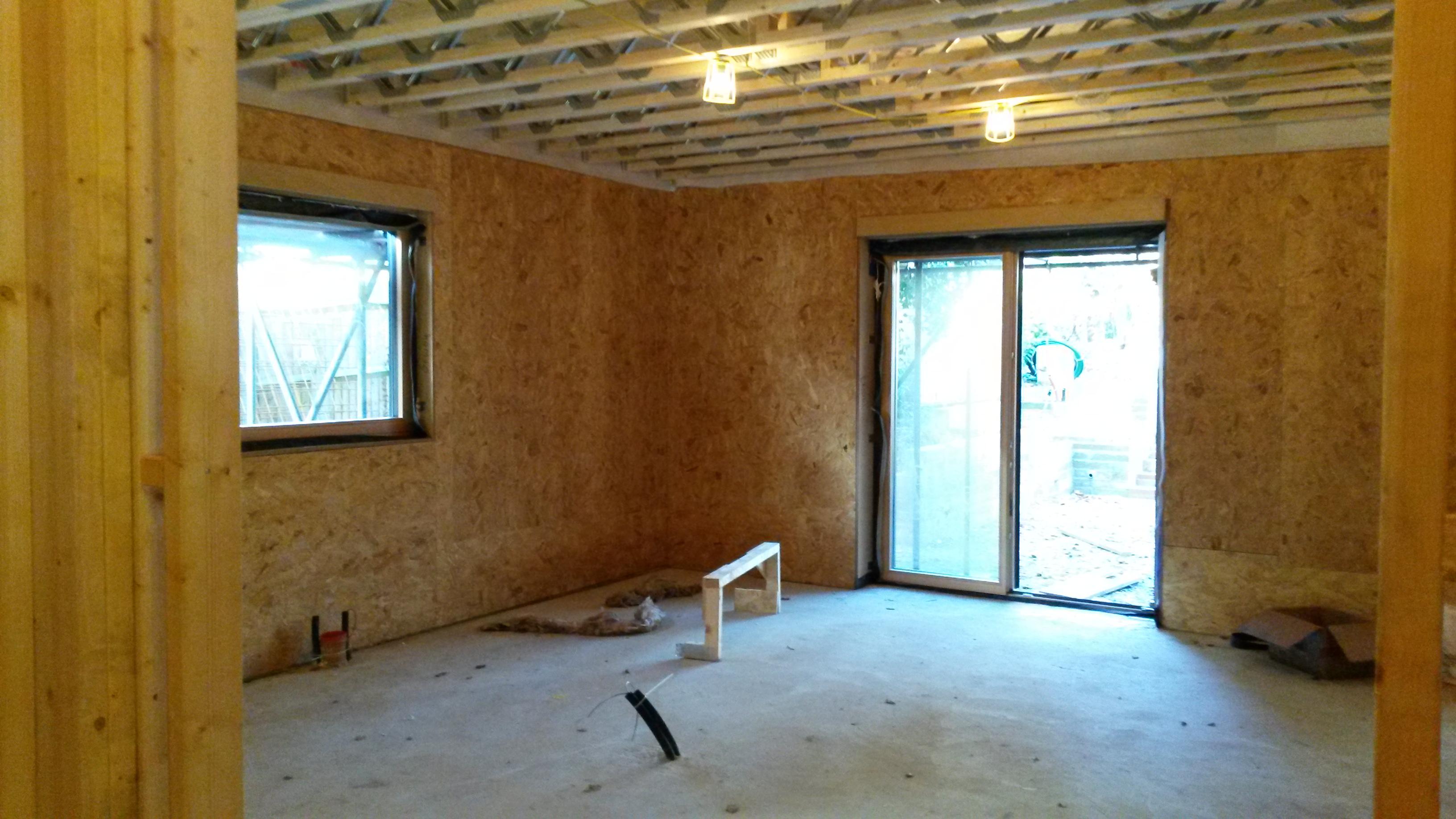

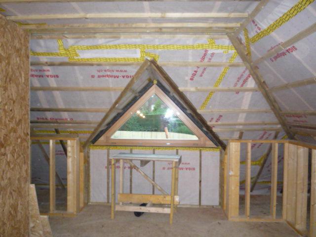

HerbJ Posted February 10, 2021 Posted February 10, 2021 (edited) You may be alright. I guess it will depend on how weathertight the outside layer of your frame is likley to be? Certainly, OSB was installed on the inside prior to window installation but not on the underside of the roof, which did not have OSB internally, but only VPC layer before the insulation was blown. see photo above of the roof before VPC installed - you can sse the underside of the OSB sarking. I attach a photo of the roof truuses with VPC installed before cellulose installation. Hope this helps Edited February 10, 2021 by HerbJ
Bitpipe Posted February 10, 2021 Posted February 10, 2021 19 minutes ago, Thorfun said: ahh....ok, that would account for the OSB finish internally. I guess that's different to me installing frametherm between the studs and PIR over the top. I was pretty confident that the windows can be fitted to the TF as simply an open panel TF without insulation but there is now an element of doubt! No, you should still be able to install the windows once the frame has been erected but you will probably want to frame out the internal reveals if your windows are straddling the insulated layer. I recommend Compriband between the window and frame for a good seal (not foam) and when your VCL is installed you can use airtightness tape on the internal perimeter of the windows back to that. The MBC approach is to erect the structural frame and then board out the interior face to create the insulation cavity and allow windows etc to be fitted. They then cut holes in the internal OSB and pump the insulation in before sealing and completing the airtightness detail. On my build they used a new internal board that also provided the airtighness layer, at @HerbJ they applied this layer over the OSB. The service void is created by facing the insulated layer with 50mm battens onto which the plasterboard is applied. This means that sockets boxes, cable runs and the like are fixed to the battens and never penetrate the airtightness layer. If you want a penetration from inside to outside, it's easy to do but you use conduit (drilled and placed at a downward angle to stop rain ingress) and tape up where it exits the VCL. When the cable or service is run, you can seal the interior with silicone etc. It's all about detailing!

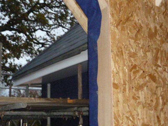

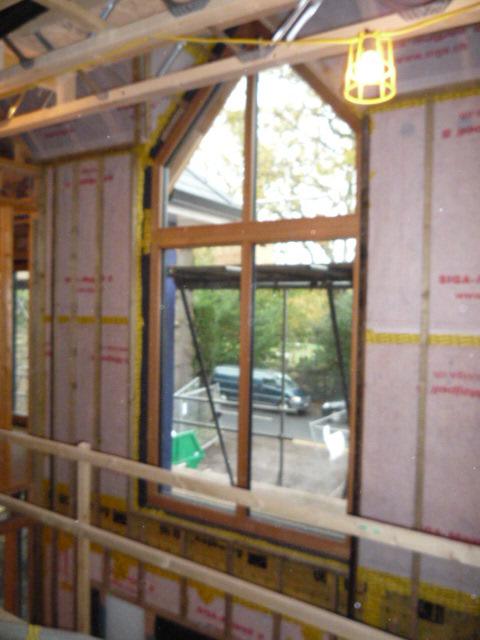

HerbJ Posted February 10, 2021 Posted February 10, 2021 (edited) 1 hour ago, Bitpipe said: No, you should still be able to install the windows once the frame has been erected but you will probably want to frame out the internal reveals if your windows are straddling the insulated layer Yes, I agree with this, I specced marine grade ply boxes to be fitted in each window openings by MBC as part their scope (not a great photo but you get the idea). Also a photo to illustrate what @bitpipe is explaining aboot the differnce between the VPC layer construction on my build and also the service cavity battens. +1 to Compraband - used on all my windows Edited February 10, 2021 by HerbJ
Thorfun Posted February 10, 2021 Posted February 10, 2021 thanks @Bitpipe and @HerbJ. very useful explanations. I've already requested compriband from Norrsken it's just the window reveals that I'll need to double check on but I'm glad I've got confirmation from both of you that my plan of action will work! I need to save money and installing the insulation myself is one way of saving money but it will take me time and I don't want it to hold up anything external to get the building watertight. hopefully this thread mini-hijack is also useful to the OP @Suffolk_J as it sounds like it's the same route as me.
HerbJ Posted February 10, 2021 Posted February 10, 2021 (edited) Make sure that your window opening dimensions for your windows are made with the window "boxes" installed. I actually did all of mine from the timber-frame drawings and it was check check, check again with me coordinating (and taking responsibility) with MBC AND the window supplier to ensure installation tolerances were correct and the windows could be installed. Edited February 10, 2021 by HerbJ 1
