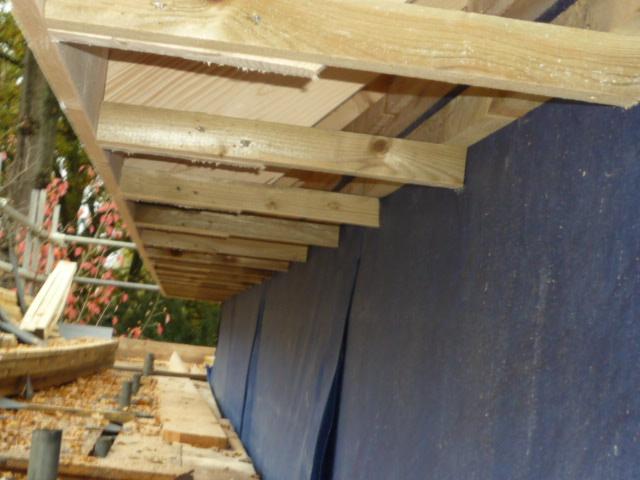

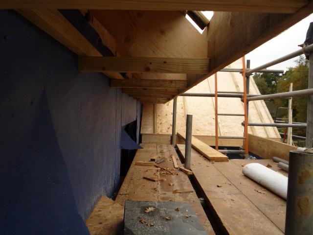

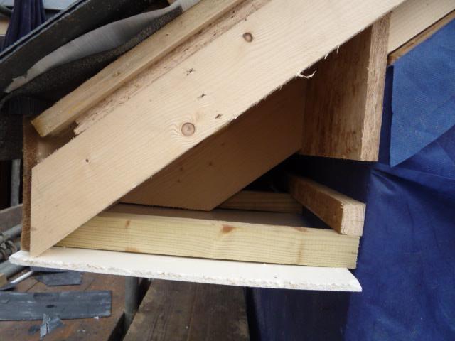

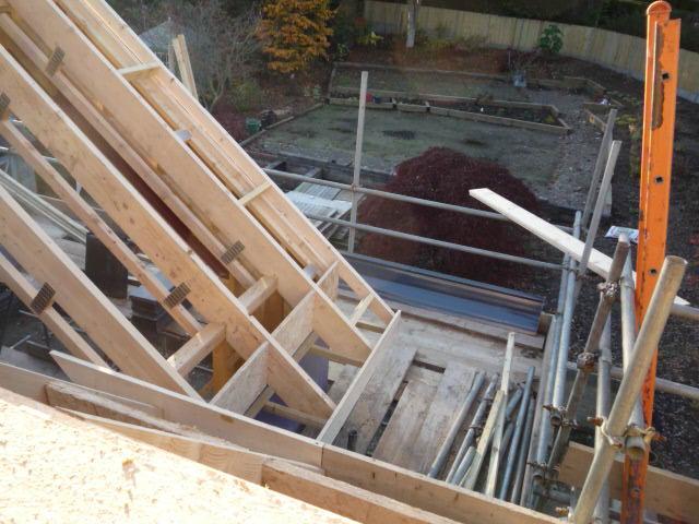

I have a render/cladding external skin - rendered aquapanel  for the most part - but the same approach should work for your construction.
I assume MBC's scope for the TF is the same a mine. MBC fiited fascia boards and noggins, as part of their scope. I then was able to fit my fascia and noggin board finish (UPVC) and  gutters (seamless aluminium) with temporary downpipes in eary November, immediatley before my windows were fiited, and several months before the aquapanel and render was completed in March/April.
Attached photos may help..
Your approach with a external brick skin should not be a lot different and you will have a gap between brick skin and installed soffit, to allow for the differential expanasion/setment of the brick skin and the timberframe holding the roff and fascias/soffits. @TerryE  will probably share his experience.
Trust this helps.
