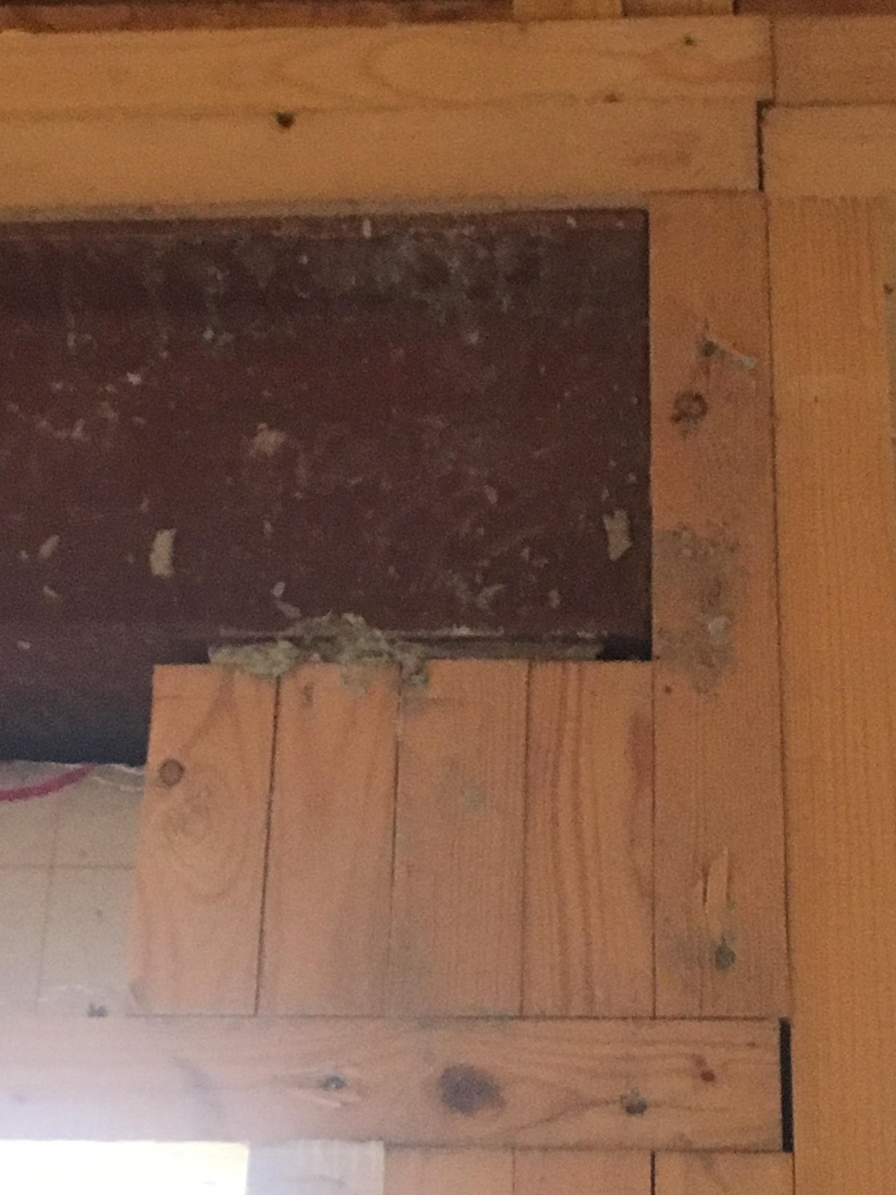

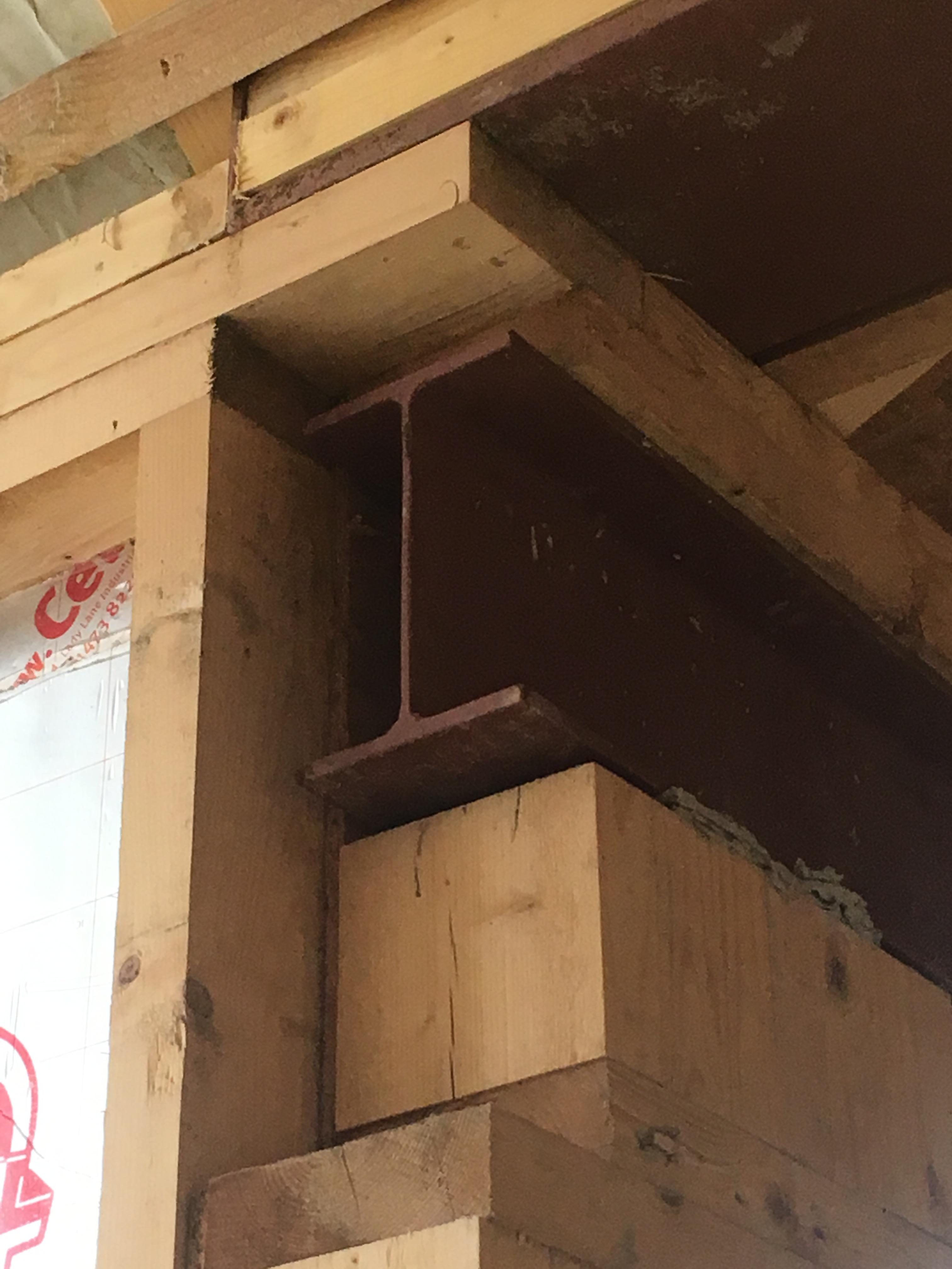

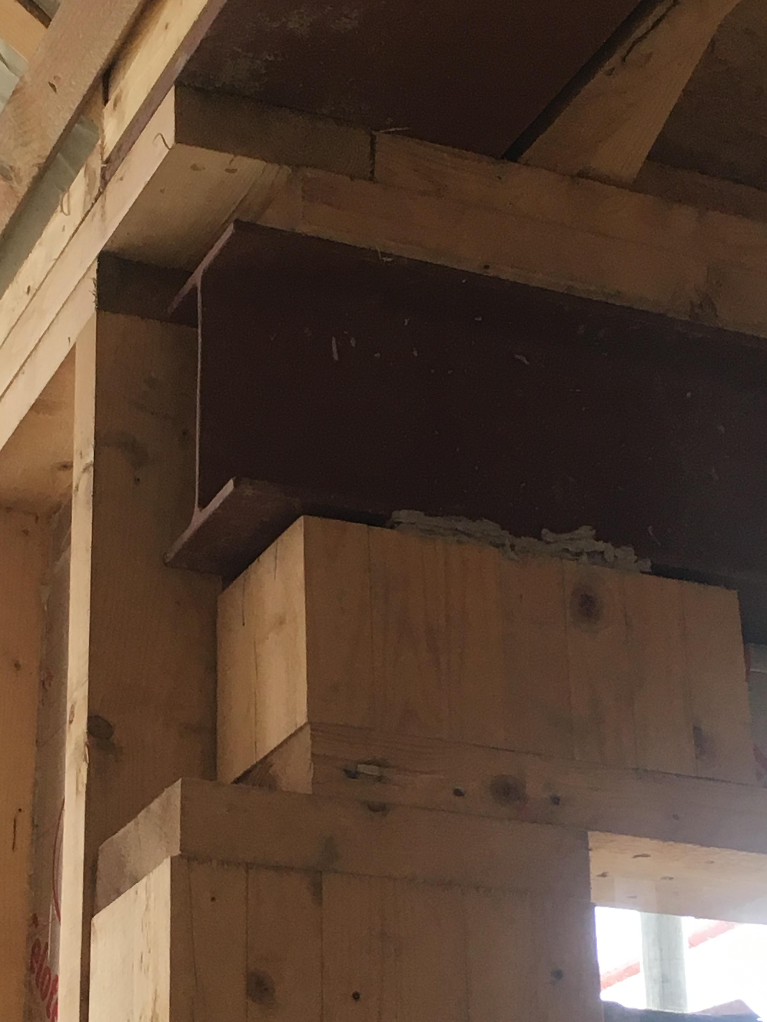

Russell griffiths Posted February 7, 2017 Share Posted February 7, 2017 What's your opinion on this? If you look closely there is one beam on top of the main one in the photo, out of the shot there are 2 more beams running into the large one that is stacked on top of the one in the photo. So in all there are 4 upstairs walls sitting on this point. Do do you like it? Link to comment Share on other sites More sharing options...
ProDave Posted February 7, 2017 Share Posted February 7, 2017 That's not what I call "precision" work there. For a start the timber the beam is sat on is too short and the beam is too short. And what's that blob of cement for? I would have preferred the packer to have been re made the right thickness. Can we have a more general zoomed out shout? Has this only just been done? Link to comment Share on other sites More sharing options...
Declan52 Posted February 7, 2017 Share Posted February 7, 2017 Think the cement blob is something like cement board/asbestolux that has been hit many times with a hammer. Link to comment Share on other sites More sharing options...
Jeremy Harris Posted February 7, 2017 Share Posted February 7, 2017 Packers under steel need to be incompressible over time, so NOT cement board or similar! Slate was the traditional packing material, but steel shims work OK. As above, the timber is too short and the bearing block isn't located properly, the idea is to transfer the load vertically down into the post below, and having it off-axis like this reduces the bearing capacity and introduces an out-of-axis load component, which is not good. Link to comment Share on other sites More sharing options...
Russell griffiths Posted February 7, 2017 Author Share Posted February 7, 2017 Yep it's a piece of fibre board. This is a 3 storey house. Build cost £500,000. The second beam is a monster top and bottom flanges 20mm about 9m span with 2 other beams coming into it at the midway point. Link to comment Share on other sites More sharing options...
Steptoe Posted February 7, 2017 Share Posted February 7, 2017 To say I'd be more than unhappy with that would be a pretty big understatement, even if it was a £50k house, Standards are standards, workmanship and pride in the job says a lot about whoever done that.! Link to comment Share on other sites More sharing options...
PeterW Posted February 7, 2017 Share Posted February 7, 2017 Wonder what the structural engineer would make of that ..?? Link to comment Share on other sites More sharing options...
Declan52 Posted February 8, 2017 Share Posted February 8, 2017 Think it's time to get a few accrows out and get that sorted before it's too late. Link to comment Share on other sites More sharing options...
jamiehamy Posted February 8, 2017 Share Posted February 8, 2017 As we say up here "that disnae look right" Link to comment Share on other sites More sharing options...
ProDave Posted February 8, 2017 Share Posted February 8, 2017 I would be having very serious words with your builder, to the point I would stop all further work until this is sorted. Those packers are wrong, they have to be changed. At the left hand end it has been designed to sit on a stack of 6 uprights to support it, but because the timber and the steel beam are too short, only 4 of the uprights are taking the load. The builders should have realised this was wrong when they came to put the first steel in, but they have swept it under the carpet hoping nobody will realise. If they don't offer a solution at their cost I would tell them I will be getting the building inspector to look at it and let him say what needs to be done, then they will have to do it. I would definitely want the SE to look at it and propose a solution. Link to comment Share on other sites More sharing options...
