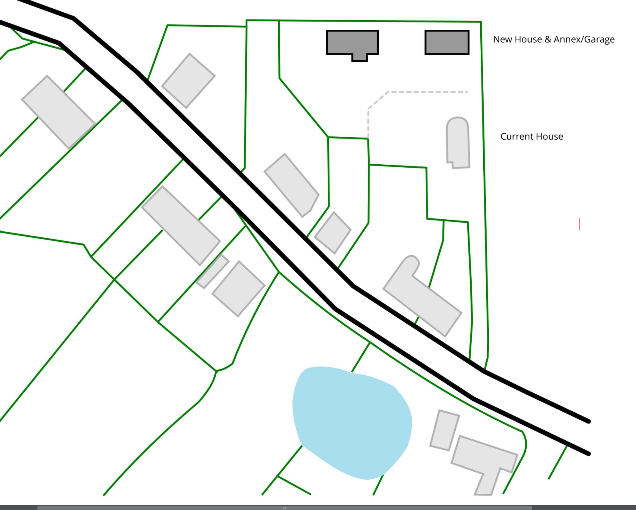

Paul Leigh Posted February 9, 2021 Share Posted February 9, 2021 Hi, Had my Pre application meeting today, which went quite well. We are agreed that my garden plot falls under "Previously Developed Land" inside the Green Belt and that some development is likely ok. The sticking point comes in the it harming the openness of the green belt. As the officer described it, something as small a pencil would harm the openness. I know that other houses have been allowed, perhaps with other mitigation but how can openness be tested? Thanks, Paul Link to comment Share on other sites More sharing options...
Mr Punter Posted February 9, 2021 Share Posted February 9, 2021 This sounds quite subjective. It may be worth looking at other successful schemes in the area and taking a cue from them. If you can find one-off houses, do some research and see who the architect is. Does the local plan give any positive clues? Link to comment Share on other sites More sharing options...
Bramco Posted February 9, 2021 Share Posted February 9, 2021 (edited) Interesting one that. It's a catch all to deny permission. But there are ways round it. The NPPF states there are 5 purposes of a Green Belt, including things like preventing towns merging etc. para 134. If your land was previously developed then it can't be said to be contrary to the 'purpose' of your local Green Belt. Always a good starting position. Para 145 gives 6 exceptions, including limited infill in villages and replacement of a building so long as the replacement isn't larger than the original and also extending existing dwellings (up to 50% is allowable). If you qualify as an exception then there is case law which sets out that being an exception means that the question of openness need not be considered by the planning authority - I can dig out the actual case if you need it. The issue for you is that the exception you might qualify under (g) has a restrictive clause about the openness. To quote '....not cause substantial harm to the openness of the Green Belt, where the development would re-use previously developed land and contribute to meeting an identified affordable housing need within the area of the local planning authority'. So the key word is 'substantial' and you should search for any housing needs survey the Parish Council may have conducted or even the Borough Council. That would help to identify the contribution to the need. In addition, if the Council doesn't have a 5 year housing plan then all bets are off for them because according to an earlier para in the NPPF they should grant permission. Another way round this is to show 'exceptional circumstances' but this is v hard to do and has to rely on an architecturally special design. I bought a book on all the case law on the NPPF - I'll find it later and edit this with the title and author - it's expensive but well worth it if you find something to support your case. Also a LOT of googling of planning appeals should turn up some cases that support you. Simon EDIT - the book on NPPF case law is 'Interpreting the NPPF' by Alistair Mills QC. Bath Publishing. https://www.amazon.co.uk/Interpreting-NPPF-National-Planning-Framework/dp/1916431526 But be careful, as this was published in 2018 and the NPPF has been revised since then. You might need to check back on the NPPF to see if the specific clause on redevelopment in the Green Belt has changed. Edited February 9, 2021 by Bramco Link to comment Share on other sites More sharing options...
Bramco Posted February 9, 2021 Share Posted February 9, 2021 10 minutes ago, Mr Punter said: Does the local plan give any positive clues? The only thing the Local Plan might do is to add some restrictive conditions over and above the NPPF - for example development should be concentrated in a specific list of villages, or there may be restrictive clauses about preserving the 'countryside'. You have to jump the NPPF hurdle first and then jump the Local Plan hurdle. Simon Link to comment Share on other sites More sharing options...
Bramco Posted February 9, 2021 Share Posted February 9, 2021 37 minutes ago, Paul Leigh said: We are agreed that my garden plot falls under "Previously Developed Land" inside the Green Belt Just a further thought - if it is a garden plot, why isn't it being considered under the infill in a village clause - this, as I said earlier has case law that says that 'openness' does not need to be considered. Simon Link to comment Share on other sites More sharing options...

ToughButterCup Posted February 9, 2021 Share Posted February 9, 2021 2 hours ago, Paul Leigh said: ... The sticking point comes in ... There's often a similar planning story - different sticky issue. The answer is to research the gonads off it. The end in mind is to be more informed than the planner about 2 hours ago, Paul Leigh said: ... but how [is] openness ... tested? ... There is a duty of Consistency in planning . Here's a link to a beautifully well written blog with the search results for Consistency in the planning context. As you hint, other houses have been allowed. Start there. Go into every salient detail with an eye to getting a clear picture about what openness has meant in the recent past. Go to those locations, look at them - assemble a clear body of evidence and then make your own mind up. Also, do an internet search search for Consistency in the planning context. There are many articles about it. The aim is to know your stuff about (local ideas on) openess far better than the planner to whom you are talking. Be able to back her into a corner with facts and precedent: don't make yourself an easy target. Link to comment Share on other sites More sharing options...
Paul Leigh Posted February 9, 2021 Author Share Posted February 9, 2021 (edited) Thank you for the responses, some great information here. Each of the houses I can see that got PP in the district, the officer was quick to point out other mitigation, an “ah but… “ type response, to which my view is that the Openness can’t be being applied consistently, exactly as ToughButterCup points out. I’m in a small hamlet, off a B road, I’ve attached an outline of the neighbouring properties with my current house and proposed house/annex labelled. I had considered this an infill project but the guys at Potton (not using them btw) said it wouldn’t be classed as infill as was a back garden, that infill meant in between houses only. In actual fact, now that it’s been raised again, I’m minded to point out to the council that the new development would be in my side garden as my front door is 90 degrees to the road, my back garden remains untouched. Perhaps infill is a way to go here? The north side of my garden (picture is North up) is bordered by trees so there is no way to see through. Any building will not impede anyone’s view from any vantage point. Bramco, from what I understood, the council have a 5 year house supply plan but are falling short on delivering. It’s a heavily Green Belt area. We’ve agreed that the garden by virtue of it being a residential garden in a non built up area is classed as “Previously Developed Land” and I additionally have a workshop on the land and an LDC I took out for a 97 SqM garage a few years ago that I never started and the foundations of a garage no longer standing. We don’t have a Local Plan, that’s been rejected by the Gov. I took from the meeting that anything above the already existing footprint of the LDC and single storey height would be a problem for her and that the Openness clause would be used against me. This is the fight. In all other aspects she was quite helpful with saying that the plan was reasonable and nothing else stood out as a likely objection, ecology reports aside of course. Time to become a research-a-holic on openness cases then, thanks everyone. Edited February 9, 2021 by Paul Leigh Link to comment Share on other sites More sharing options...

the_r_sole Posted February 10, 2021 Share Posted February 10, 2021 (edited) immediate reaction is that the development looks completely at odds with the existing settlement pattern, although the current house also is, you could say the proposed would appear as back land development which many local authorities are opposed to. Speak to a planning consultant as early as possible to understand if this is even slightly a go-er! The ones that we use will tell us that if they don't think there's a chance before needing paid!! infill needs to be in between two things to be infilling something, so that's a massive stretch! Edited February 10, 2021 by the_r_sole Link to comment Share on other sites More sharing options...
ToughButterCup Posted February 10, 2021 Share Posted February 10, 2021 (edited) 20 minutes ago, the_r_sole said: immediate reaction is that the development looks completely at odds with the existing settlement pattern,.... And @Paul Leigh, there's your starter for 10. Look for developments that (at the time they were suggested) '... look completely at odds with ...' . @the_r_sole 's repsonse seems negative. It isn't - it's extremely valuable : its the issue that, once addressed, will get you a few steps further on your way to Planning Permission. Persistence . Good luck. Ian Edited February 10, 2021 by ToughButterCup Link to comment Share on other sites More sharing options...

Paul Leigh Posted February 10, 2021 Author Share Posted February 10, 2021 4 hours ago, the_r_sole said: immediate reaction is that the development looks completely at odds with the existing settlement pattern, although the current house also is, you could say the proposed would appear as back land development which many local authorities are opposed to. Speak to a planning consultant as early as possible to understand if this is even slightly a go-er! The ones that we use will tell us that if they don't think there's a chance before needing paid!! infill needs to be in between two things to be infilling something, so that's a massive stretch! You could be right but the Current house (an Oast House) was here first. In the surrounding area, there are plenty of examples of houses not on the road and are down tracks, just like mine. I've got the pre-planning advice back now, I'll read it slowly over a few nights but I've already found examples in the local area of properties where through one mitigation or another, the question of openness has been set aside. Thanks for all the valuable advice on here. Link to comment Share on other sites More sharing options...
the_r_sole Posted February 10, 2021 Share Posted February 10, 2021 44 minutes ago, Paul Leigh said: You could be right but the Current house (an Oast House) was here first. In the surrounding area, there are plenty of examples of houses not on the road and are down tracks, just like mine. I've got the pre-planning advice back now, I'll read it slowly over a few nights but I've already found examples in the local area of properties where through one mitigation or another, the question of openness has been set aside. Thanks for all the valuable advice on here. There's the current house arrangement which has it's own access from the main road, and then your proposal which takes that one step further introducing a shared access from the main road and new development where you have to pass one property to get to the one behind - so if you're looking for examples then that's what to look for. The other thing to consider is that if that relationship with the oast house (can't help singing the alan partridge podcast theme here!) is common i.e. further from the road and behind other houses, it might make your case weaker to develop the area behind/around it as the oast house is no longer a stand alone unit. If ever there was a job for a planning consultant.... Link to comment Share on other sites More sharing options...
