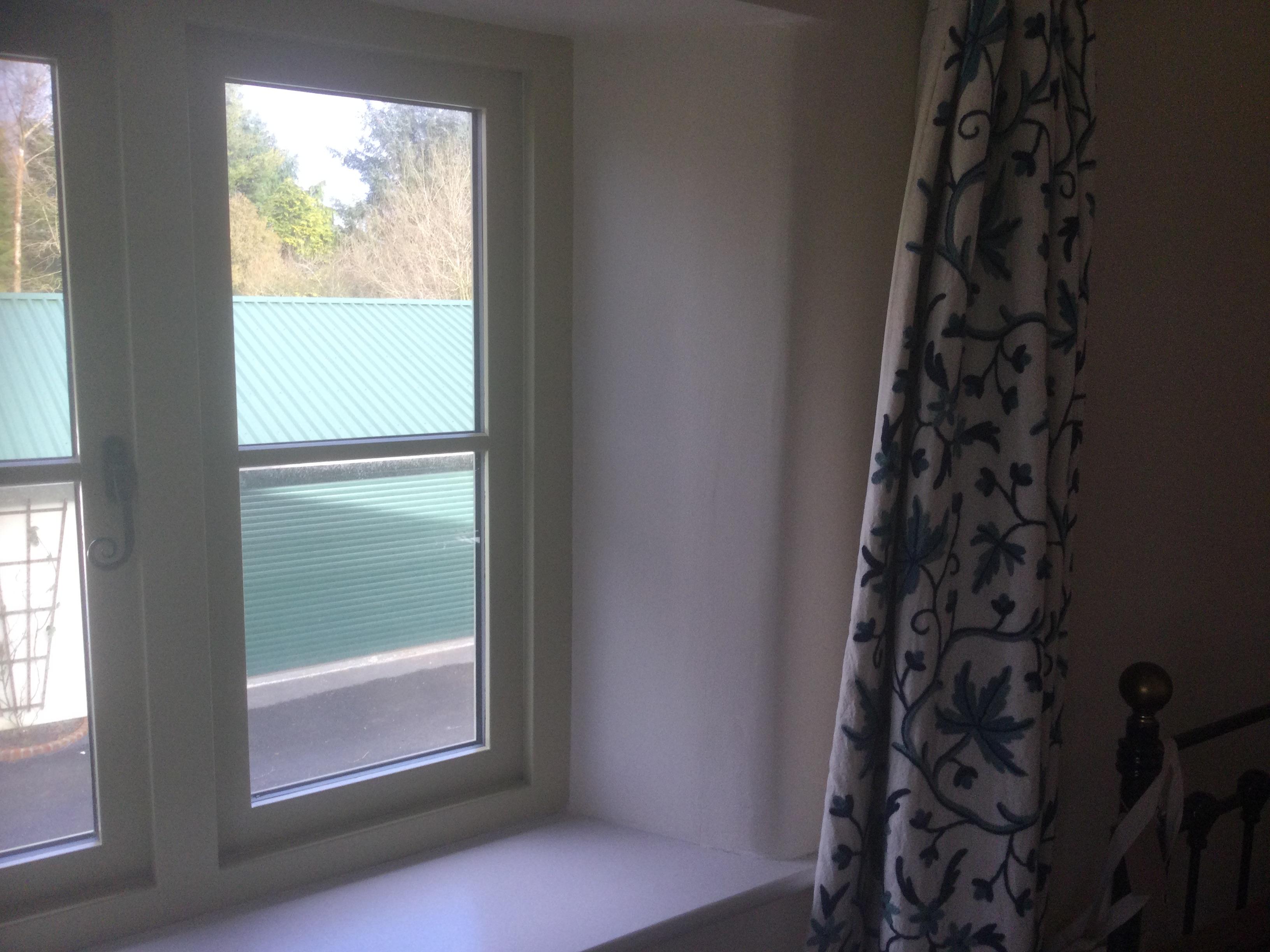

joe90 Posted February 6, 2021 Share Posted February 6, 2021 I had a 200mm cavity but brick outer skin, I also had “check” reveals. This means the inner skin has a bigger width than the outer skin and the windows and doors are fitted to the inside of the outside wall. Mine was held in place by stainless brackets and expanding foam strip between the window and outer skin. (I also had angled reveals giving better light into the rooms and looked cottagey.) 2 Link to comment Share on other sites More sharing options...

joe90 Posted February 7, 2021 Share Posted February 7, 2021 1 hour ago, Matt60 said: Sorry for all the questions but you've raised some interesting points that I hadn't even considered. Dont be, that’s what the forum is for. Being a bit OCD, I asked the bricklayer to make my windows openings to a whole brick or half brick as I hate slivers of bricks, the wooden windows were hand made to fit the openings. To show off the windows and ease fitting, also to put the windows in the insulation layer check reveals work well IMO. I cut the blocks inner skin at an angle, fitted angle timbers to window sides and fitted plasterboard screwed to these timbers and plasterboard adhesive to the blocks. The window was foamed to the brickwork before topping up the insulation and fitting sides etc. 1 Link to comment Share on other sites More sharing options...
Matt60 Posted February 7, 2021 Share Posted February 7, 2021 I see, thanks for the info - looks like a really neat job and the widow width to suit whole/half bricks is a really good idea. The more I know, the more I know I need to know...? 1 Link to comment Share on other sites More sharing options...

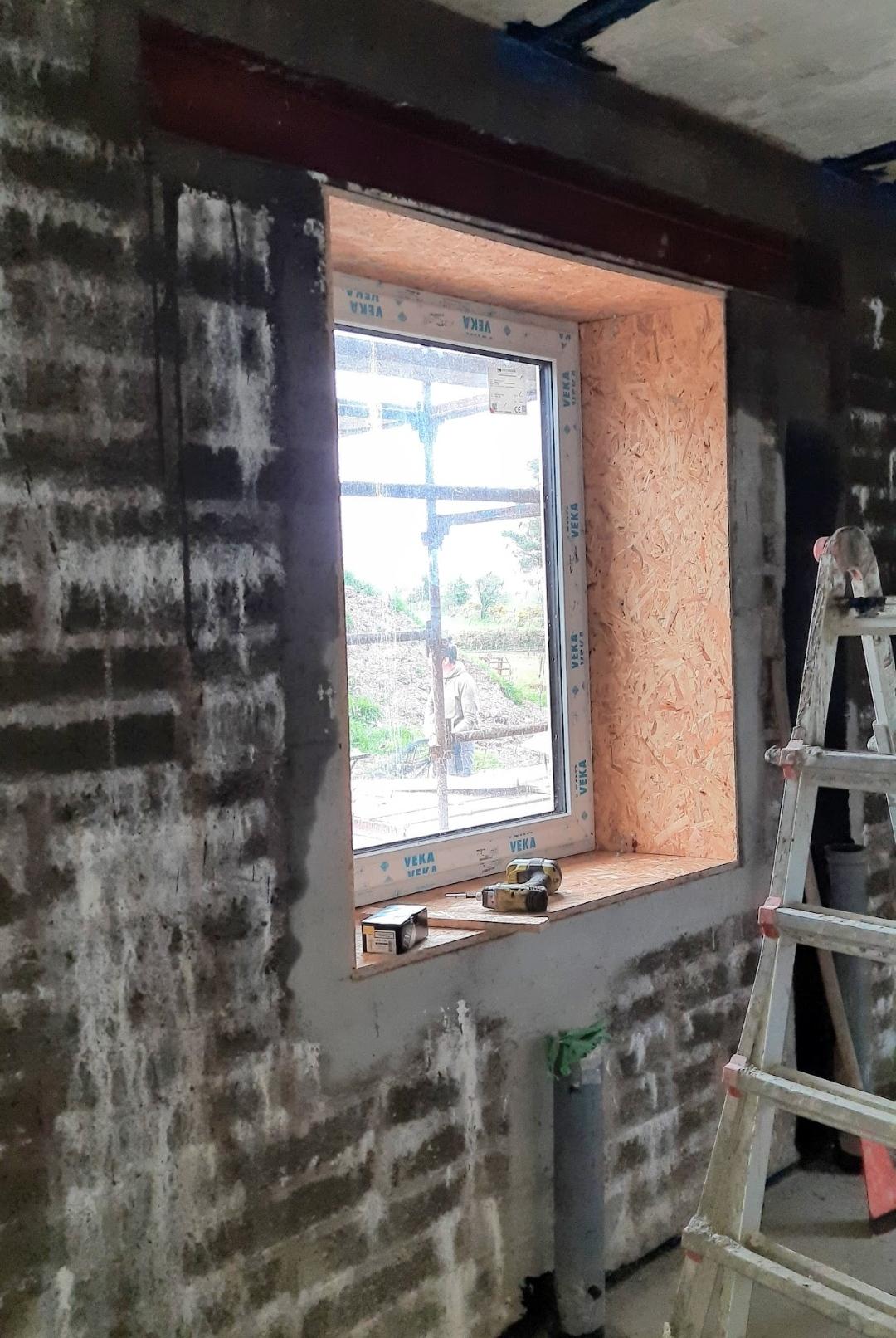

Iceverge Posted February 7, 2021 Share Posted February 7, 2021 7 hours ago, Matt60 said: That's interesting, I like the idea of check reveals, does this work best with UPVC windows as they have a thicker frame to take in to account the difference in aperture width? My build is specced with aluminium windows and I assume they have a narrower frame and so the check difference would be more critical? What was the check difference on yours? The angled reveals, was that achieved by just cutting the blocks? Worked fine with PVC windows for us. I made angled 18mm OSB boxes after the windows were fitted and concrete screwed them to the inner leaf. No need to cut blocks just set back the inner leaf by 100-150mm depending on the angle you desire. In hindsight it would have been easier to build the boxes in as the walls went up. 2 Link to comment Share on other sites More sharing options...

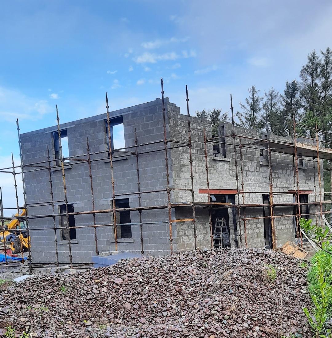

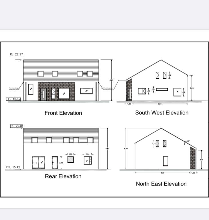

Moggaman Posted February 7, 2021 Author Share Posted February 7, 2021 6 hours ago, joe90 said: This will (I think) be because of wide openings near the ends of walls, but why on earth do it all the way round?? ££££££. Well I thought it was to ensure that the 1st floor 150mm thick precast would have stable walls to sit on but yes the opes were mentioned. My proposed house is 1.5 stories with only 4 to 5 courses above the first floor . See attached.Opes aren’t crazy big ... do people have to thicken inner leaf at sliding doors generally? The precast manufacturer said that 100mm walls on the inner and outer leaf would be fine for precast. The perimeters of my building is 13m x 9m , a rectangle and I would only bring the block on flat to precast floor level, so whilst it may be more expensive , it’s not gonna be huge???. That’s why I said to myself ...ah just put block on flat all around.. i am interested did any of ye guys who have block built houses with precast first floor and average sized opes thicken the inner leaf? thanks Link to comment Share on other sites More sharing options...
PeterW Posted February 8, 2021 Share Posted February 8, 2021 If you want a thicker wall then go for 140mm blockwork - 215mm is overkill and unnecessary. 1 Link to comment Share on other sites More sharing options...
joe90 Posted February 8, 2021 Share Posted February 8, 2021 7 hours ago, Moggaman said: The precast manufacturer said that 100mm walls on the inner and outer leaf would be fine for precast. I think that says it all, your openings are not oversized (IMO) so I think it’s OTT. 1 Link to comment Share on other sites More sharing options...
PeterW Posted February 8, 2021 Share Posted February 8, 2021 Going past anything other than 140mm will cause issues I think over openings as you will need custom lintels for all of those - 215mm lintels are designed to be installed vertically and not on the flat so you would have to potentially use steels on every opening as standard lintels will only support a max 150mm inner leaf. Link to comment Share on other sites More sharing options...
Brickie Posted February 8, 2021 Share Posted February 8, 2021 2 hours ago, PeterW said: Going past anything other than 140mm will cause issues I think over openings as you will need custom lintels for all of those - 215mm lintels are designed to be installed vertically and not on the flat so you would have to potentially use steels on every opening as standard lintels will only support a max 150mm inner leaf. ...or two 215x100 lintols side by side. Agree block on flat is massive overkill on 1.5 storey house. Save your money-you’ll want it elsewhere on your build. 1 Link to comment Share on other sites More sharing options...

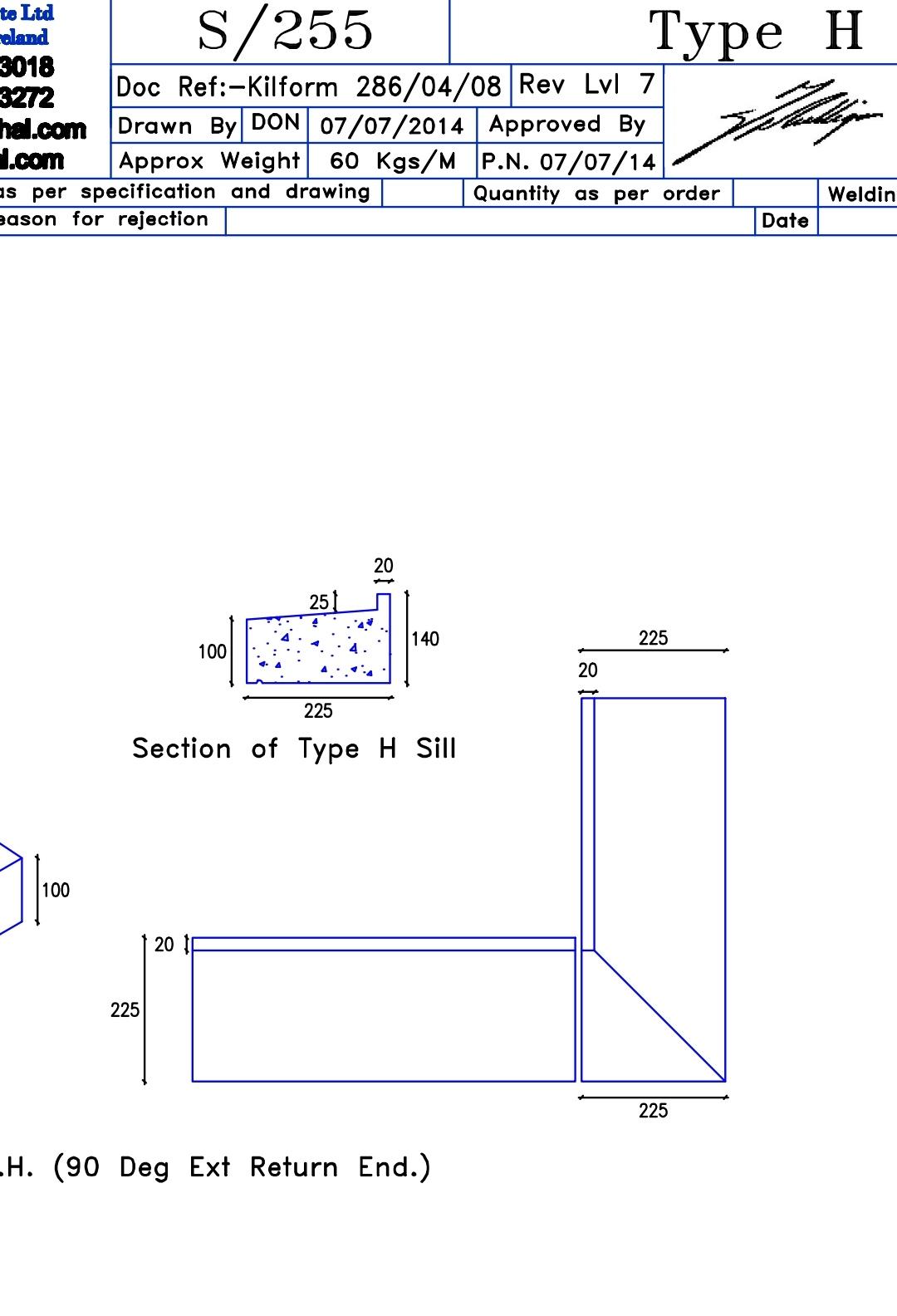

Iceverge Posted February 8, 2021 Share Posted February 8, 2021 @Moggaman get in contact with Killeshal precast in Offaly. I suspect your engineer will specify steel lintels like they did for us for any walls bearing the slabs. With your engineers agreement you can substitute these for precast concrete lintels but they'll need to be specially ordered. We got our window sills from them too so I suspect it won't be an issue if you do it in time . We got the "Type H " as it has a very narrow top lip and allowed a layer of insulation between the inner and outer sills. Out of interest have you chosen your precast slab supplier? Link to comment Share on other sites More sharing options...
