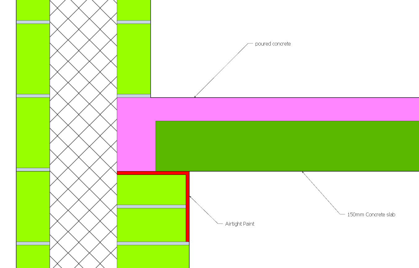

We needed 215 blocks on our inner leaf because we have quite long runs with no buttressing walls internally. I did ask our engineer about reducing block width but he wasn't keen. Also it left us free to have 2700mm ceilings internally. We would have been limited to 12 courses  of 100mm block on edge otherwise. With the dropped ceilings we would have ended up at about 2500mm ceiling height which I thought was too low.
The first floor is 100mm blocks on both inner and outer leaf.
The Precast slab only bears on 100mm of the blockwork anyway. In hindsight we should have airtight painted the top of the bearing blocks,  shuttered around the edge of the slabs and poured the slab and screed as one for airtightness. Forget about any membrane or tray like @tonyshouse did.

3 hours ago, tonyshouse said:
What is the airtight paint doing?
Preventing air leaks through the blocks below the slab. These won't be wet plastered as they are above the plasterboard in line with the suspended metal ceiling.
Also painting the top of the blocks guarantees a continuous unbroken airtightness line to the poured concrete.
