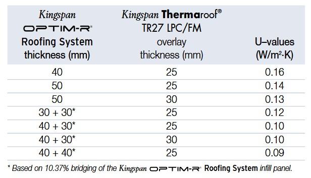

Olf Posted February 3, 2021 Posted February 3, 2021 Actually it is possible: https://www.kingspan.com/gb/en-gb/products/insulation-boards/insulation-boards/optim-r/optim-r-roofing-system 0.007 W/mK, totally airtight and well reflective. Oh, and £££ that makes aerogel a bargain - but sometimes there is economy that makes it the right choice, otherwise they would not market it.
Adsibob Posted February 3, 2021 Author Posted February 3, 2021 On 03/02/2021 at 17:23, Olf said: Actually it is possible: https://www.kingspan.com/gb/en-gb/products/insulation-boards/insulation-boards/optim-r/optim-r-roofing-system 0.007 W/mK, totally airtight and well reflective. Oh, and £££ that makes aerogel a bargain - but sometimes there is economy that makes it the right choice, otherwise they would not market it. Expand @Olf this really is very interested and exciting! (Is it a reflection of the times, or my obsession with my build, that results in me getting so excited about insulation?) Having just searched for it online, I found about 5 retailers who won't commit to a price online, it's all "POA" or "call to enquire". So I guess it's very expensive. But might be worth it given the area of roof we are talking about is actually quite small. Given the Calculator @Ferdinandlinked to above doesn't have this Optim-R system as an option, does anybody know how I would calculate how much I would need to replicate the U value provided by 150mm of PIR with this?
Russell griffiths Posted February 3, 2021 Posted February 3, 2021 That looks very similar to the insulation product from kingspan that I used for a different problem, if it is it was about £40 a metre.
Olf Posted February 3, 2021 Posted February 3, 2021 On 03/02/2021 at 18:18, Adsibob said: how I would calculate how much I would need to replicate the U value provided by 150mm of PIR Expand ~ U-0.16 ( The thinnest (65mm) option is a match On 03/02/2021 at 18:18, Adsibob said: won't commit to a price online, it's all "POA" or "call to enquire" Expand They are made to order, to the exact dimensions - call to enquire seems to be sensible option.
Adsibob Posted February 3, 2021 Author Posted February 3, 2021 On 03/02/2021 at 21:45, Olf said: ~ U-0.16 ( The thinnest (65mm) option is a match They are made to order, to the exact dimensions - call to enquire seems to be sensible option. Expand @Olf, that is really quite incredible that I can save almost 100mm by going for these two Kingspan products or for the aerogel that @Tempsuggested. Now the limiting factor is the rafter. @Russell griffiths you suggested 125mm was the shortest rafter I could use, is that assuming I stick to timber? What about a steel rafter, anyone know how thin short that could be?
PeterW Posted February 3, 2021 Posted February 3, 2021 @Adsibob These are VIPs - Vacuum Insulated Panels. https://www.kingspan.com/gb/en-gb/products/insulation-boards/insulation-boards/optim-r They are bespoke and made to exact size They cannot be cut, drilled or altered on site They have to be protected from damage by another product (Kooltherm In this case) They are expensive - about 3 times the price of the same uValue per square metre of PIR. They are an insulation of last resort. Why do you need to reduce ceiling height ..? You are gaining possibly 15mm as the overlay panels go below the joists and the Optim-R goes between. If you have 150mm joists, you can fill to 125mm with PIR and then use 30mm of Kooltherm over the top to get the same uValue for about 35-40% of the cost of VIPs. 1

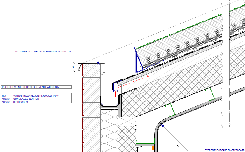

Adsibob Posted February 4, 2021 Author Posted February 4, 2021 On 03/02/2021 at 23:49, Temp said: Can you tell us more about issue? Photos? Perhaps there is a better solution than expensive insulation. Expand @Temp you may well be right. The issue is mainly about increasing the ventilation gap at the top of the cold roof. I'll try and explain what you are seeing below: I have a green roof (the shallow type for very basic plantings). This slopes at approximately 20 degrees down towards a concealed gutter. Then there is a wall which is right on the border with my neighbour's garden. Below the green roof is a cold roof. We are concerned that there is insufficient ventilation because the entry to the ventilation area is itself concealed because it is so close to the concealed gutter. Another issue is that the gutter is so close to the entry that any foliage falling on the gutter might block the ventilation. One way of mitigating these two issues would be to reduce the thickness of the insulation, allowing the ventilation gap (which is currently a channel that is 50mm wide, but with a narrower entry point) to be wider and the entry point to be wider. If we did that, we would probably also drop the positioning of the gutter by 25mm or so. The reason the gutter is concealed is both for aesthetic reasons and because if it was on the other side of the wall it would pretty much overhang the neighbour's property. The design also includes 70mm of resilient bars (the green things between the plasterboard and the 150mm of PIR) but we are doing away with those anyway as I'm not sure sound proofing is essential under this part of the roof, whereas head height is an issue and so we are looking at other ways to increase head height. 1
Temp Posted February 4, 2021 Posted February 4, 2021 Perhaps I've missed it (it is nearly 1am) Im still not sure why you can't just raise the roof say 150mm higher.? Is the roof height limited by Permitted Development rules for the eaves height near a boundary? A window on the side of the house?
Adsibob Posted February 4, 2021 Author Posted February 4, 2021 On 04/02/2021 at 00:51, Temp said: Perhaps I've missed it (it is nearly 1am) Im still not sure why you can't just raise the roof say 150mm higher.? Is the roof height limited by Permitted Development rules for the eaves height near a boundary? A window on the side of the house? Expand It's not PD, it's planning permission. I have planning permission for the height shown, not higher. The reason we are in this position is that we had planned to sink the extension into the ground and drop the floor of our existing house, but we cannot do that to the extent we planned on doing because on exposing the foundations they are shallower than we had expected. So as expensive as aerogel or this special kingspan product is, it's going to be a lot cheaper than underpinning my house!
Russell griffiths Posted February 4, 2021 Posted February 4, 2021 You seam a bit mixed up with this, how can you consider making the roof rafters smaller with the high load from a green roof, the roof loading will be higher than normal. Im afraid I don’t like the design at all, green roof is pointless, gutter details are a disaster waiting to happen, leaf debris building up will lead to the gutter no working correctly and water getting into the structure. Nope, not for me I’m afraid.
Cpd Posted February 4, 2021 Posted February 4, 2021 You had a plan - lowering the floor and building a green roof. that plan is now shot as you don’t want to lower the floor due to cost. you need to go back to the drawing board and start again as your now trying to get a square peg into a round hole. I think by starting to replan with the new restraints you could come up with a better option. Also take on board what Russell has said about the existing design not being best practice. I had a similar situation and had to go down the underpinning route.....
