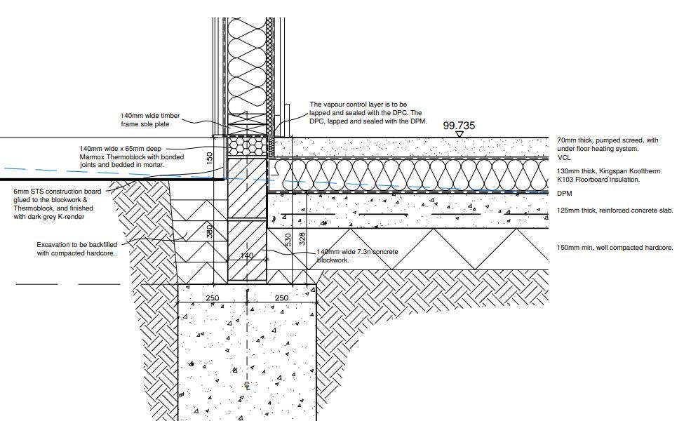

TF wall / floor detail.
Jason L
Morning,

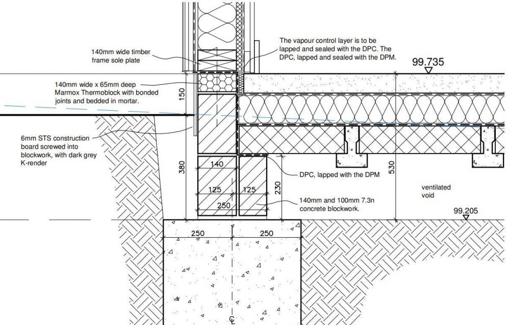

what do you think to my wall / floor junction ?  its a timber frame with K-render on a carrier board on the outside and internally it has 25mm pir insulation, services void and plaster board.
I have shown the beam and block floor on a DPc, bit is this even needed anymore, is it a old detail carried over from when timber floors were used ?
Below the DPC on the outside i have the render carrier board and dark grey K-render to cover the Thermoblock and blockwork ( have been told its ok to use below the DPC )  ..... has anyone got any other ideas for a sheet material to use to face it below the DPC ?
Thanks
Link to comment
Share on other sites
58 minutes ago, Moonshine said:
How are you going to get ventilation to the floor void, i would show the proposed routing of your telescopic vent.

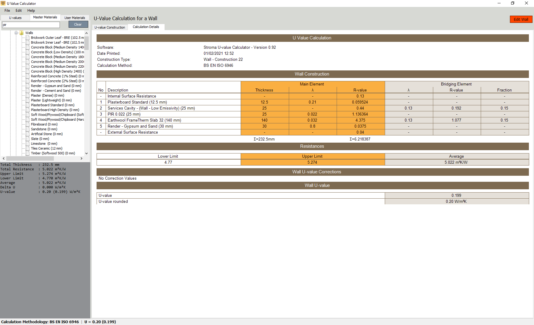

What U-value does those walls give you? it seems a bit on the light side.

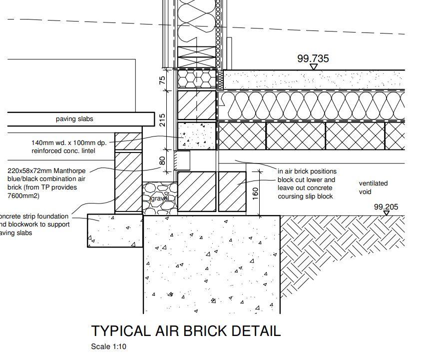

here is the air brick detail,   the SAP guy worked the walls out to 0.13 u-value.
I not sure if that is correct, my quick calc indicates its more like 0.20, assuming 15% bridging by softwood in the mineral wool and the air cavity service void. I am not sure how they came to 0.13!
Link to comment
cheers,  i probably should have said, its 140mm of Recitcel Eurothane GP between the studs and 25mm of it on the inside

14 minutes ago, Jason L said:
i cant see any other way tbh,  what problems can it lead to ?
You use a telescopic vent to bring the air back up to your damp course level.
Problems, the trench you have made around the building can collect with debris leading to water ingress through the vents.
Poor air flow due to vent hidden under ground.
Do you have to have beam and block its a poor floor construction insulation wise.
Link to comment
ahh it never really crossed my mind to not have beam and block, maybe a traditional concrete slab, maybe easier, it will certainly overcome the under floor ventilation thing!

So i have redone the detail with a concrete slab, and it all looks much more sensible now, does away with the awkward air brick detail and  it should be quicker and easier to build thanks for the suggestion.
Any ideas for the facing of the exposed section of block / thermoblock, other than brick slips, its dark grey render at the moment.
Link to comment
I have used some slate tiles in this situation.  They measured about 300mm long by 60mm high by 10mm thick.  Butted up with no grout.
  • Like 1
Link to comment
