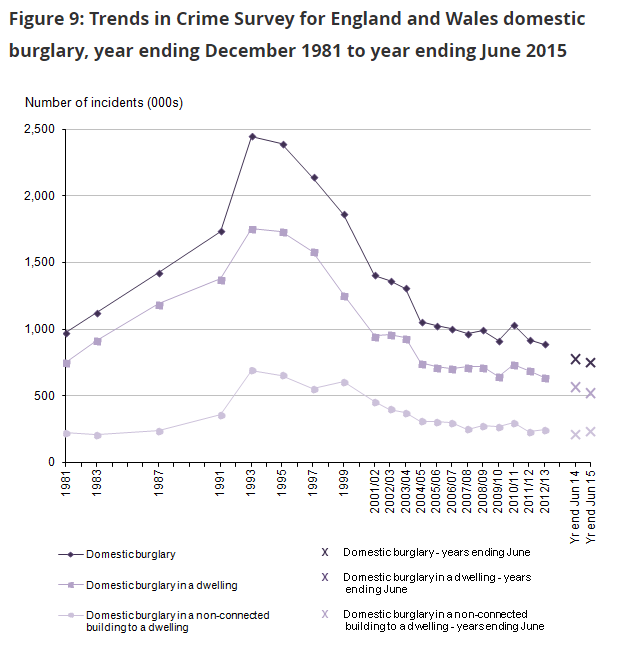

MortarThePoint Posted February 15, 2021 Posted February 15, 2021 I'm dubious about the extra cost myself. I just did a tot up and reckon that just the upgrade to 6.8mm laminated glass will cost >£2k for us. We could have a nice alarm and CCTV system for less than that. The next house is a distance away, so any burglar could happily arrive with a ladder and or sledge hammer and take his time. There's always a weak link and I think I'd rather it was the windows. It wouldn't take someone long to enter a house through the roof tiles if they wanted. You can get away with anything with a high vis jacket and a ladder. Added to that burglary rates are in general decline. A rise in home working, as I expect to for the foreseeable future, makes burglary even less attractive. I'm just feeling bitter about the extra cost though. Here's hoping I haven't tempted fate.
