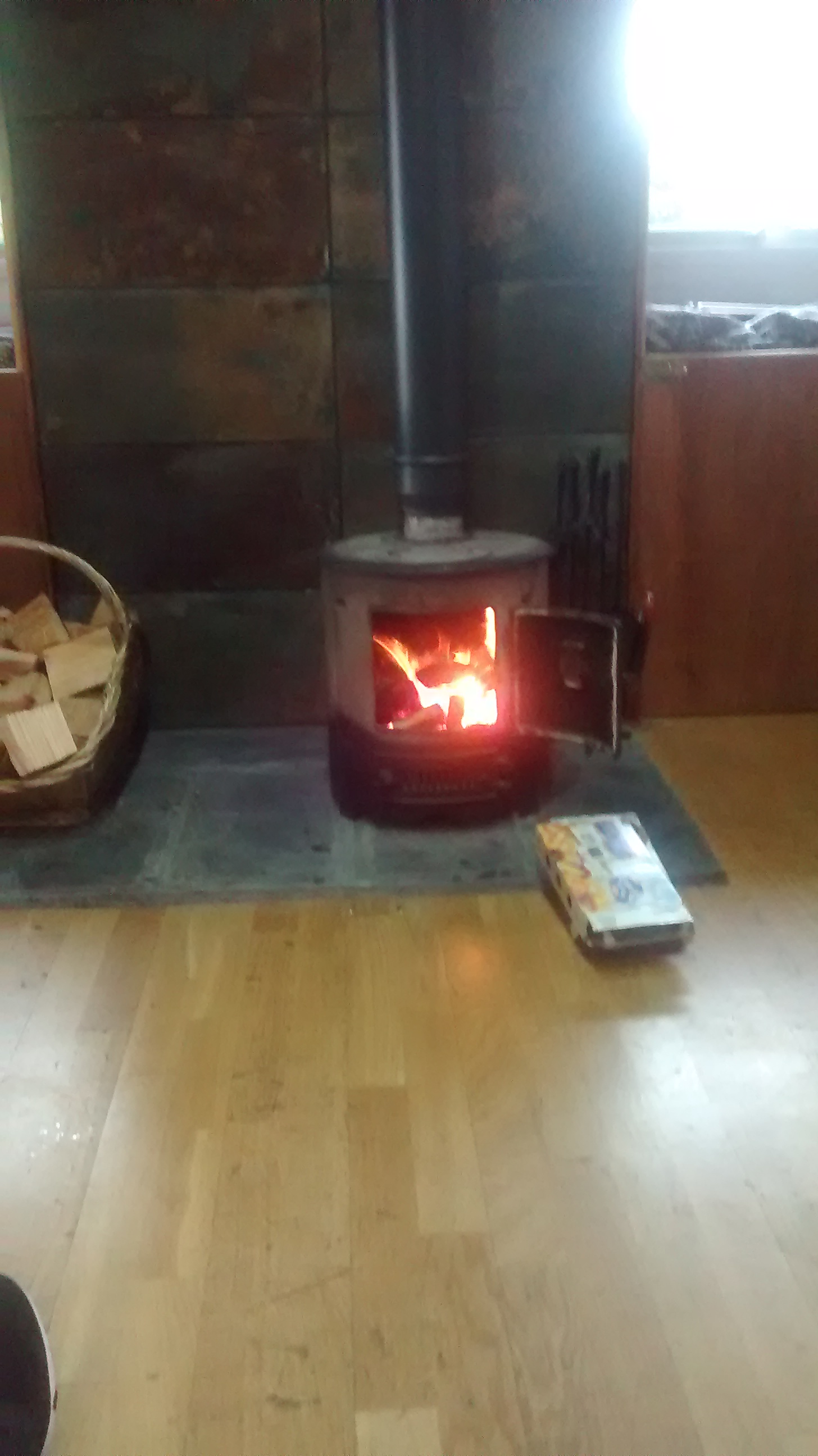

Our Clearview Solution 400 is sitting on a slab of black granite. I went to local monumental stone mason and he had a suitable offcut of kitchen worktop. He put it through his honing machine to take off the gloss. That's sitting on top of engineered wood, insulation and a beam & block floor.

14 minutes ago, Temp said:
The regs say if the stove is certified "not to raise the hearth more than 100C" then you only need something 12mm thick but that 12mm must project above the surrounding floor, it cannot be flush with it. The idea is to stop rugs migrating too close.
Interesting.
Our present house has a constructional hearth (it didn't need it) and one of my design "features" was I didn't want a raised hearth, so the finished, tiled surface of the hearth is dead flush with the surrounding wooden floor.  BC never raised any issue with that.
