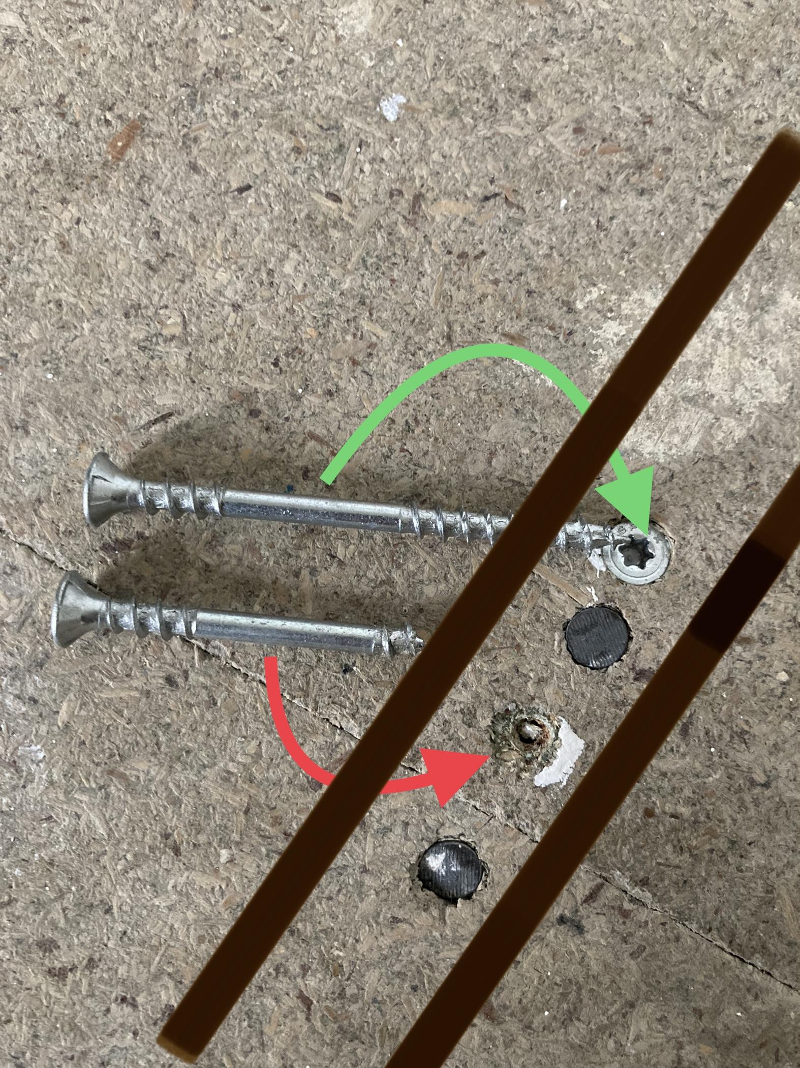

Hi. I’ve bought this screws which you recommend for me. And they actually doing great job. Apart from that one it’s seems like just go half into the floor. There’re is no pipes there so what possibly can go wrong .. asking for friend ?

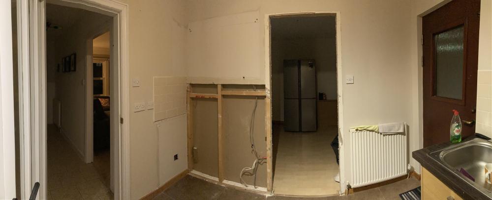

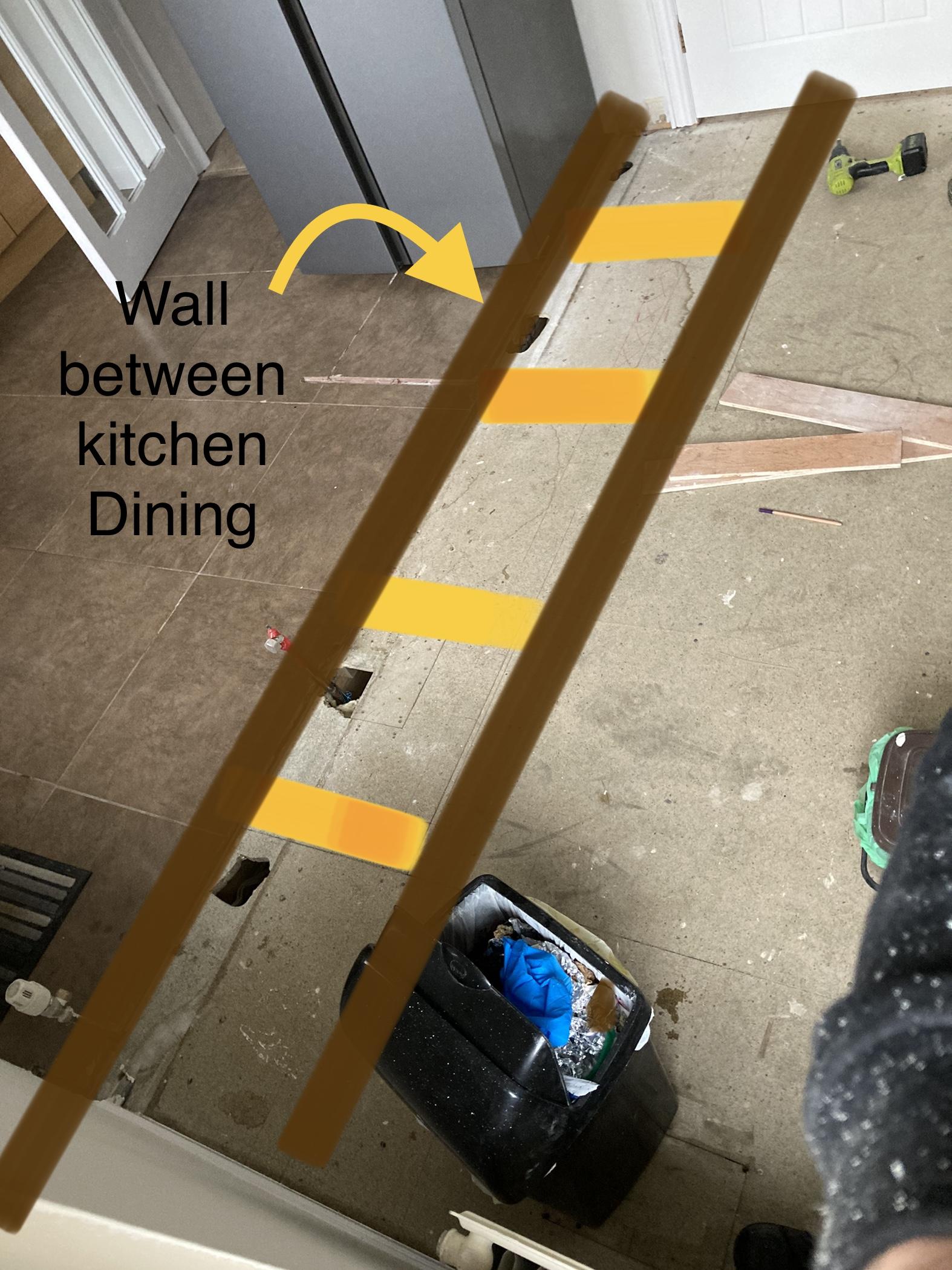

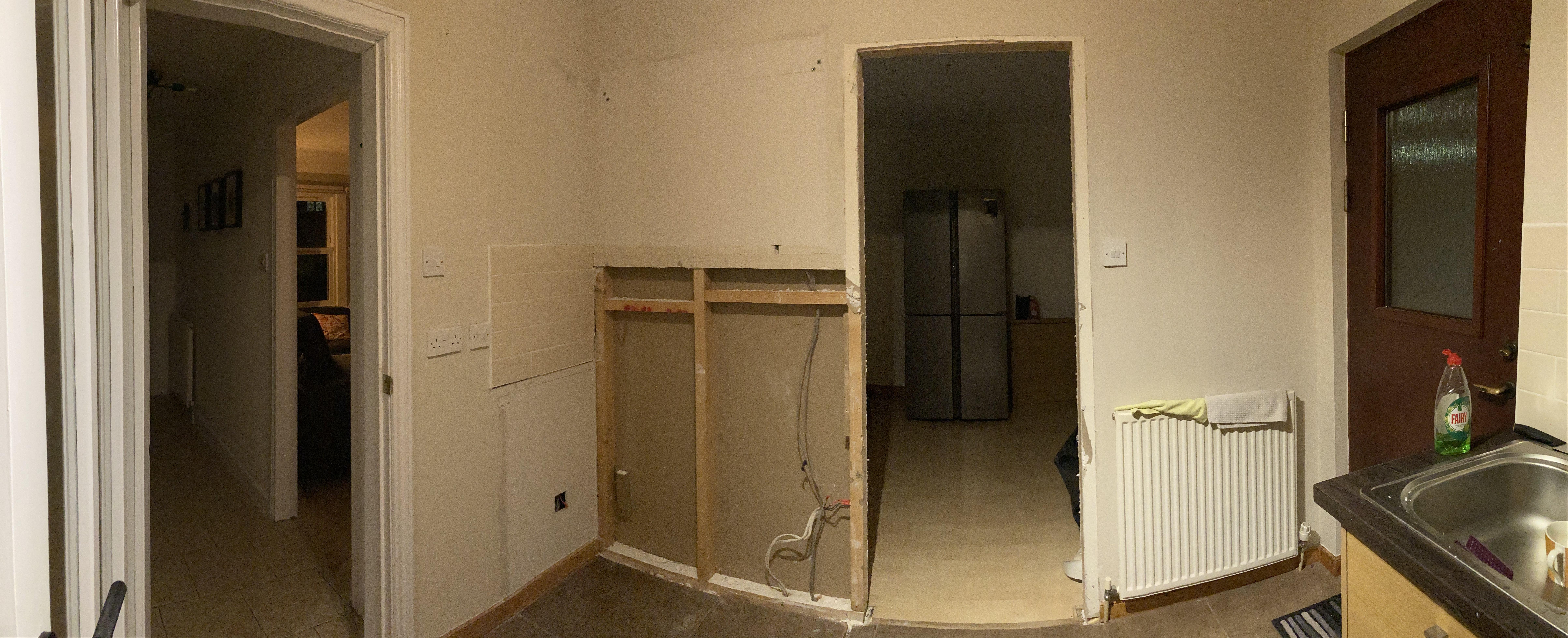

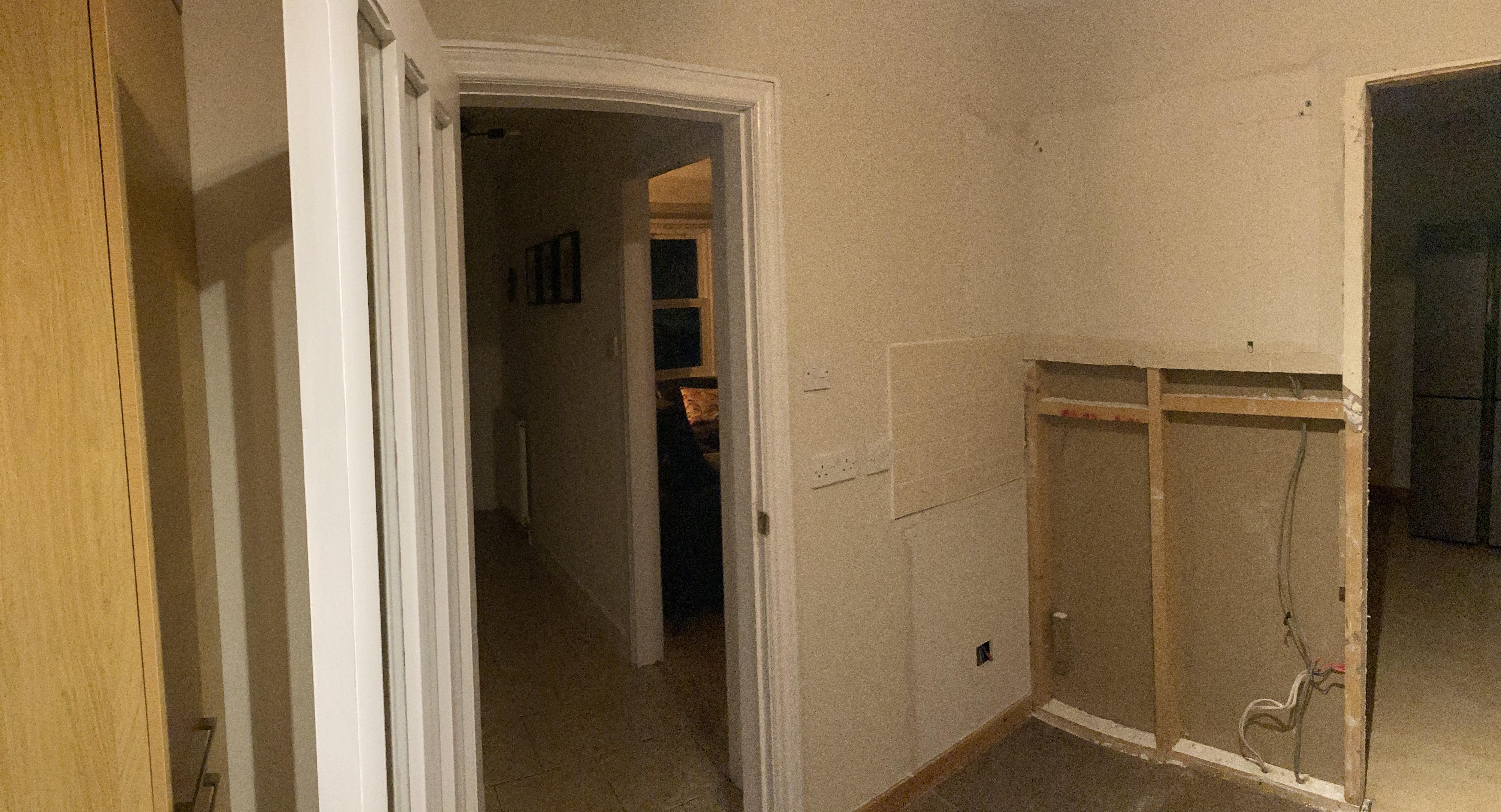

Also guys... so please see picture below. So between kitchen and dining room was wall... was because I knocked it down. Of course architect was involved but he just said I can put this down with no worries. I’m bit sceptical about it now. Is this wall could support anything?

My take with this would be pull out each nail one by one using my ancient slide hammer nail puller, and put screws down the nail hole.  Almost guaranteed not hitting pipes or cables as you are using the same nail hole.
