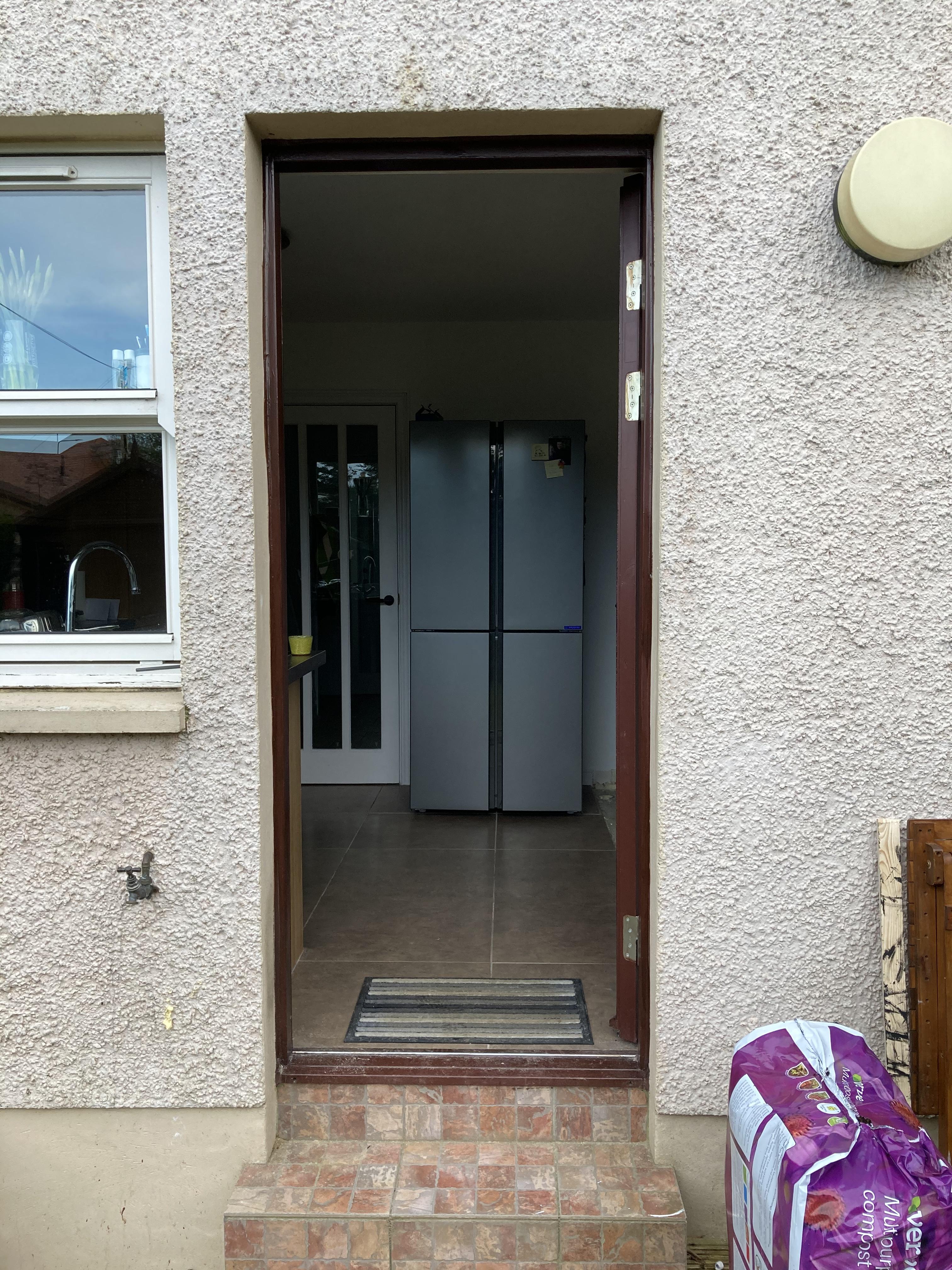

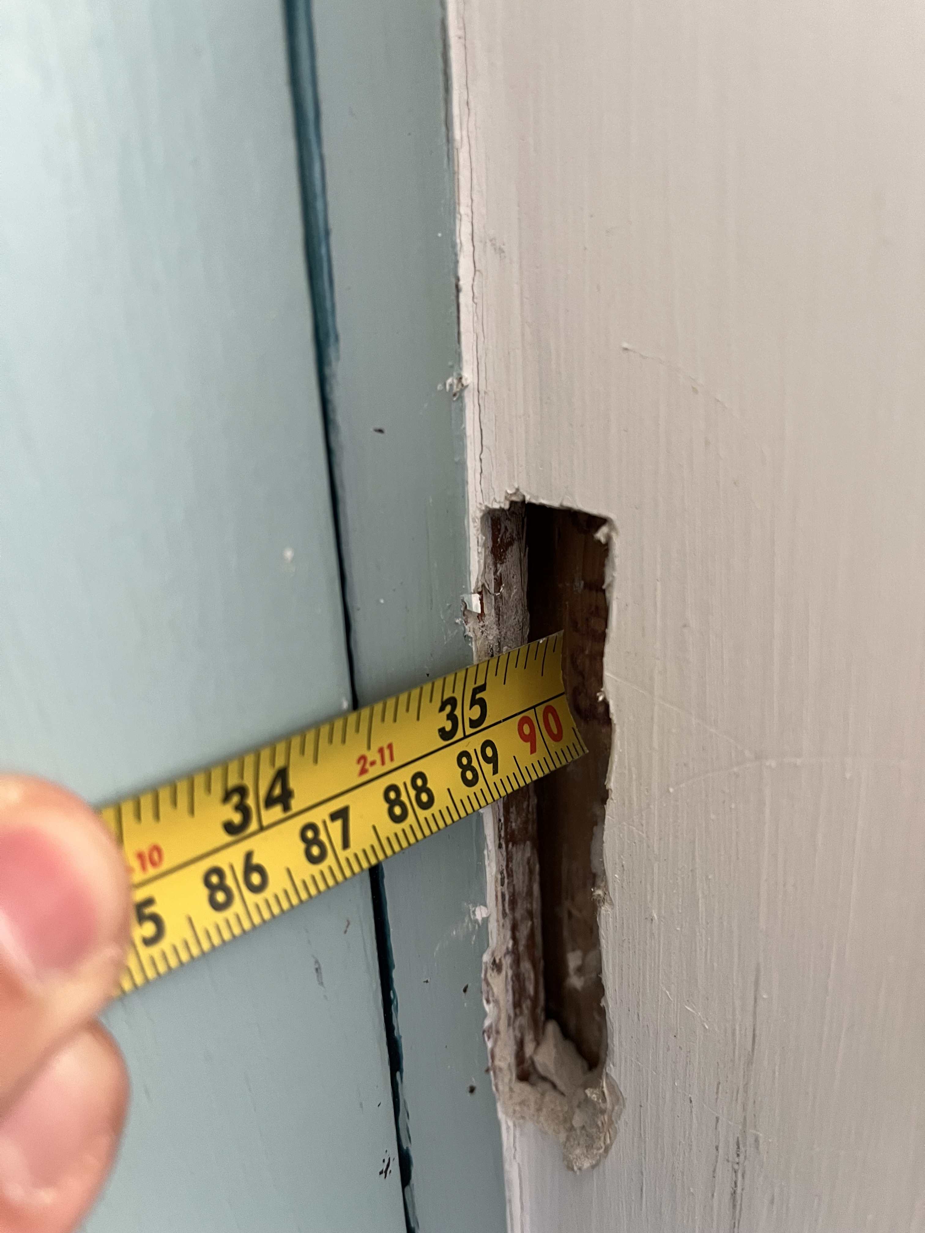

  1. Opening is around 91cm.

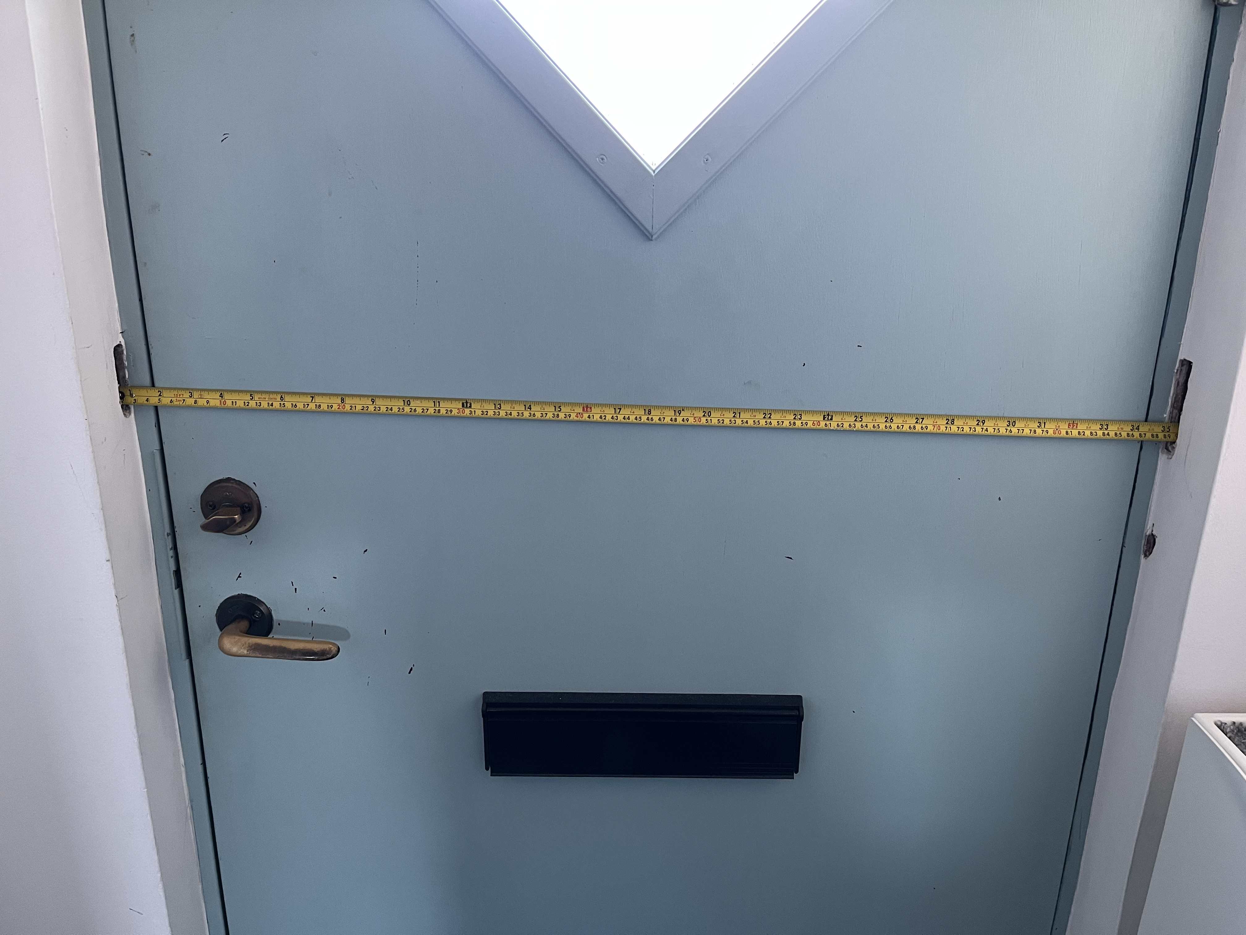

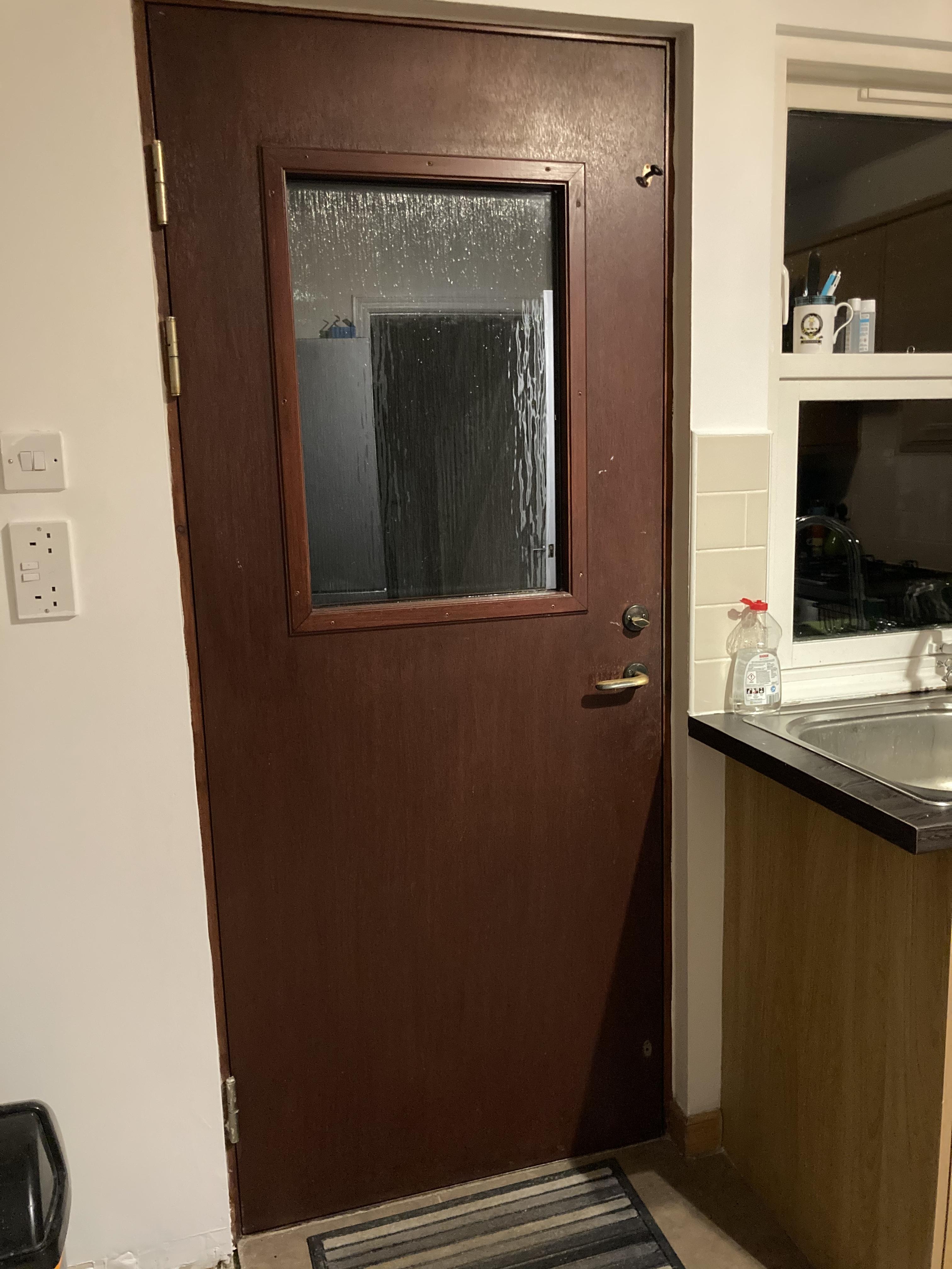

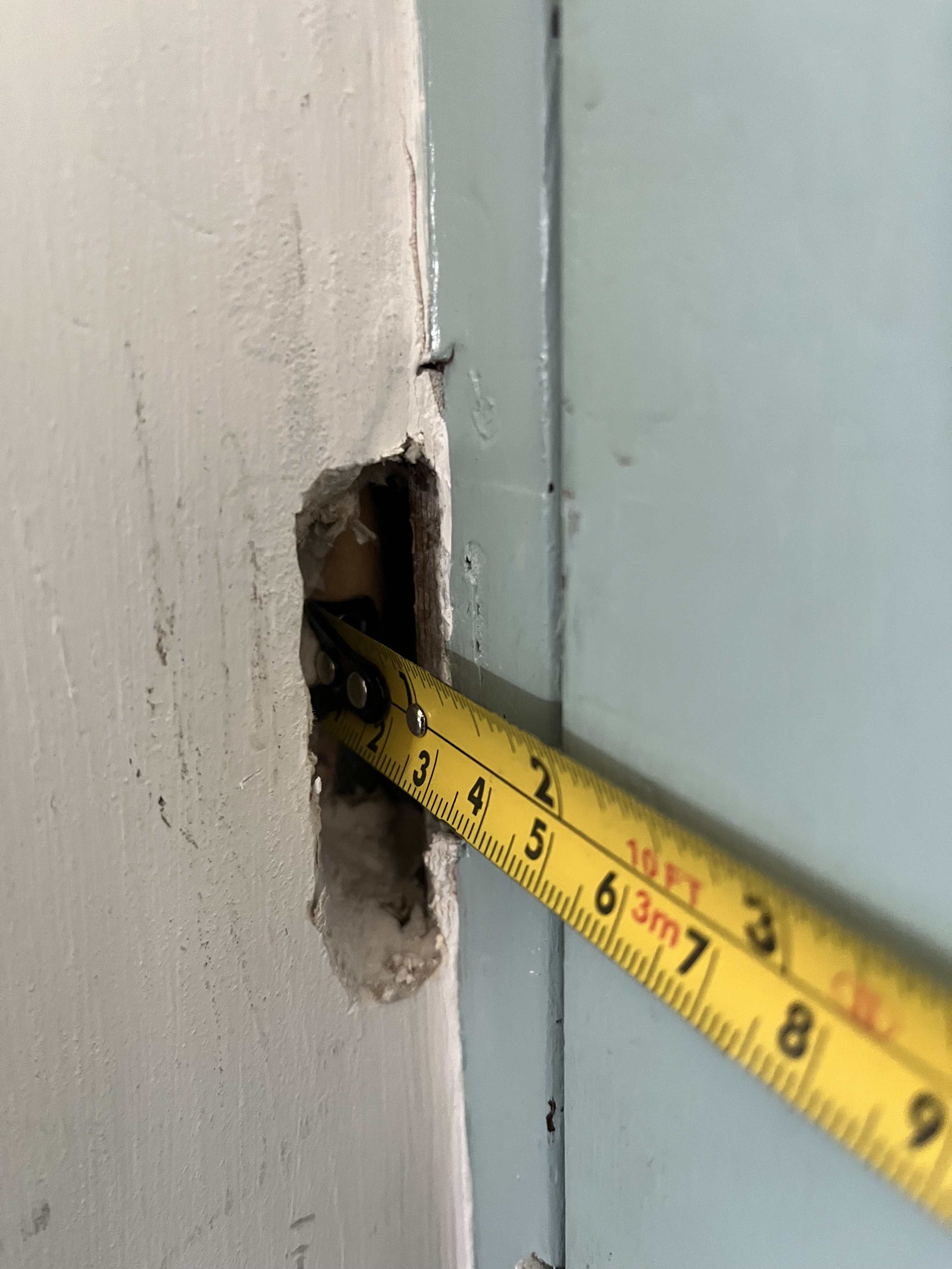

  2. Yes. It’s a big savings but also environmentally conscious decision. Door opening seems to be 1000mm. Current door frame is 888~889mm. How difficult is to fit this door myself ? I
  3. Hi all. Can someone please tell me what gap I should have between door frame and door openning? Currently I have a door which I’m going to replace with new composite door. In width I could possibly fit bigger door. Joiner said 900mm x 2090mm however I’ve found a door which measures 905mm x 2090mm. In my eyes I think I could fit it but there is not going to be much space between frame and studs I think around 3 mm on both sides. Any helpful advice would be appreciated. Bart

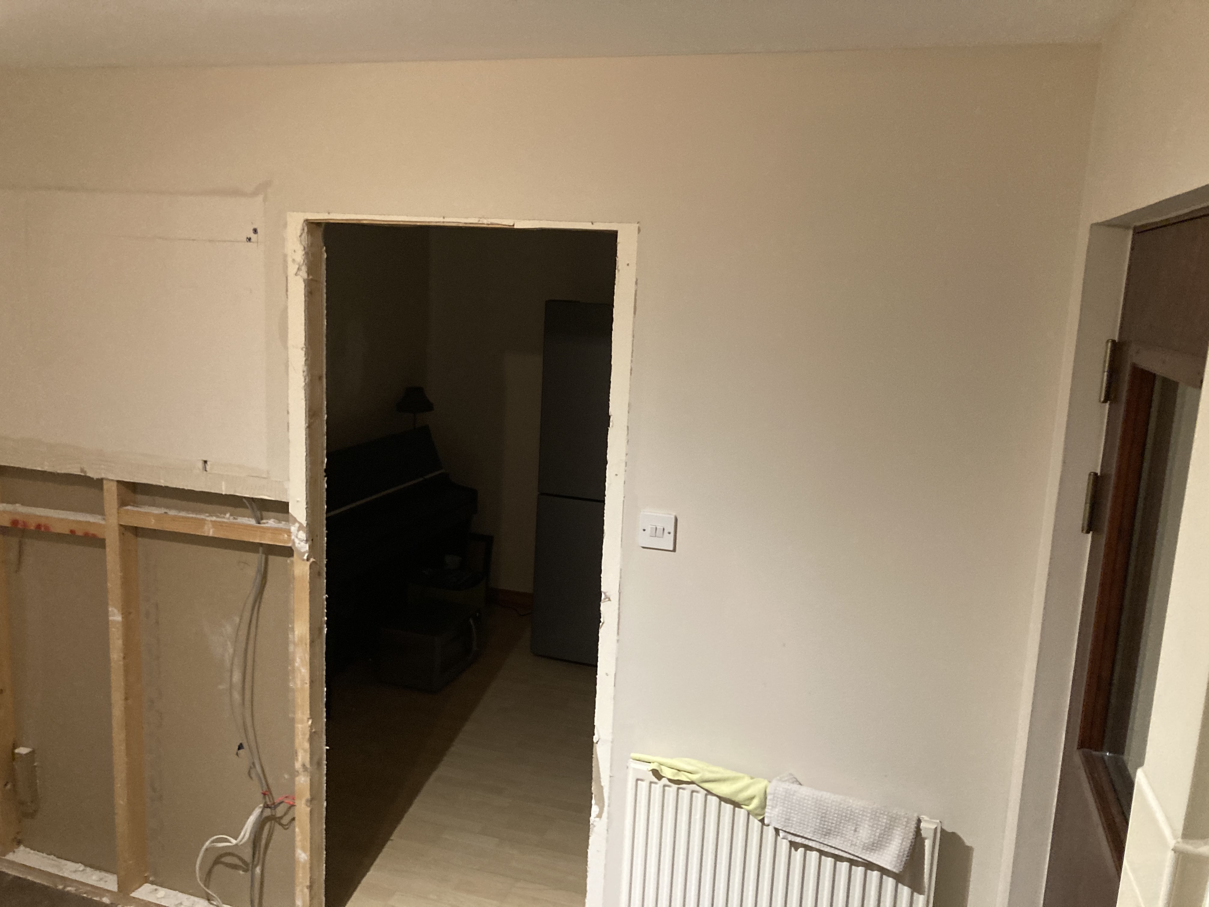

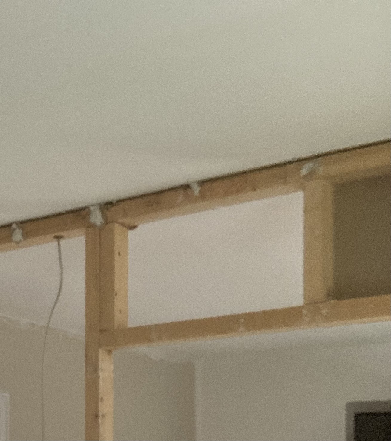

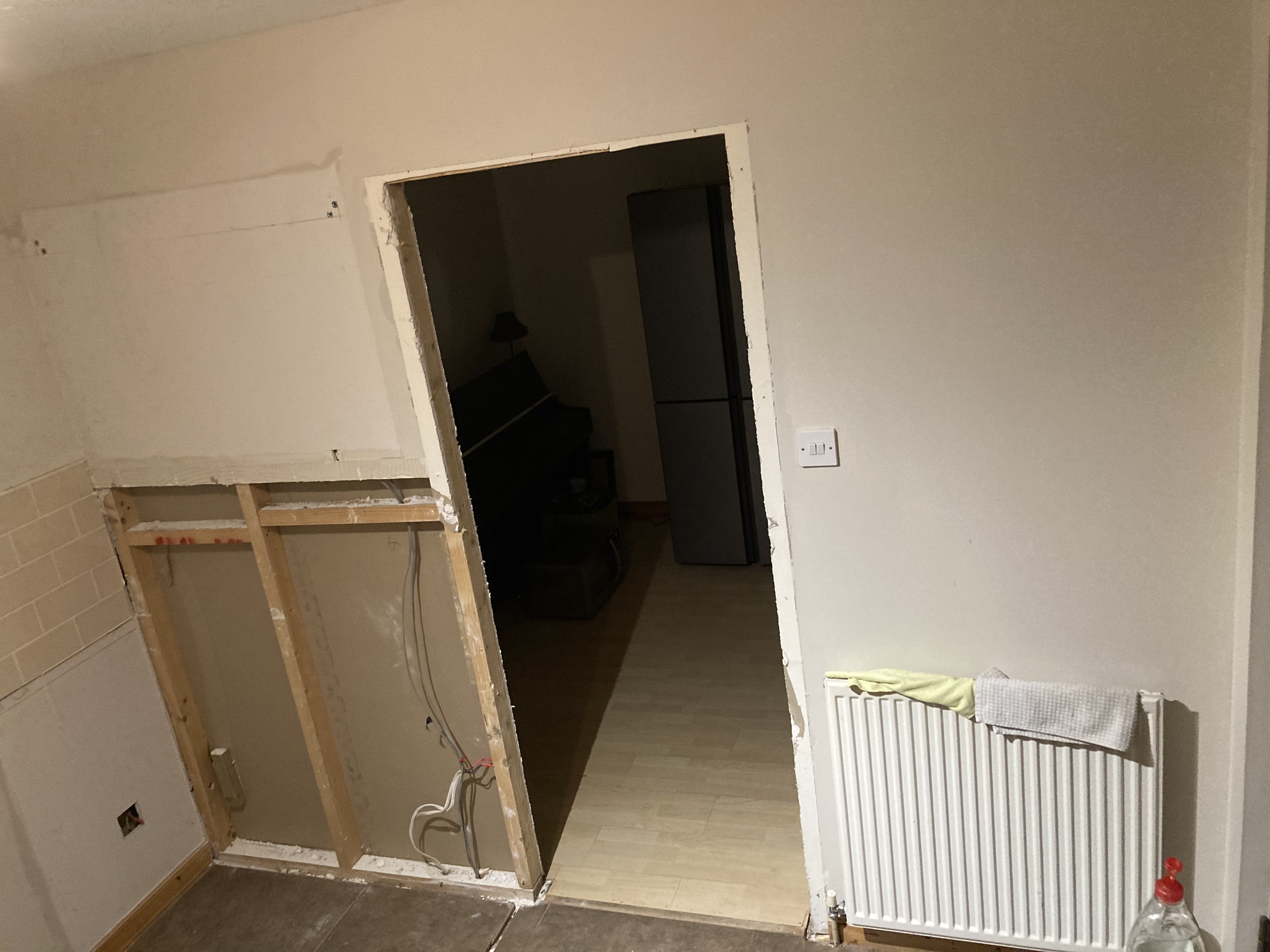

  4. Thank you for your reply. So, above the kitchen and dining area there is a bedroom and bathroom. It doesn’t looks like it’s supporting anything. It’s seats between ceiling beams.
  5. Hi y’all, is anyone can assure me if this wall is a partition wall? Wall is between a kitchen and dinner. It’s/was pretty thin with the doors. Architect who did a drawing for patio doors has said 99% is a partition wall, and we can take it down. Just want to confirm if anyone can tell me more about it. There is no foundation underneath just floor beams which goes same way as wall. It’s fixed with maybe 4 nails in corners and apart from that just sits on floor board. Kitchen doors (outside one) has been blocked off.

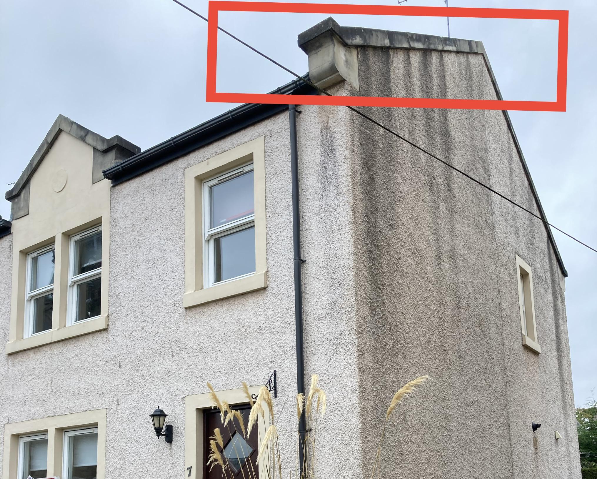

  6. Yeah , that’s right rainwater is causing this marks. And also gaps between capping partly gone due to movement. What I’m thinking of is redoing that gaps and lay down a metal capping on the top of existing. You think using frost/water proof glue like tiles glue will do the job?
  7. Good morning y’all ! I’m trying to sort out this water/dirt marks. So I’m looking for solution what is going to be the best way to fix it. Was thinking of filling up the gaps between this blocks and then lying sort of rubber or fix metal capping with dripping verge on the top of this blocks. House needs a full paint but I’m not gonna do it before I sort it out. Can anyone please recommend how to approach it? Bartholomew

  10. Also guys... so please see picture below. So between kitchen and dining room was wall... was because I knocked it down. Of course architect was involved but he just said I can put this down with no worries. I’m bit sceptical about it now. Is this wall could support anything?
