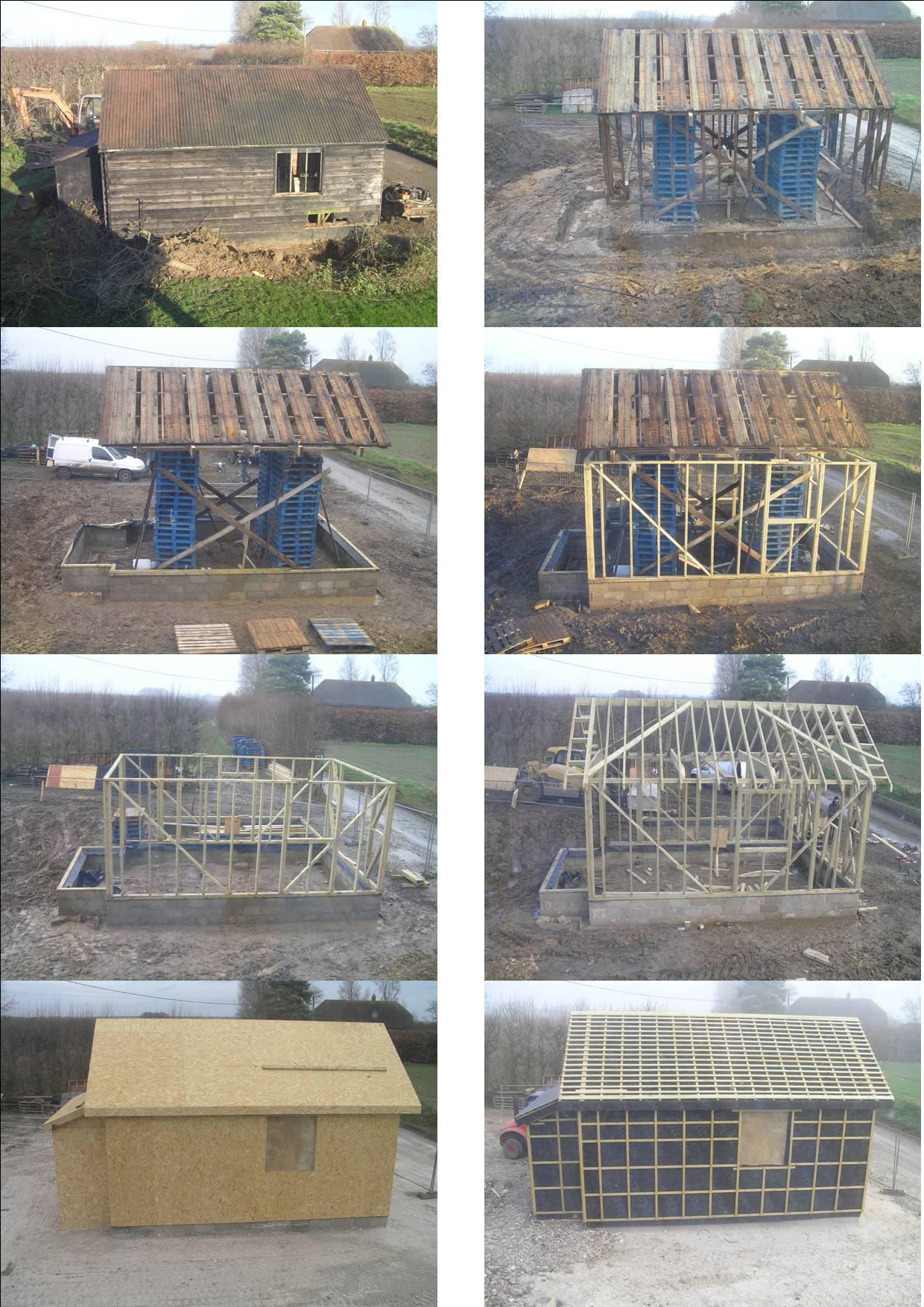

Gone West Posted January 28, 2021 Posted January 28, 2021 On 26/01/2021 at 15:08, Tobster said: Any advice from anyone who has been through similar would be appreciated. There have been several Class Q conversions around here. The farmers nearly always play the game and end up with a nearly new building. They never remove everything in one go, so I would put everything back that you possibly can as it was. This shows a conversion that ended up with a slate roof and white plastic windows, nothing like the drawings. 1

Mr Punter Posted January 28, 2021 Posted January 28, 2021 1 hour ago, PeterStarck said: There have been several Class Q conversions around here. The farmers nearly always play the game and end up with a nearly new building. They never remove everything in one go, so I would put everything back that you possibly can as it was. This shows a conversion that ended up with a slate roof and white plastic windows, nothing like the drawings. So they replaced every element, but it still retains the form and appearance of the original. I guess it does look like a conversion. Love the use of the pallets to hold up the roof. Proper farmer! 1
