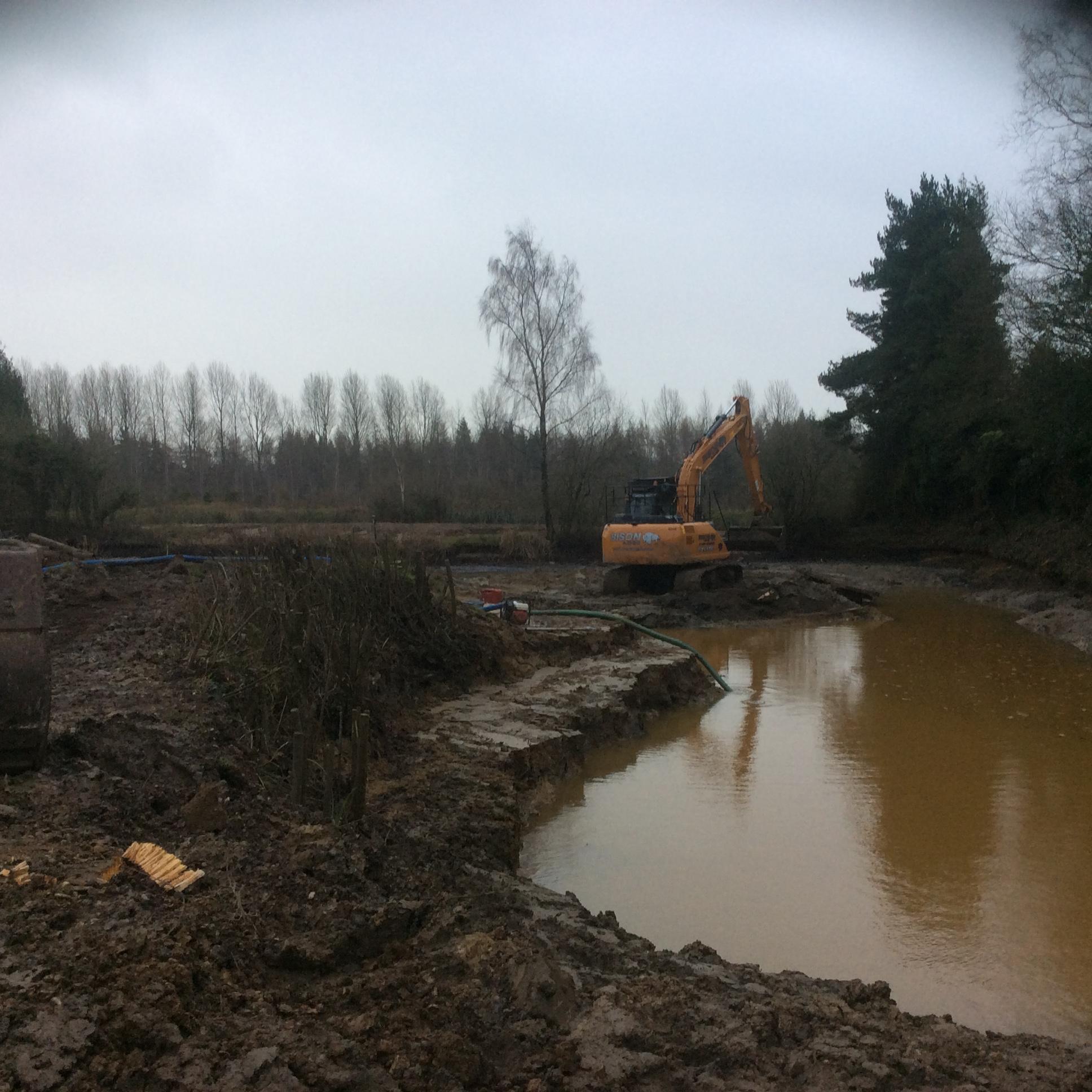

Russell griffiths Posted January 26, 2021 Share Posted January 26, 2021 this is my one. Link to comment Share on other sites More sharing options...
Ferdinand Posted January 26, 2021 Share Posted January 26, 2021 Just now, Russell griffiths said: this is my one. Can you lend him the digger for 15 minutes? Link to comment Share on other sites More sharing options...

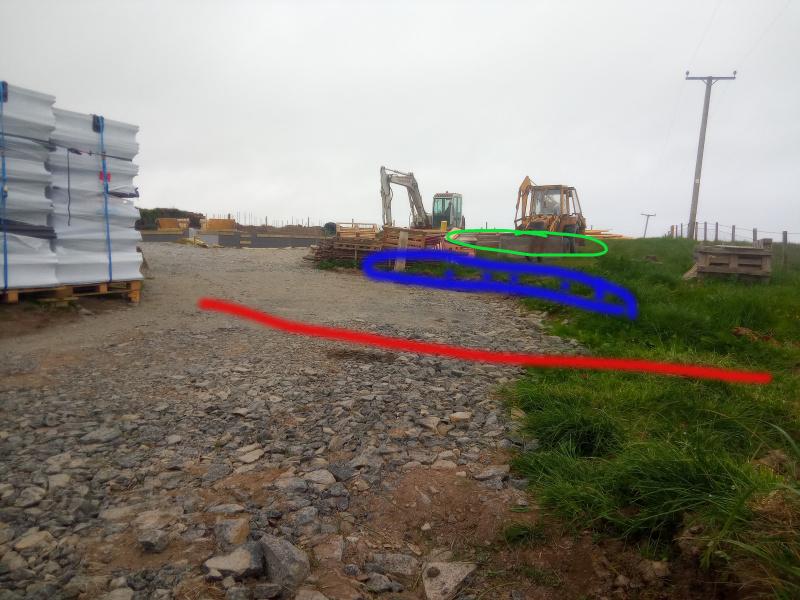

Jenki Posted June 4, 2023 Share Posted June 4, 2023 @ToughButterCup, how did you resolve this, did you end up DIY'ing a solution? Any source of info for design. I have a slope on my site and an existing rubble drain, so would love to create a pond/ wetland area, possibly a swale instead of just burying crates. Link to comment Share on other sites More sharing options...
saveasteading Posted June 4, 2023 Share Posted June 4, 2023 I have done swales with a simple pipe as an overflow. As it is at the top it always has the limited head so it is predictable and calculable. It worked fine. Of course where the water goes next can be important. The point about leaves and blockage is a good one. You could use chicken wire and regular maintenance, or get as complex (weirs and baffles) as necessary. A swale works better than crates as there is evaporation as well as (not in your granite) the soakaway function. Link to comment Share on other sites More sharing options...
Jenki Posted June 4, 2023 Share Posted June 4, 2023 3 hours ago, saveasteading said: A swale works better than crates as there is evaporation as well as (not in your granite) the soakaway function This is what I'm working with. We want a wetland / pond area to the front of the house. This is the track leading to the house, house foundation top left. The red line is an old rubble drain, and my treatment plant uses this. It works well, and now I've put a pond further to the left of the red line ( other side of rubble drain for the plant) it slows down the run off from the field. I think I need to improve the holding capacity a bit maybe some crates at the right side of the red line. I'm thinking the rainwater from the house is directed into a wetland area and run this into a pond (green line), then an overflow from the pond into a swale created near the blue line, this eventually running into the existing rubble drain, if it hasn't already gone, all the land to the right drops towards the coast, 500M. So looking for design details so I can spec this up and satisfy my BCO, who is ok to work with. I'm more leaning to pond then overflow to soakaway for BCO, but implement the above. Link to comment Share on other sites More sharing options...
jamieled Posted June 5, 2023 Share Posted June 5, 2023 @Jenkithe suds manual might be a useful place to start for some detail. I use this for schemes approved by building control. Item Detail (ciria.org) 1 1 Link to comment Share on other sites More sharing options...
saveasteading Posted June 5, 2023 Share Posted June 5, 2023 13 hours ago, Jenki said: pond then overflow to soakaway 1 hour ago, jamieled said: suds manual It is worth writing your strategy with references to the suds hierarchy. Makes it easy for the bco, or planners, to accept without passing on to another party. Bottom line....no more water running off site than always has, perhaps less. And spreading it out and delaying it as you propose may even reduce problems downhill. A French drain parallel to the slope is a cheap and easy soakaway, and often the best. 1 Link to comment Share on other sites More sharing options...
