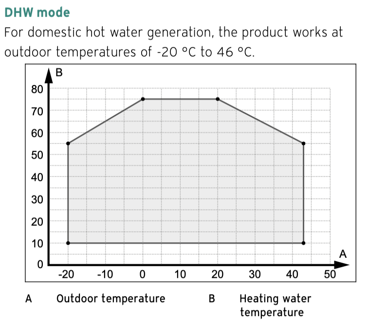

ash_scotland88 Posted January 22, 2021 Share Posted January 22, 2021 In my constant internal debate of gas vs ASHP for our new (old and no CH) house latest research lead me to the arotherm plus, promising a whole world of wonders. What confuses me is the 190L UniTower it launches with claims to provide enough hot water for a 5person house, or atleast one product launch I read about it last night did - typically when I try to find the article to link to I can't. How can 190L provide so much hot water, if true? Is it because 75C water temp will be mixed with cold water at the shower, if so for higher efficiency and COPS isn't it better to have a larger tank stored at a lower temperature? Interestingly the CH flow rate is only upto 55C which may not be hot enough for some of the retrofit properties it advertises for, or am I wrong in this presumption? Any-one have any general thoughts about this product? Link to comment Share on other sites More sharing options...
ProDave Posted January 22, 2021 Share Posted January 22, 2021 190L at 55 degrees won't do a 5 person house. Who claimed that? Vailant themselves or some third party? You won't get much more than 55 degrees from an ASHP you either need over sized radiators to work with that or under floor heating. If it is an old house, make sure you really know how much heat you need, most disappointment seems to be when you need a lot more than you think and the chosen ASHP can't deliver it. 1 Link to comment Share on other sites More sharing options...
ash_scotland88 Posted January 22, 2021 Author Share Posted January 22, 2021 21 minutes ago, ProDave said: 190L at 55 degrees won't do a 5 person house. Who claimed that? Vailant themselves or some third party? I really wish I bookmarked it last night, it was a third party site announcing the launch, I knew deep down this is was wrong but wondered if having a high water temp could help with this claim or if the unitower could top up with hot water upto a certain point before tank was drained, eg for every 1L used it could refill with 0.5L till the tank was cold. 23 minutes ago, ProDave said: You won't get much more than 55 degrees from an ASHP you either need over sized radiators to work with that or under floor heating. If it is an old house, make sure you really know how much heat you need, most disappointment seems to be when you need a lot more than you think and the chosen ASHP can't deliver it. Until we are in the house we can't do calc's to really know what is required, beyond the EPC from the home report but the more I read and the more I think about it about it I do think it will be gas in the end. It's the safer option. I'm coming to think unless three (minimum for quotes) heating installers quote a ASHP could heat the house comfortably and have spare capacity if we ever decide to take up naked sweatbox yoga in the house* then it's too much of a risk. To give you an idea the lounge is 6.5mx5.5m (at the biggest points) with a box window and two patio doors and fireplace, not exactly air tight. *exaggeration, it's only fun when in a class.... Link to comment Share on other sites More sharing options...

ProDave Posted January 23, 2021 Share Posted January 23, 2021 So what refrigerant is this using to get to 75 degrees? And can it still do that when it's very cold? e.g -15 here this morning (new record for us) so it would be trying to heat DHW to 90 degrees above air temperature. Link to comment Share on other sites More sharing options...
A_L Posted January 23, 2021 Share Posted January 23, 2021 1 hour ago, ProDave said: So what refrigerant is this using to get to 75 degrees? The Arotherm plus uses R290 (Propane) 1 Link to comment Share on other sites More sharing options...

J1mbo Posted March 7, 2021 Share Posted March 7, 2021 (edited) IIRC MCS only allows certification to 55°C for heating. However the Arotherm Plus can and does provide 75°C flow if so configured. It is used for the weekly legionaires program for DHW, if enabled (which it should be). The SCOP numbers assume weather compensation. it does not deliver 55°C at a COP of 3.4. It does provide 44°C at 0°C at about 3.2. The max output tables give the actual COP at 55°C, which IIRC is about 2.4. The SCOP is higher as most the year it will be running lower, although I don't know the parameters against which it is calculated. The system has various options of DHW. I've ended up with a 250 litre tank running in 'normal' mode with 5 persons that like showers and a tank set point of 48°C. This allows the HP to put more kW into the cylinder as it's being used as the temperature is lower, leading to shorter recharge times. At 65°C it's probably 1:1 so max of about 10 or 11kW. At lower temps it can produce 15kW and more. HTH Edited March 7, 2021 by J1mbo Link to comment Share on other sites More sharing options...
PeterW Posted March 7, 2021 Share Posted March 7, 2021 Just now, J1mbo said: It is used for the weekly legionaires program for DWH, if enabled (which it should be). Why...?? Link to comment Share on other sites More sharing options...
J1mbo Posted March 7, 2021 Share Posted March 7, 2021 HP are typically configured for DHW storage below 60°C (significantly below in my case), so a weekly sterilisation process is needed. Traditionally this was done with an immersion but with R290 the HP can do it itself and with COP > 1, so more efficiently. Link to comment Share on other sites More sharing options...
PeterW Posted March 7, 2021 Share Posted March 7, 2021 1 minute ago, J1mbo said: This allows the HP to put more kW into the cylinder as it's being used as the temperature is lower, leading to shorter recharge temps. At 65°C it's probably 1:1 to max of about 10 or 11kW. At lower temps it can produce 15kW and more. That isn’t correct. You can’t create energy, and a heat pump works by incremental heat increase to the flow and it is when the output temperature is above 45°C then the units are only able to add 1-2°C to the water circulating. The pump is a constant flow so the heat introduced to the tank - or the J/hr - is not linear as the deltaT reduces at higher temperatures. This is why heat pumps have temperature curves, not linear constants due to thermodynamics. Link to comment Share on other sites More sharing options...
PeterW Posted March 7, 2021 Share Posted March 7, 2021 4 minutes ago, J1mbo said: HP are typically configured for DHW storage below 60°C (significantly below in my case), so a weekly sterilisation process is needed. No, it’s not...!! There is no legal - in building regulations or water regulations (WRAS) - to provide a legionnaire cycle to a domestic installation. There are no recorded instances of Legionella in a domestic environment - none. It is a closed system with no way for air or bacteria to enter the system. 1 Link to comment Share on other sites More sharing options...
J1mbo Posted March 7, 2021 Share Posted March 7, 2021 1 minute ago, PeterW said: No, it’s not...!! There is no legal - in building regulations or water regulations (WRAS) - to provide a legionnaire cycle to a domestic installation. There are no recorded instances of Legionella in a domestic environment - none. interesting, so the manual is erring on the side of caution then. I will adjust accordingly. Link to comment Share on other sites More sharing options...
