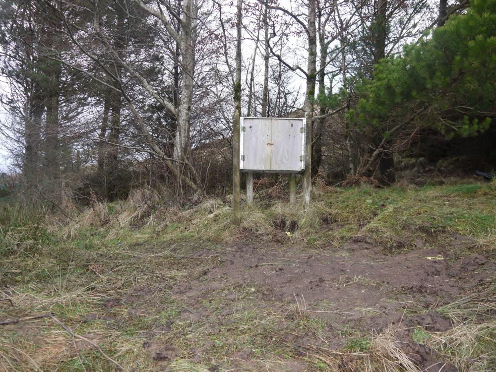

SimonD Posted January 21, 2021 Posted January 21, 2021 2 hours ago, BadgerBadger said: At what stage in the build would contractors generally be expecting an electricity supply to be available? I know for a temporary supply we'll need a kiosk (or similar) with meter for the provider to connect to, we have electricity on poles right next to site so hopefully this will be relatively straightforward. But what would contractors expect to connect to? Would it just be a consumer unit with a few 230V 16A sockets at the kiosk, or something else with 110V transformers, site distribution etc.? Thank you! As @ProDave says, get it in as part of the intial enabling works so it's ready. There's nothing more frustrating that needing some power and having to sort out and run a generator. Our utility company provided the specs on the temporary electrics setup which basically came down to a large peice of marine plywood on fence posts with two boxes attached, one for the meter and the other for a consumer unit. The two are linked with long tails. My electrician then asked what I wanted in terms of supply and just wired up a few different sockets inside the box on separate rings, a couple of outdoor sockets as well as a ring to the garage. With sockets the choice is yours really, oh, and try and get as many sockets as you can!
Thedreamer Posted January 21, 2021 Posted January 21, 2021 Get the electricity in as early as possible. We had ours done and quite a bit before the build. The connection quote jumped considerably and I was happy paying a minimal standing charge. This box was whipped together from scraps and SSE were happy.
