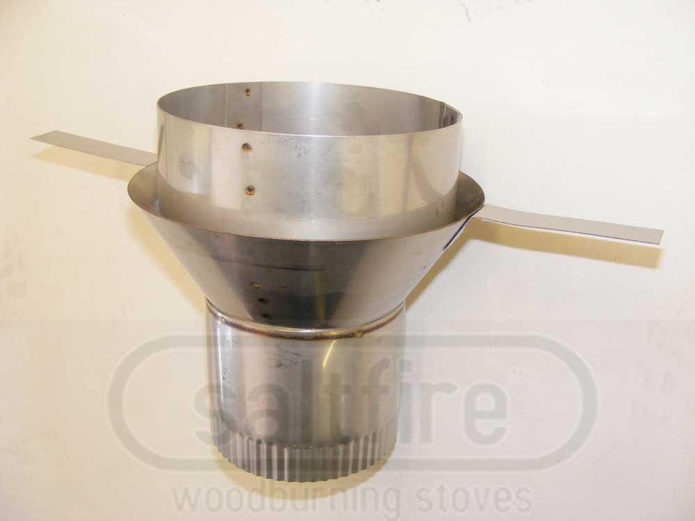

Temp Posted January 20, 2021 Share Posted January 20, 2021 (edited) Officially wood burners are meant to be installed by a Hetas improved installer otherwise you need Building control Approval. So perhaps get one to come check it out. Some builders cast a concrete slab/lintel with a pumice liner block/tube through it above the alcove. Above that there are more tubes suffounded by insulation and around that the square or rectangular stack built from building blocks. These change to bricks in the loft. If that's what you have it might be fine. The pumice liner tubes we used are 225mm in diameter approx. Below the pumice liners/slab you need an adaptor. This is called a register plate as @ProDave mentioned. Sometimes they are just a stainless steel plate with pipe through it that matches your stove. The plate is sealed and screwed to the underside of the slab/lintel. Sometimes they also have a little door in to aid sweeping but only if the chimney is a lot bigger than the stove pipe. In other cases the register plate is more like a funnel. Thats the type we have. It adapts the pumice liners to the stove pipe. You can get them in standard sizes or made to order online. Wood burners produce tar that can run down the chimney so the pumice liner should fit inside the register plate/funnel and the register plate/funnel should fit inside your stove pipe. Special fire cement is used to seal these joints. Below the stove you have the hearth. This has to be one of two types depending on the stove... 1) If the stove is certified that it cannot raise the hearth over 100C then you only need a slab of something non combustible like granite, slate or glass. It must be a larger than the stove to catch any embers that fall out. Must also be 11mm higher than the floor in the room to discourage rugs from migrating too close. We used some 20mm black granite kitchen work top i found at a local stone masons. He honed the top so it wasn't glossy. 2) if the stove isn't certified as above you need a "constructional hearth" that is typically a thick slab of concrete in the floor. I forget if it has to be 125mm or 225mm thick. More on that if needed. As I mentioned the hearth has to be bigger and project out the front of the stove. This info can be found in Approved Document J Page 38 Diagram 26a. https://www.gov.uk/government/publications/combustion-appliances-and-fuel-storage-systems-approved-document-j Edited January 20, 2021 by Temp Link to comment Share on other sites More sharing options...

Temp Posted January 20, 2021 Share Posted January 20, 2021 Example funnel type "register plate" adaptor for pumice liners.. https://www.woodburningstovesdirect.com/product/232/clay-liner-adaptor-internal.htm 1 Link to comment Share on other sites More sharing options...
