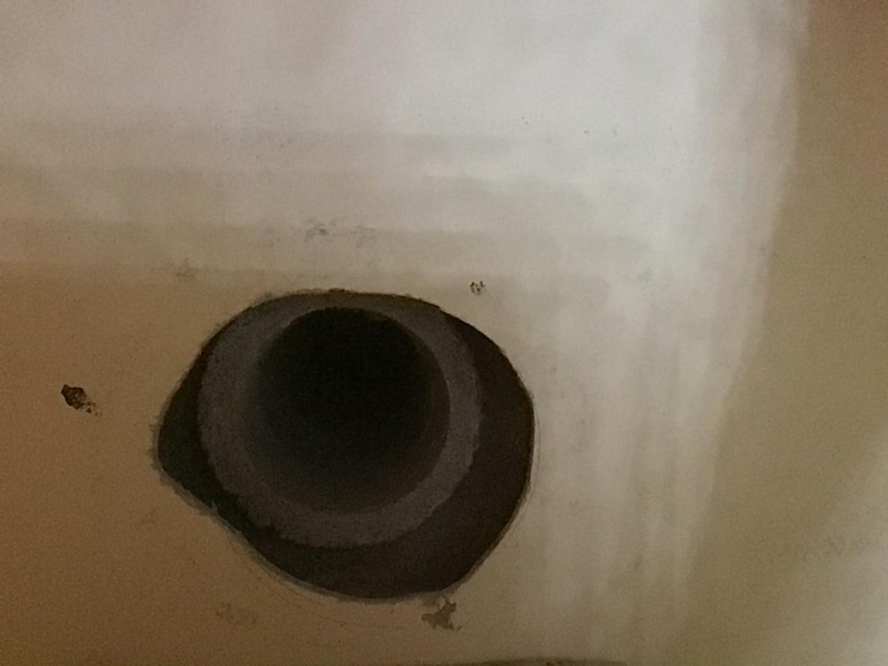

  1. Thanks for the replies guys especially ‘Temp’ for all time plus the detail and photo that really helps. I’ll take a look at the stoves you recommend and links. I spoke with the foreman today, Its the pumice liner block arrangement. No requirement for metal flue. Sides concrete as is floor. Im fairly practical so I think will do the hearth first to the standards.

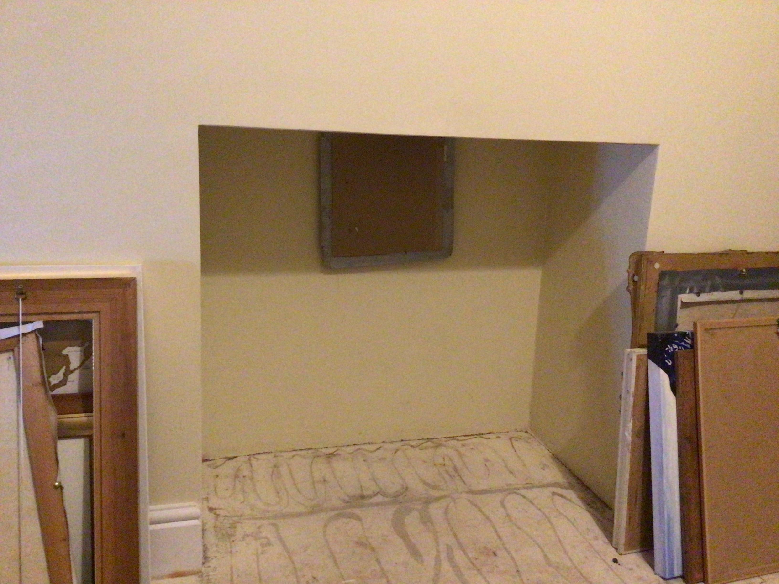

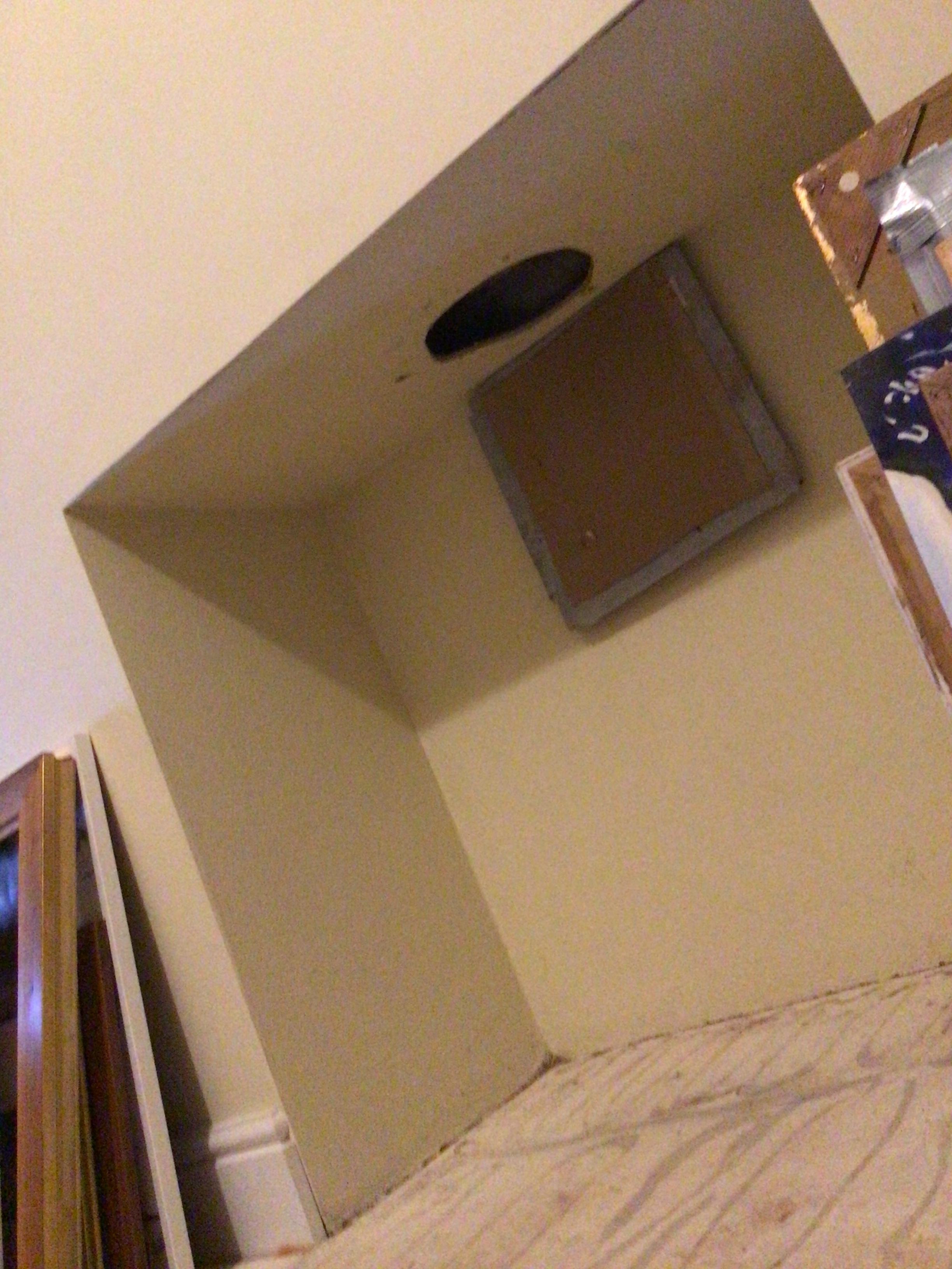

  2. Fire away - like it! well here goes Just moved into a new build house complete with chimney. The room fire place opening is on concrete floor. As I feel or touch the sides of the opening I think its concrete. Looking up Just above a thin barrier sheet into the opening there is circular grey brick or block work tube chimney all the way up . Its got a flap of cardboard temp covering the circular cut-out at the moment. My first question is does it need a metal flue, does the fire attach somehow to that brick tube. Ill try an attach photos.
