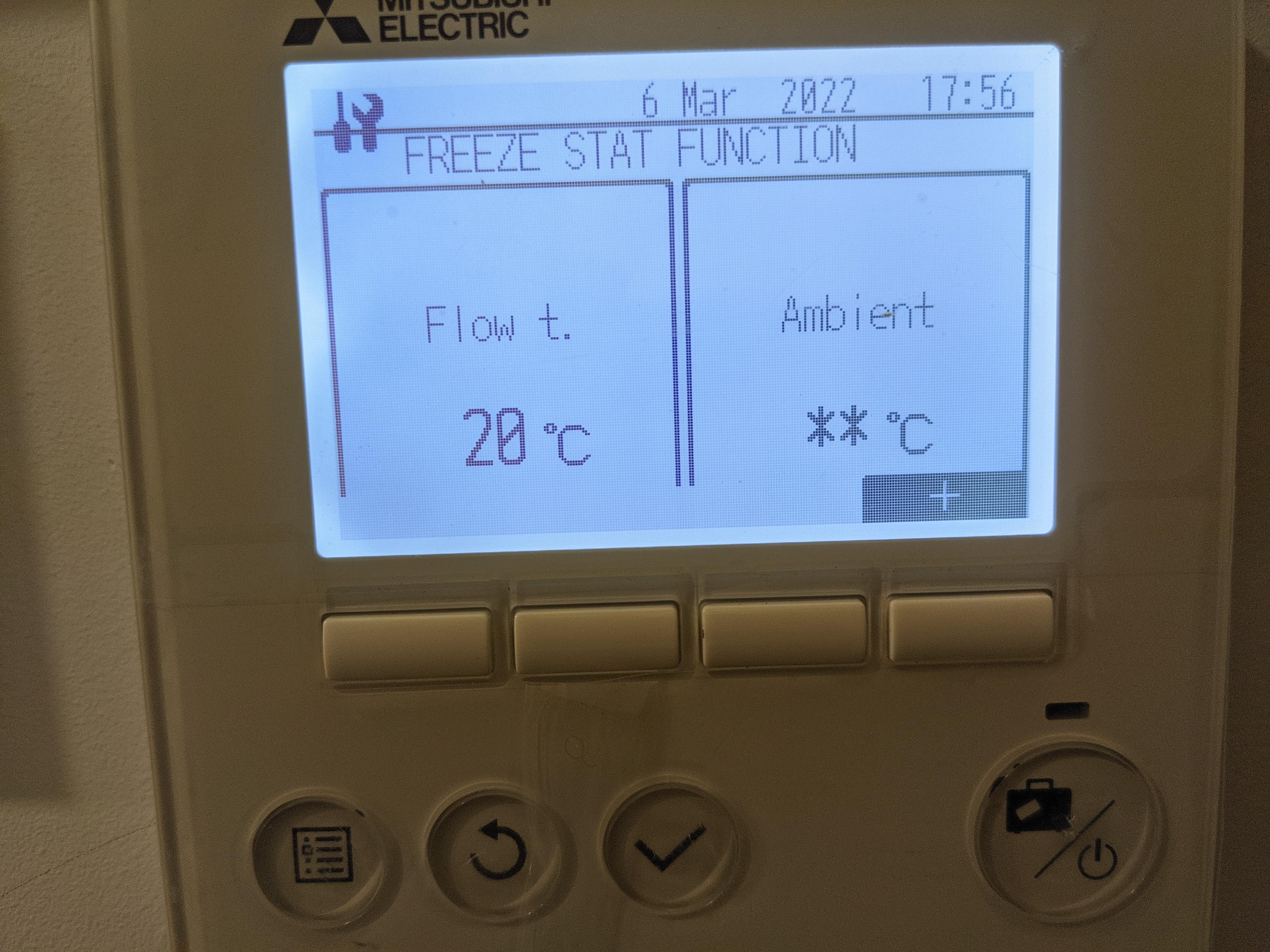

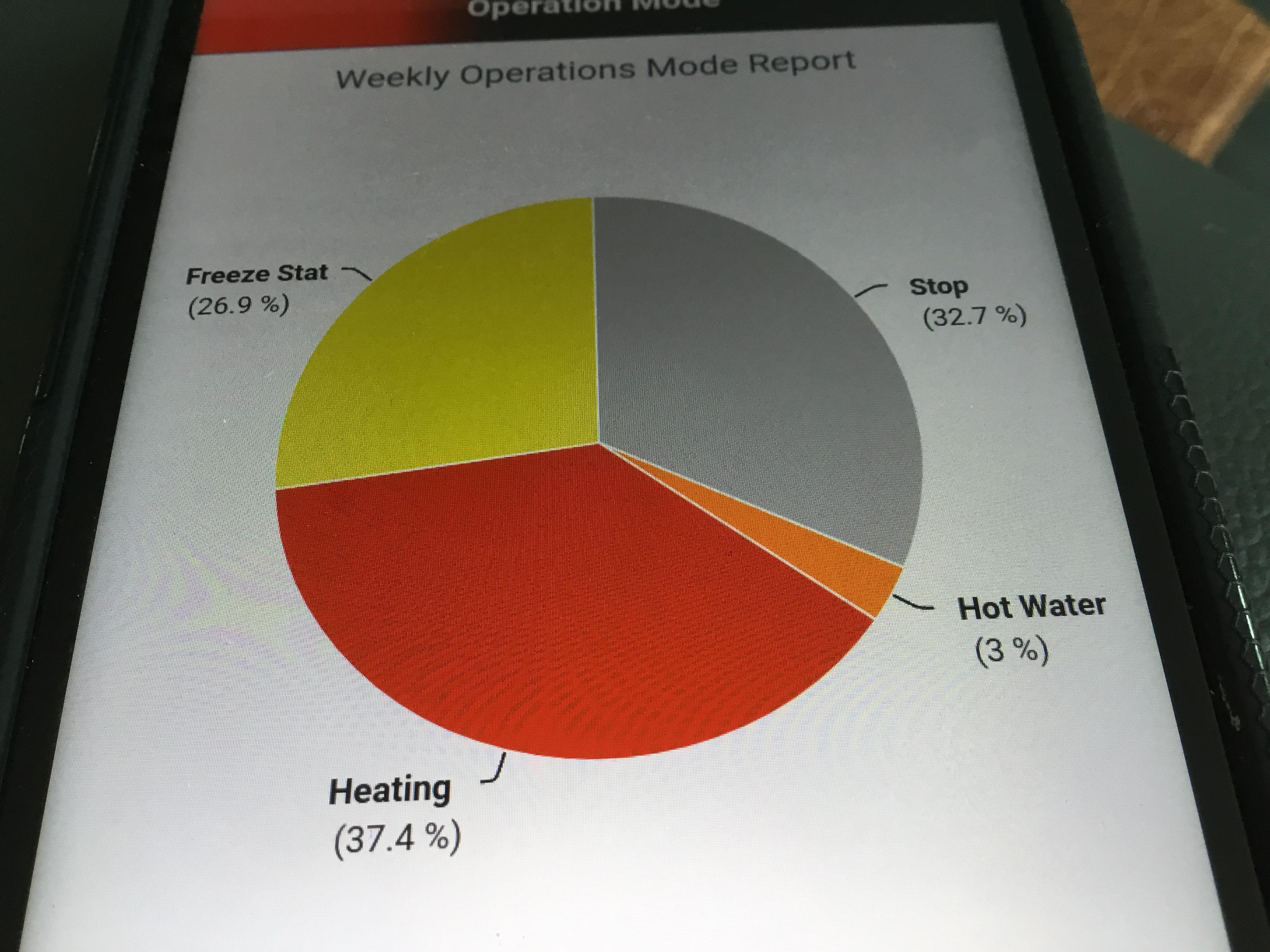

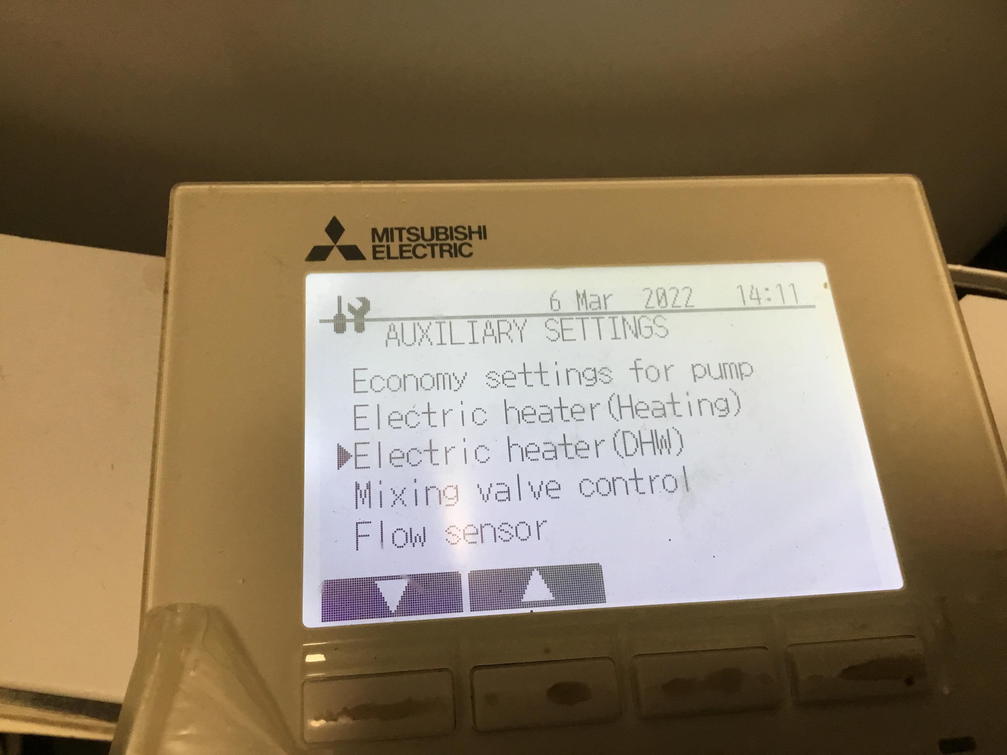

Hi I realise this is an old post but covers my problems
I am trying to turn on the Freeze stat mode on my ecodan 8.5kw asht latest version
when I go into auxiliary settings I can find no mention of freeze stat the system has glycol antifreeze but when I seen this pie chart I was concerned as how much it was running
any ideas how I can turn this off.    Adam

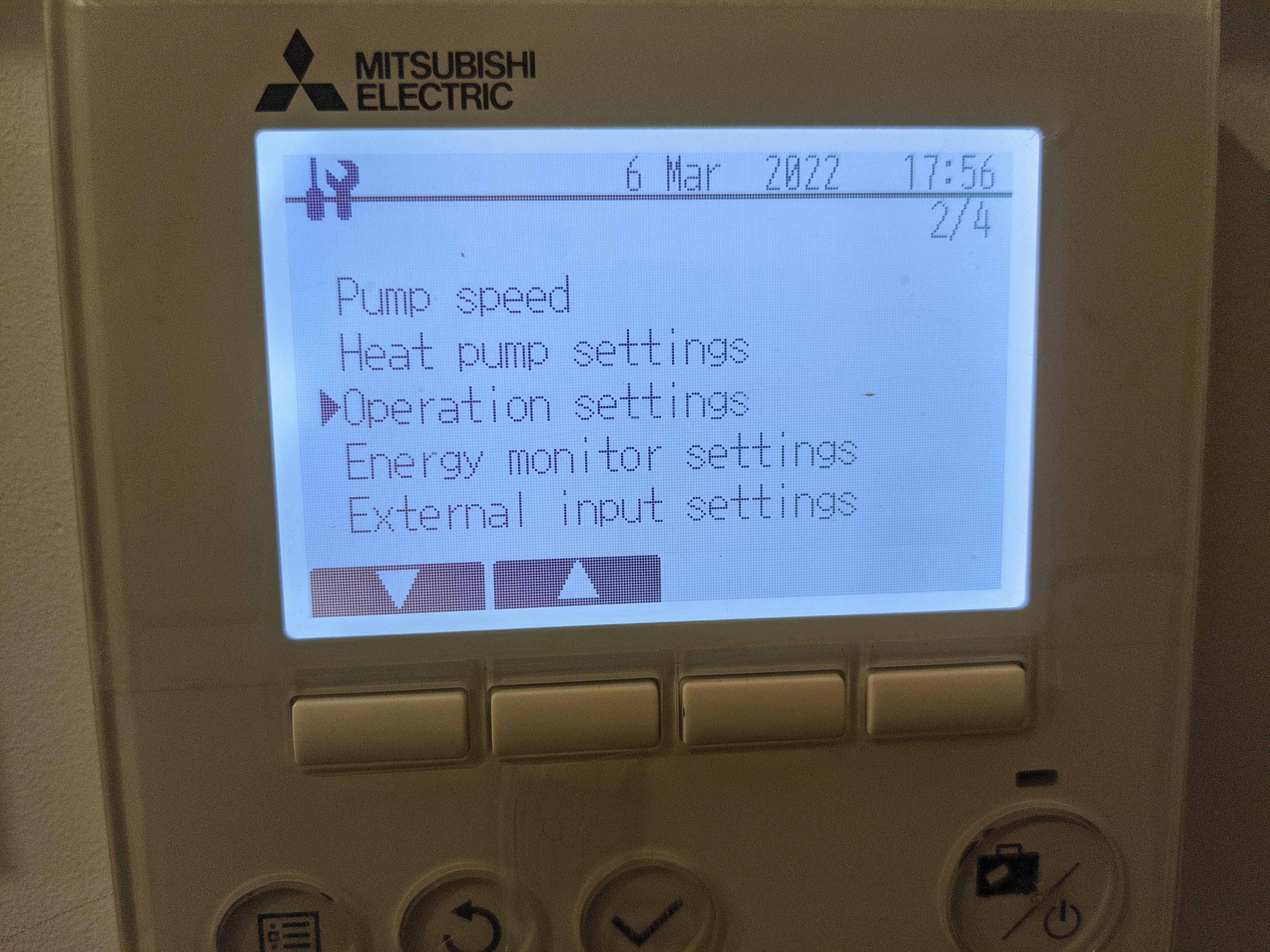

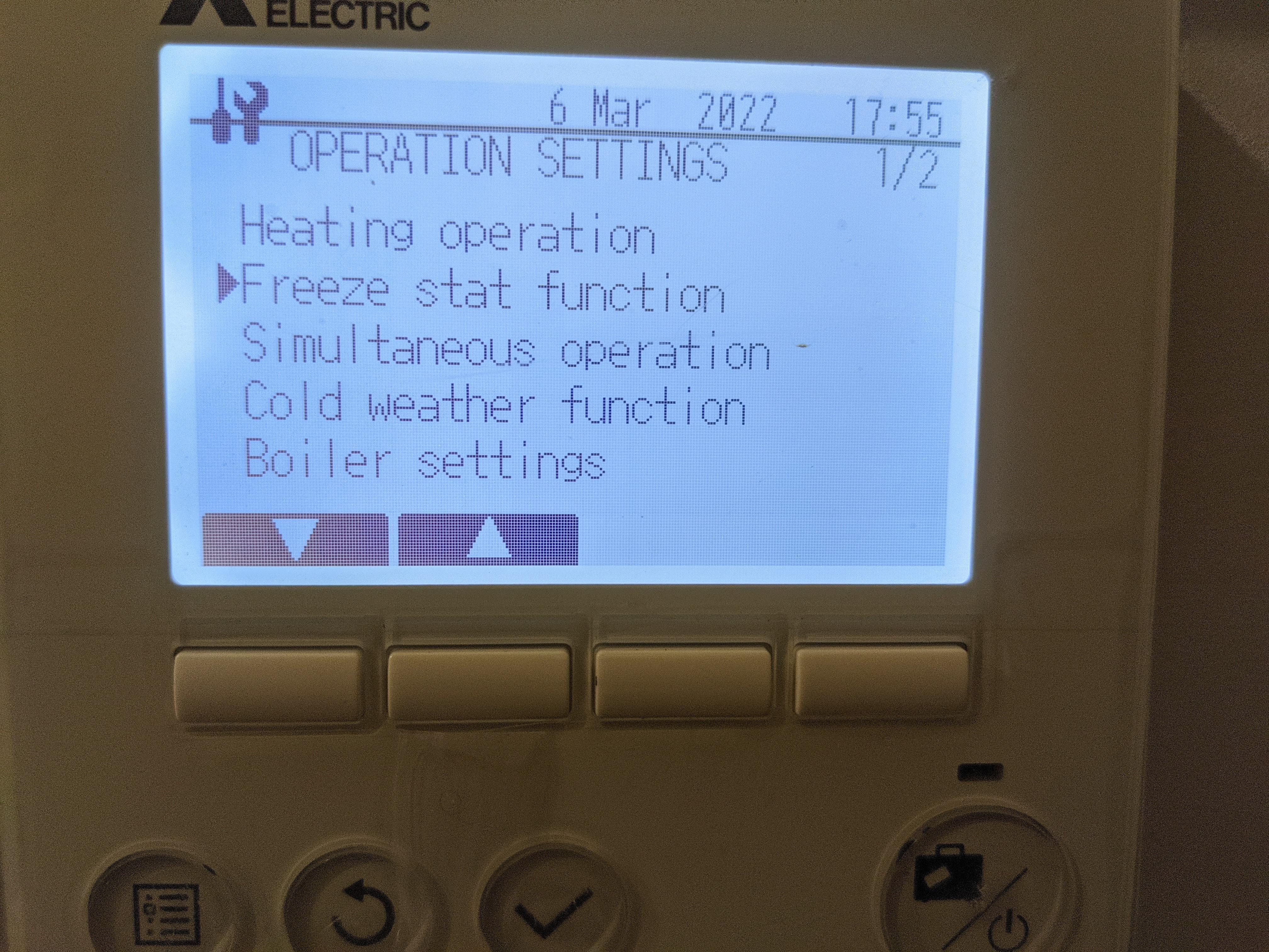

See my post above...its in the author settings within the control menu
