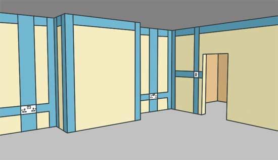

ProDave Posted January 6, 2021 Share Posted January 6, 2021 What is your WALL construction? No you CANNOT run cables behind skirting board. Look up "safe zones" which basically says cables can only be buried in walls horizontally or vertically from a switch or socket, and you can't have your sockets at skirting board height, Building regs set the minimum height of a socket. Link to comment Share on other sites More sharing options...
Gone West Posted January 6, 2021 Share Posted January 6, 2021 (edited) 6 minutes ago, ProDave said: Look up "safe zones" which basically says cables can only be buried in walls horizontally or vertically from a switch or socket Or horizontally at the top of a wall within 150mm of the ceiling. I think this is current (pun). Edited January 6, 2021 by PeterStarck 1 Link to comment Share on other sites More sharing options...

MortarThePoint Posted January 6, 2021 Author Share Posted January 6, 2021 2 hours ago, ProDave said: What is your WALL construction? No you CANNOT run cables behind skirting board. Look up "safe zones" which basically says cables can only be buried in walls horizontally or vertically from a switch or socket, and you can't have your sockets at skirting board height, Building regs set the minimum height of a socket. The walls are mostly 100mm blockwork. I will take a look, but I think Part A limits chasing to "Vertically not deeper than one third of the thickness, horizontally not more than one sixth the thickness of the wall" [1] That's plenty mind you for plastered in wires. 2 hours ago, PeterStarck said: Or horizontally at the top of a wall within 150mm of the ceiling. I think this is current (pun). Thanks for this. I think (??) you can use conductive conduit outside these safe zones and as such could have it in skirting board if the skirting board was deep enough to enclose conduit, or was itself conduit. Link to comment Share on other sites More sharing options...
